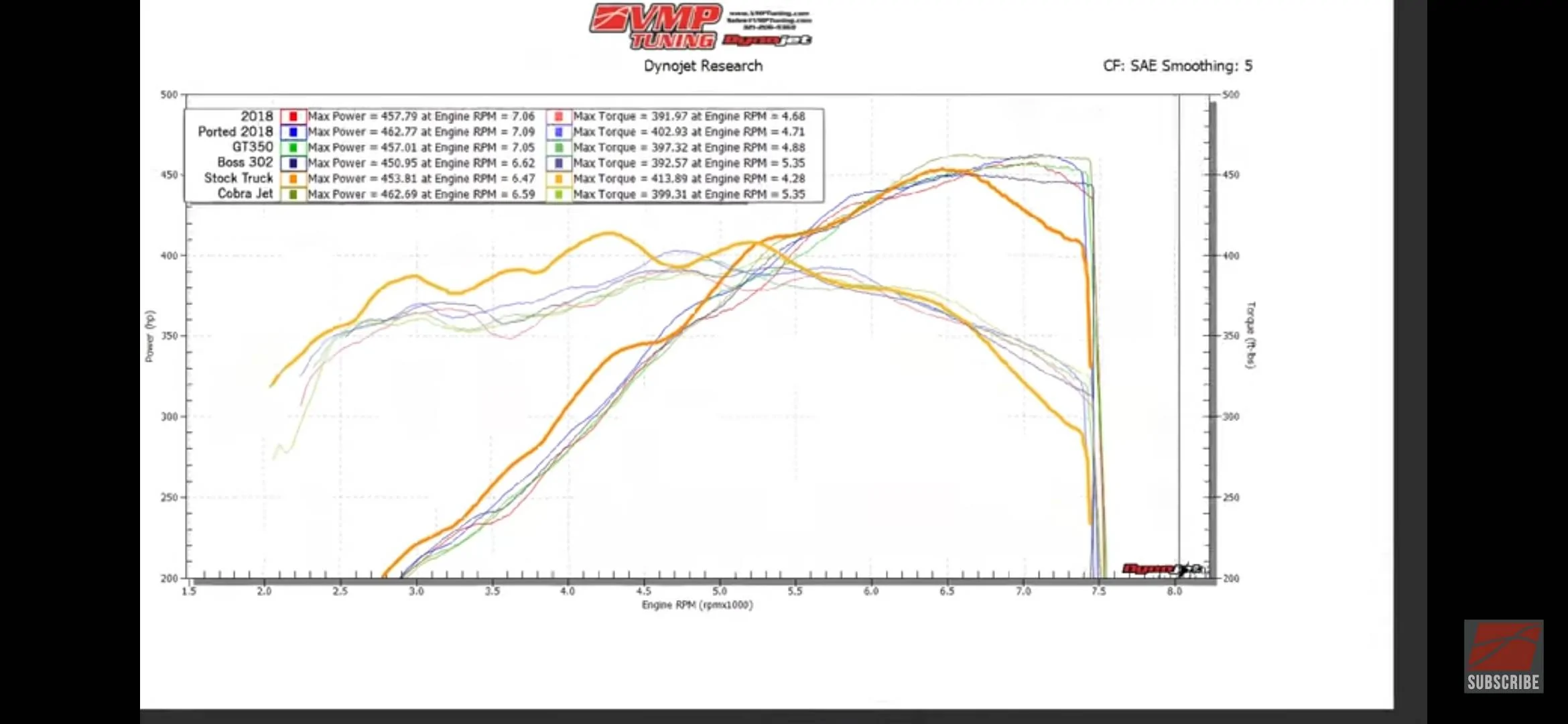

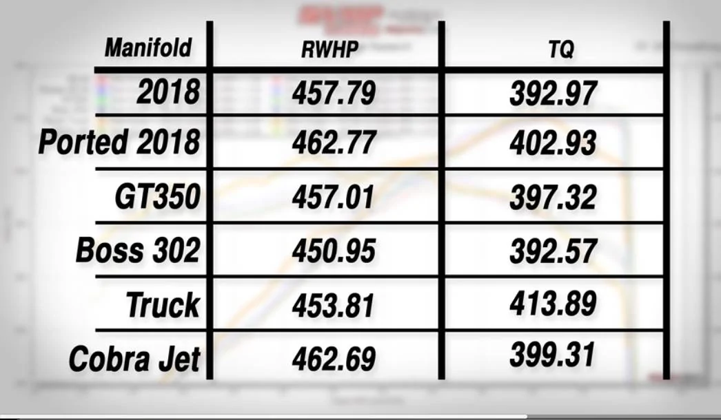

First I'm hearing of the 18 manifold being a pain to install. It's simple enough where anyone who is capable of swapping an intake is definitely capable of doing it.
I put an 18 on my gen 2 and it was easily done with the aid of a short tutorial I found online. There are parts that are a little hokey and add a small amount of time to the install, but it isn't difficult
If you're interested in the power curves of different manifolds I linked some testing below for various manifolds on the coyote
I would recommend a tune for any intake swap.

The biggest issue with the 18 manifold on a gen 2 is the need for a tune.
I believe VMP used a gen 2 truck manifold. The gen 3 runs out a few hundred more RPM

I think VMP used the gen2 truck manifold. The gen 3 pulls out to 6800

It pairs well with the 6R80. The gen 3 truck manifold.

Do you know who it is? Also do you know if that chart has the IMRC lockouts installed for the hp and tq?
It is very fun. Just don't post it here you will get bashed.:)
