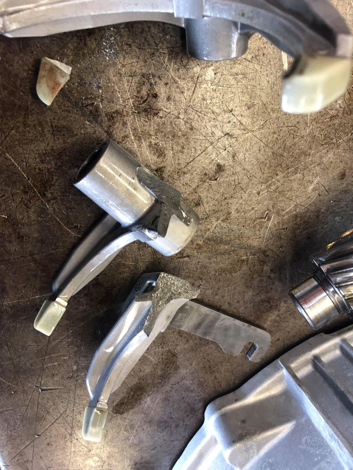

Updated Picture of 3/4 Shift fork.
Tech says it cracked over time, and eventually snapped off.

No indication at all, car drove perfectly fine, then let go during granny shifting a 2nd -> 3rd at 40.
No grinding, nothing, not even a peep when it let go.

In that mindset, sure. But, you have ZERO idea on the metrics. What I mean is this: is this consolidated to certain build dates? certain part lot? a supplier’s particular line? all 2018?
If there are 20-24 claims per build month (made up numbers), that’s 2.5-3.0 incidents per thousand vehicles... not a good figure in industry. Not terrible, but not good. And 500 claims? That’s 62 incidents per thousand vehicles a TERRIBLE number.
Tremec has been using cast aluminum shift forks for years.
This is not an issue of them being cast aluminium (the steel forks weren’t the best either) - it’s the design of the fork(s) by Ford/Getrag, Getrag’s casting process or an error at Getrag’s manufacturing facility.
A shift fork should not break like that, no matter how hard you are driving, using the clutch correctly - there should be little load on the shift forks using the clutch. Maybe power-shifting (NOT using the clutch), sure. The MT-82 even has internal shift stops.
OP appears to shift hard. In the previous dash cam video, the video shudders during the shift, indicating a shock to the car. Now whether that can bend or break a shift fork I have no idea. Either way, that can't be good for the dog teeth on the gears.
