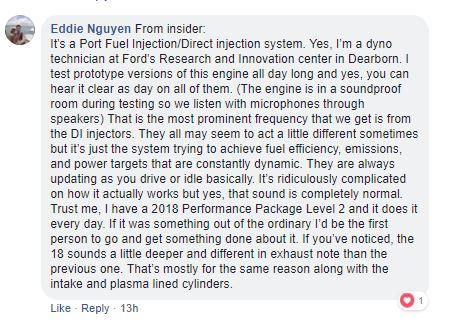

LOL are you serious? This tapping/ticking is completely normal for 2018+ GTs. Here is the response of a Ford dyno technician in the S550 Facebook group about the ticking sound.
