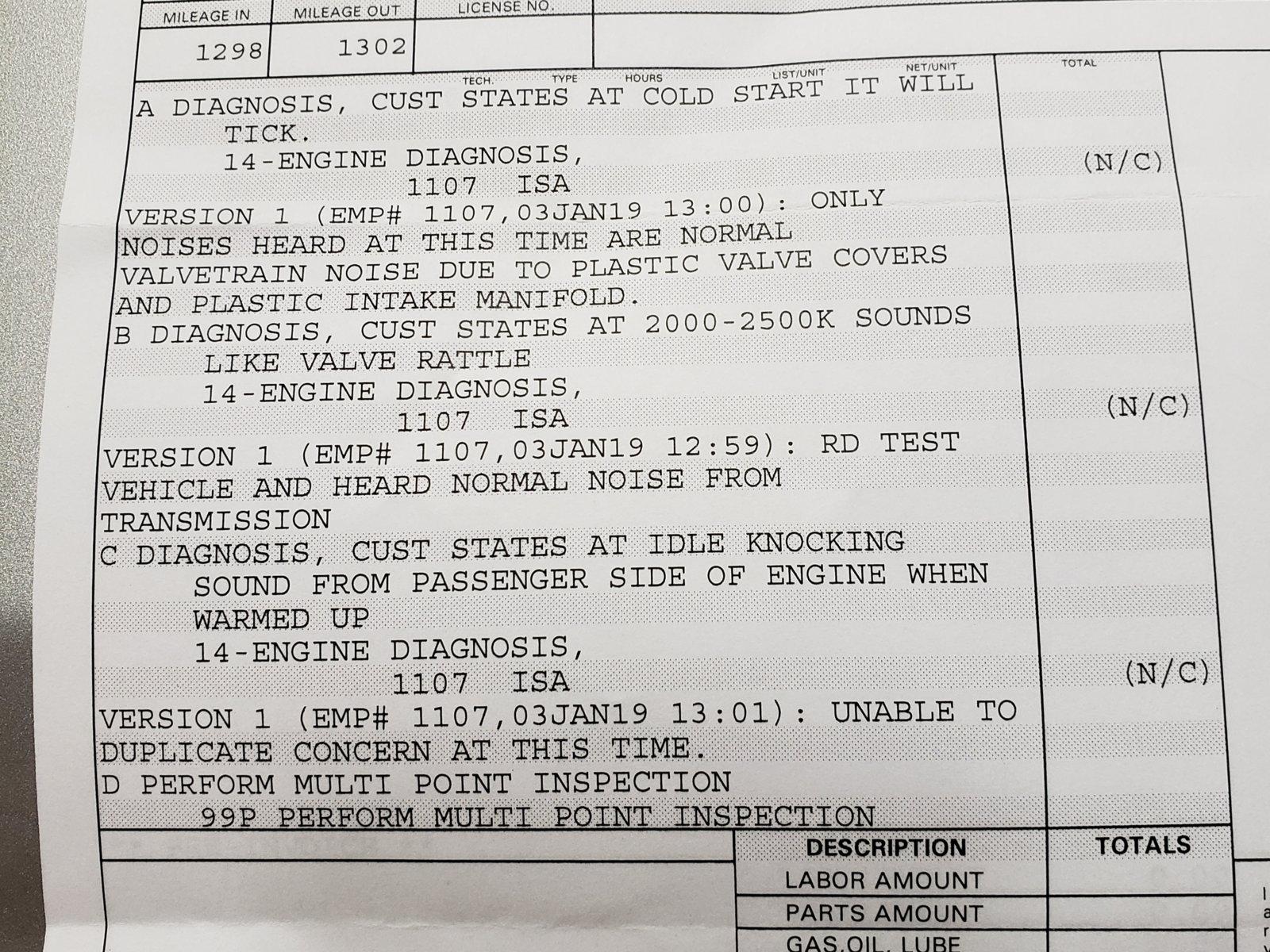

Well, had my appointment at the dealer this morning and it went about how I figured. I was able to duplicate all noises for the service writer and the tech. They listened and said it’s normal. They wouldn’t even write the car up as being seen for the issues. They said it’s normal and sent me on my way. Sigh.

Open a case with Ford customer service and tell them you want your engine torn into because of the noises the engine makes. That's what I did and I'm getting a new long block because I had camshaft damage.
I’m doing my own oil change next week, sending out an oil analyses, and cutting open the factory filter. Ive already contacted Ford about this. Since I have a US spec car in Germany they want me to work with the seller and the German dealership to try and resolve it before they get involved. What I find in the oil will determine how hard I push in the short term. Worst case I wait until I have the car back in the US a year from now and try again. We will see.
I'm right there with you man. I got the documentation this time. Previous dealer wouldn't write mine up either. Im getting an oil change in a couple of weeks and I'll complain again. They'll eventually get tired of hearing me. Seems that's the only way dealers around here work in my area. I'll keep getting it documented so when she blows I can at least say I have numerous complaints about the noises.
I have another appointment scheduled in two weeks at the same place. I’ll just keep going back until the car stays and they open it up.
I love the car. Just want it to be right, and it’s not right now.

I couldn't agree more... I absolutely love my GT and I dont want a different vehicle. I just want what I have to be right as well. But I'm gonna keep on driving the car I love. But I'm also gonna keep on them about the noise. Keep us up to date on what they tell ya.
