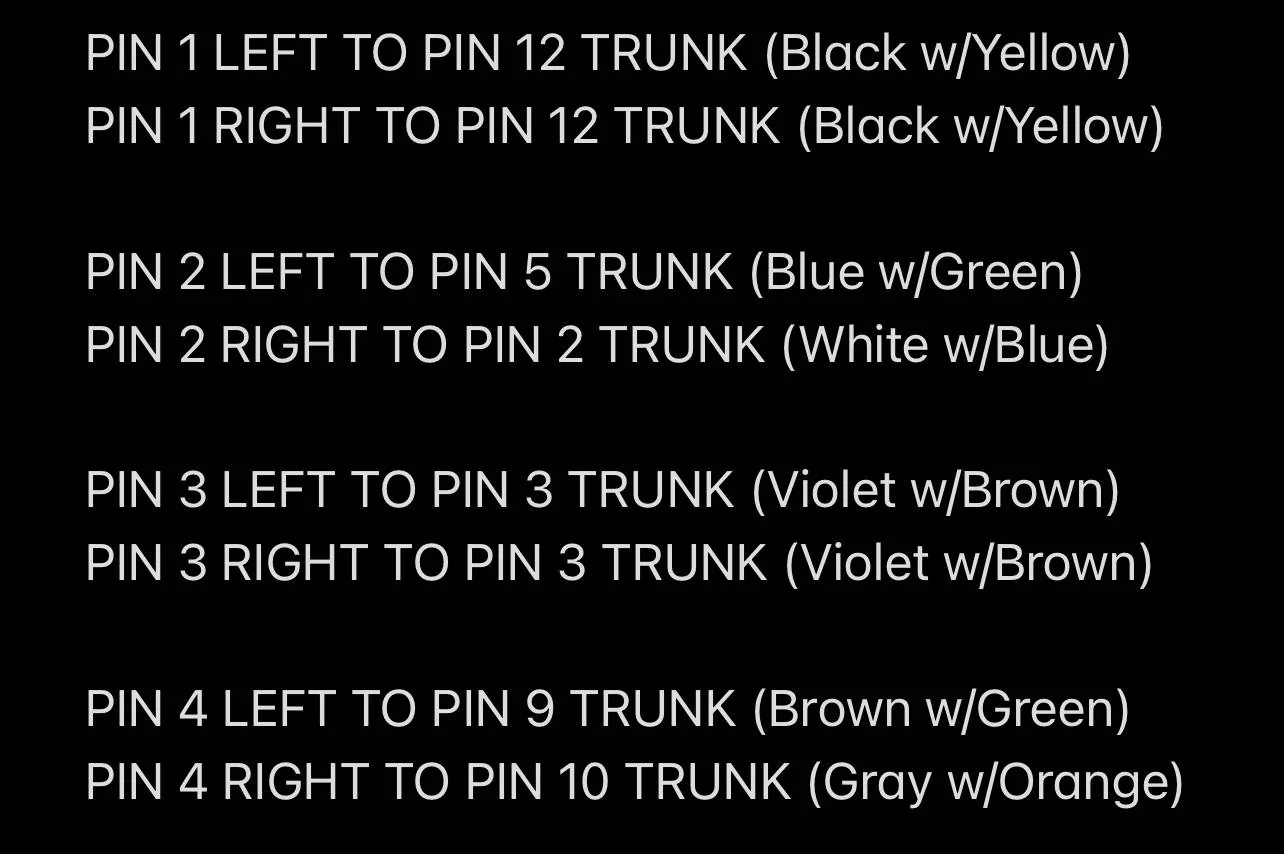

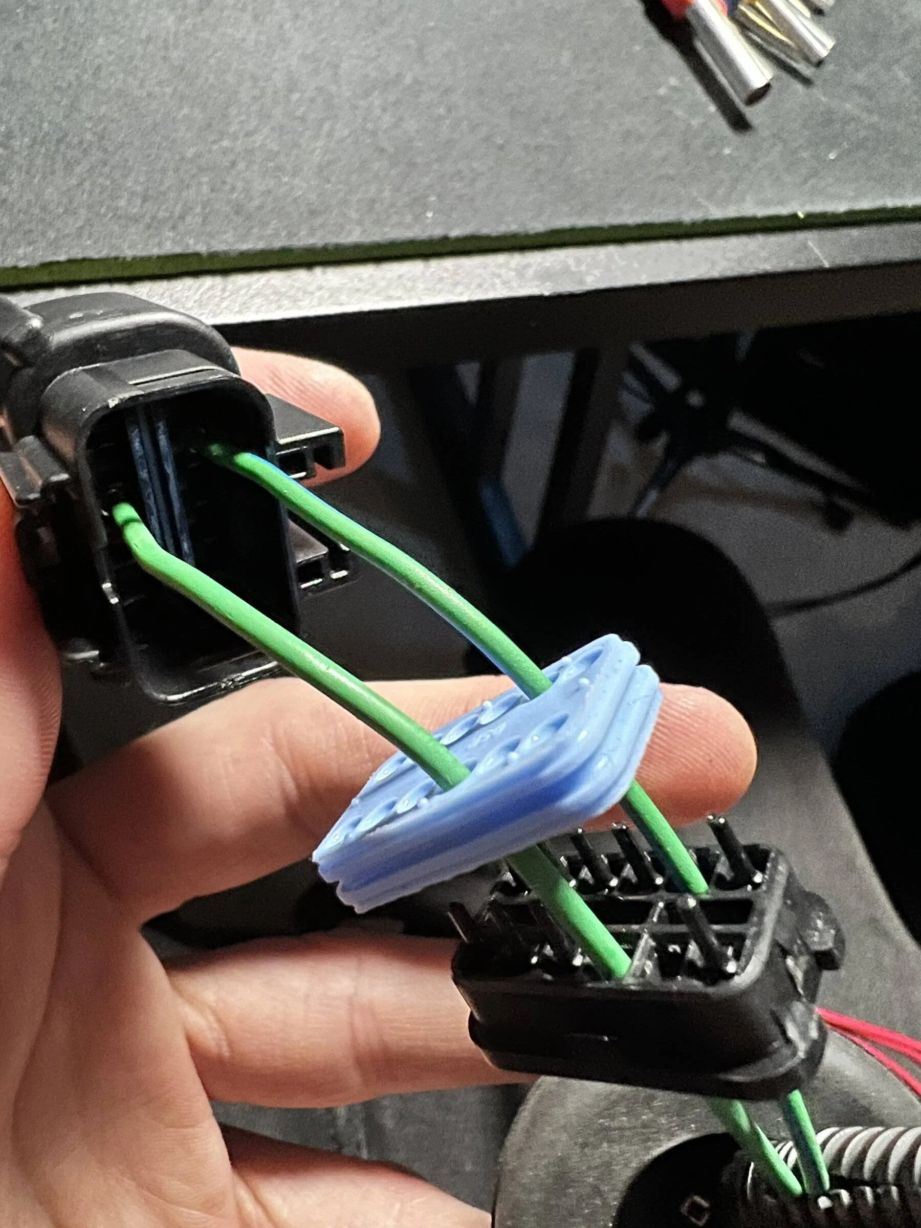

Can confirm this is the correct wiring from actuators to the trunk harness for a 2022. You’ll need to solder or connect pins 1&3 from both sides into a single pin to connect to the trunk connector. It’s much easier to push the pins in if you disconnect the harness from the Evap under the car and from the trunk connector.
The molex connector in the trunk also has pins blocking the rear cavity for each pin. You’ll need to snap these off to be able to push the molex pins into place correctly. (See image)

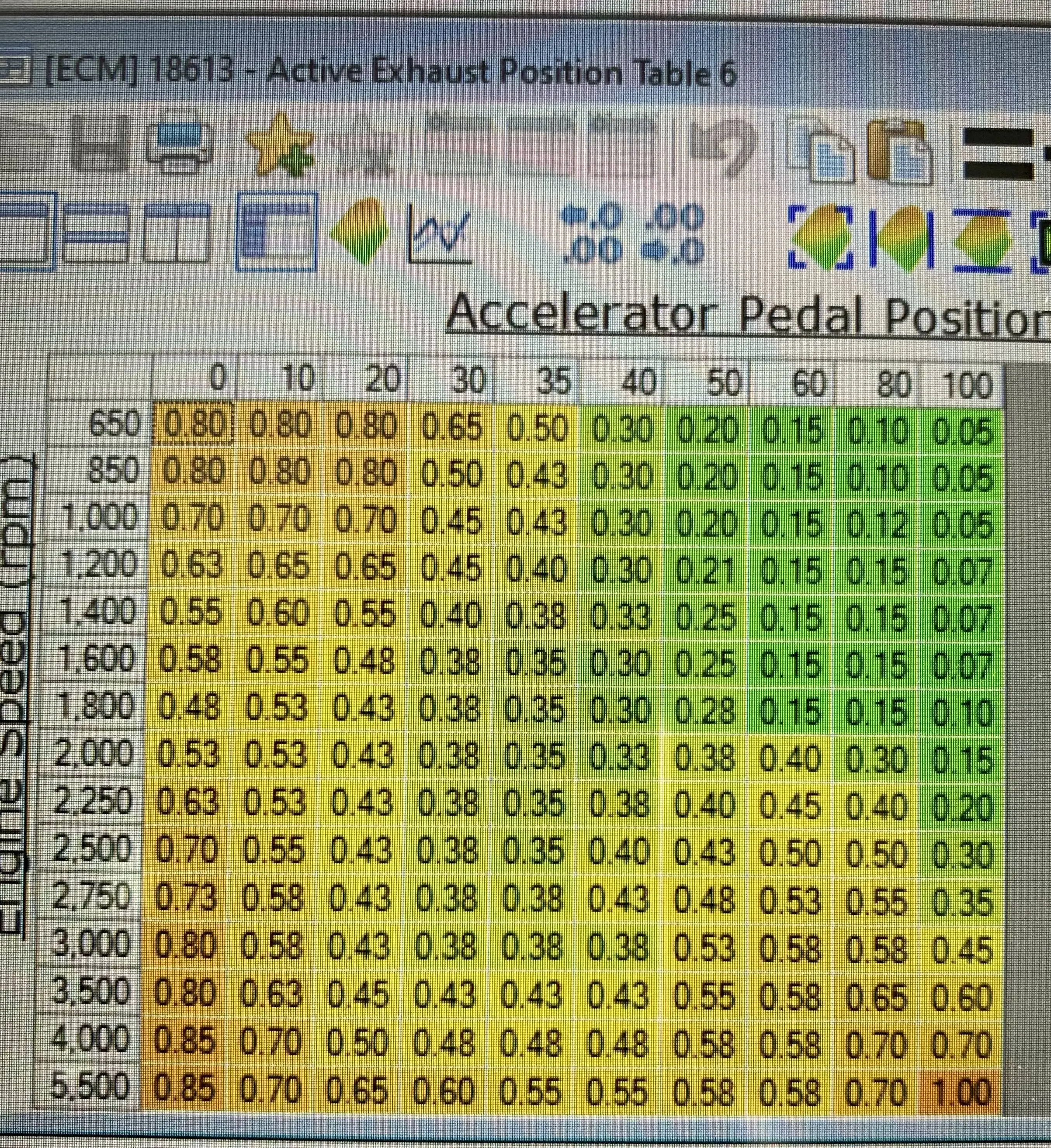

Hey man just curious if you or anyone knows how to program the parameters for the valves in the active valve system. Basically I activated the active exhaust on my car after installing everything, but it only functions as either open or close. So quiet = closed and normal, sport, and track=wide open . It does not do 1/4 open or half open or any of that on the valve.
At idle the system will do exactly what you describe, only modulates the valves when under load.

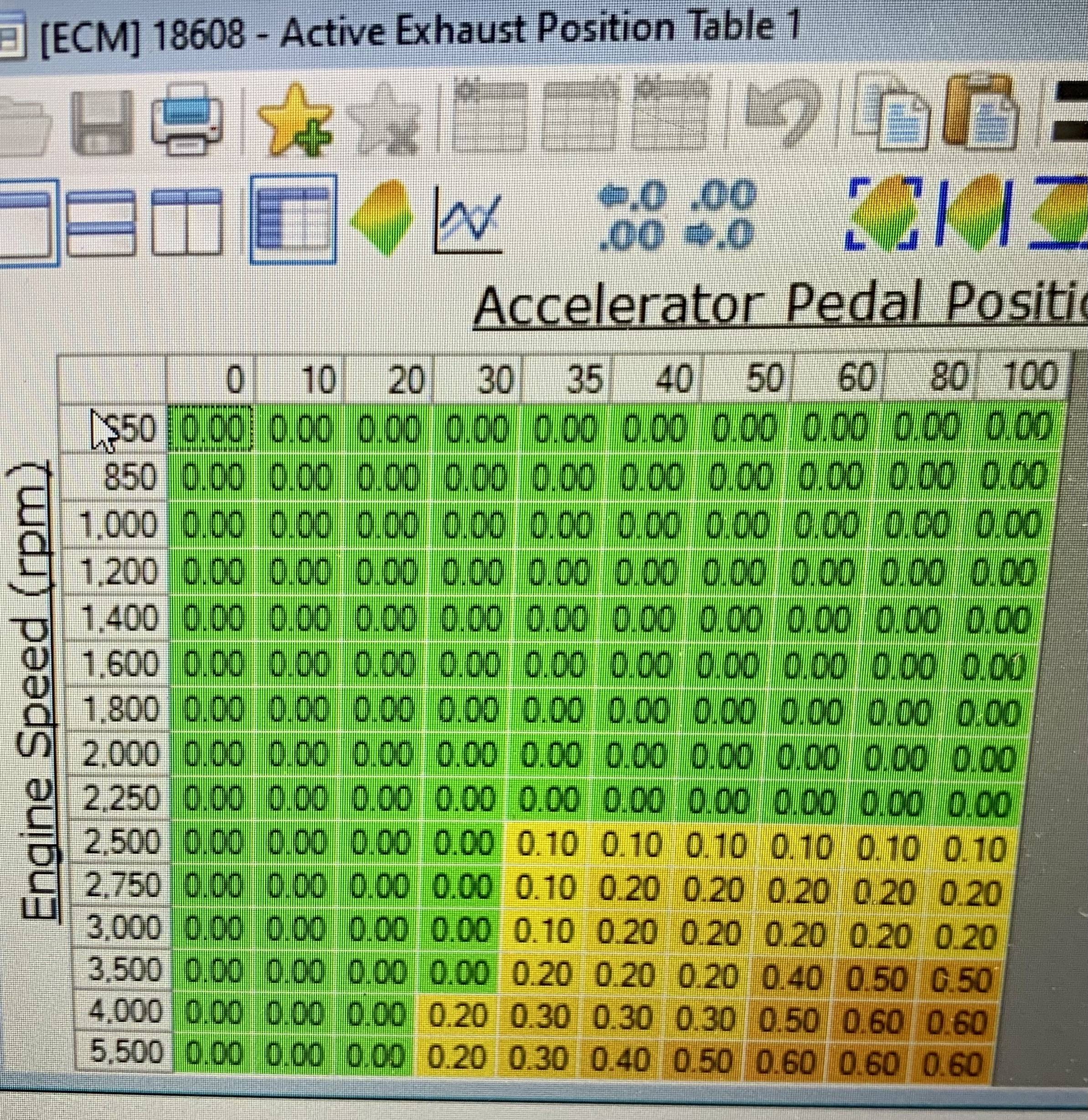

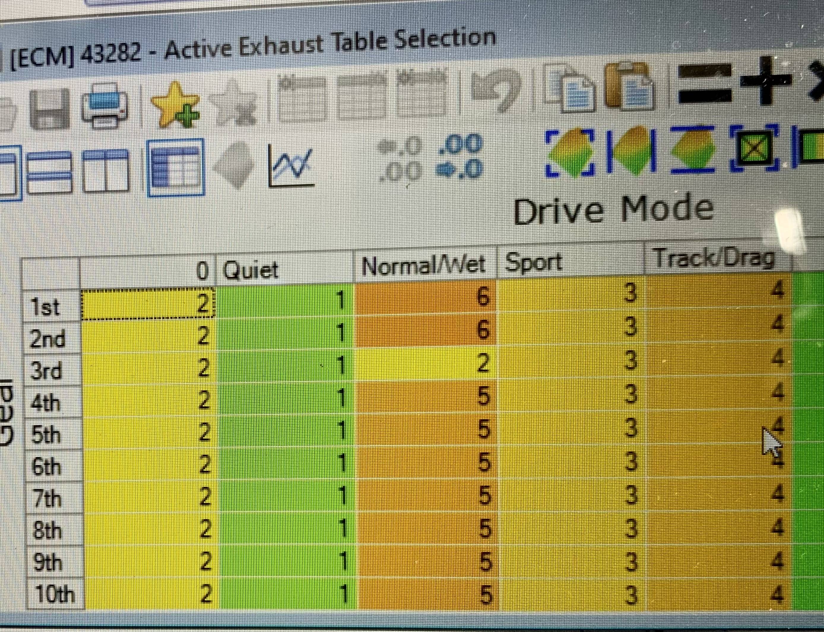

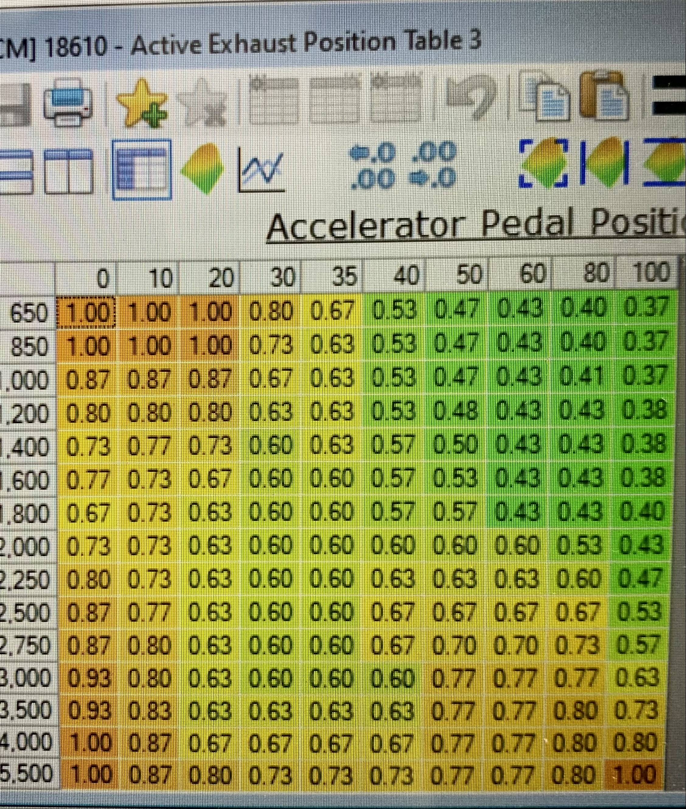

Drive Mode look-up table
Quiet Mode
Sport mode, note how valve is wide open at idle (650-850 rpm and throttle closed). As RPM rises and throttle opens the valve closes.
Normal & Snow/Wet mode when in 1st or 2nd gear. I stand corrected, valve is almost all the way open at idle but you get the idea.
