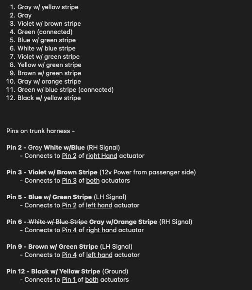

I believe this matches up with everything I've seen so far.

Hi,
On my 2021:
To Pin2 on RH wasn't Gray cable but White with blue from trunk harness
To Pin 4 on RH actuator wasn't White with blue cable from trunk harness but Gray with Orange stripe from trunk harness
These two misstakes cause that digital cluster gives me error exhaust mode selection not available
MrBD1348
Dec 12, 2021
428
441
Chicago, IL.
'22 GT MT-82
Hi,
On my 2021:

Yes, exactly.
and those changes you made fixed the problem or are you still experiencing it? I just got the catback installed on Saturday so now i'm just sitting down with the wiring
AndreiVHT
New Member
May 21, 2022
Czech republic
Mustang GT 6G (2021)
This changes solved all my problems and exhaust works like original. Slelect mode from digital cluster, Good neighbor, exhaust is in my mode etc.
So does this seem correct for 2021+?
