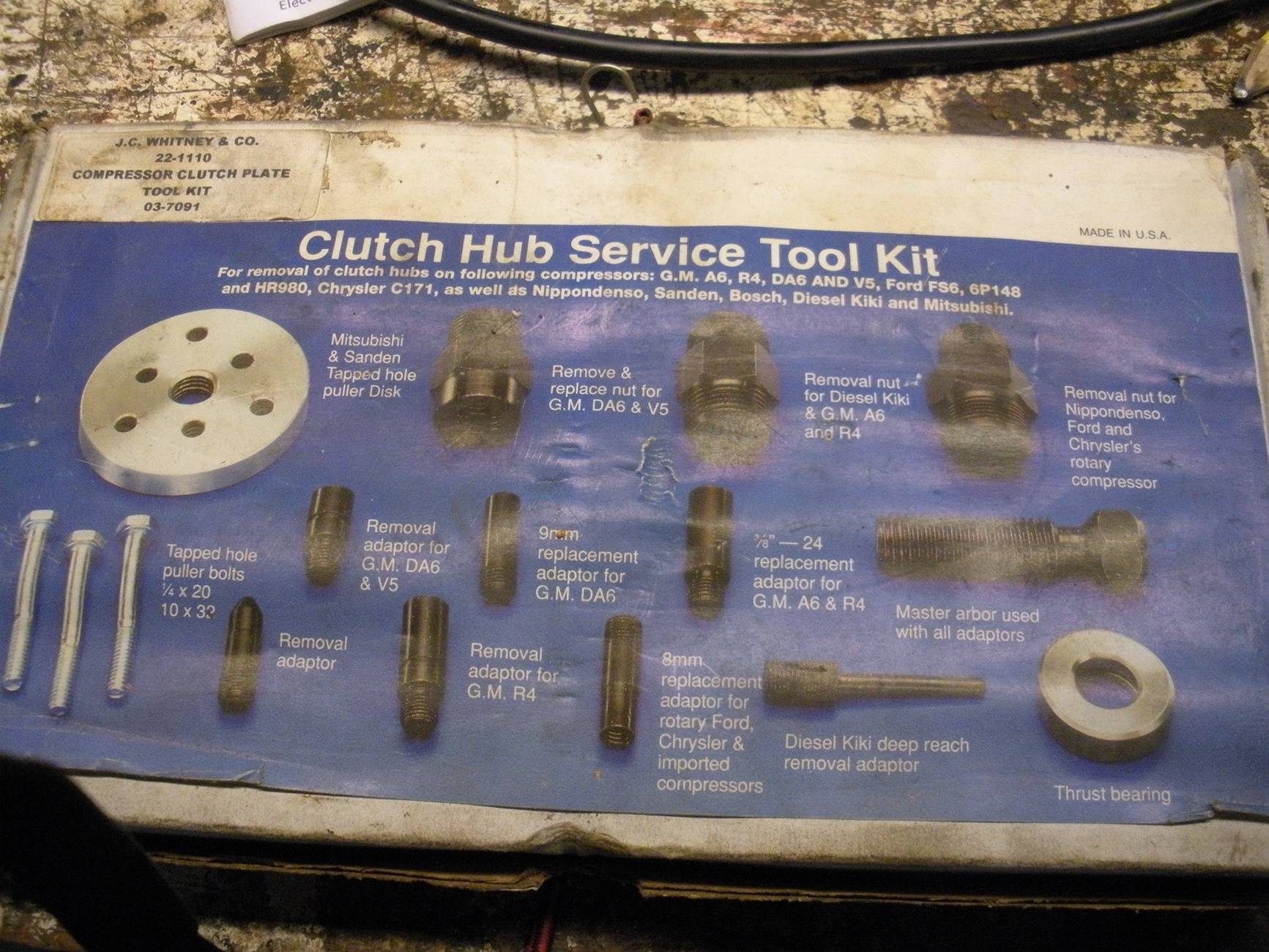

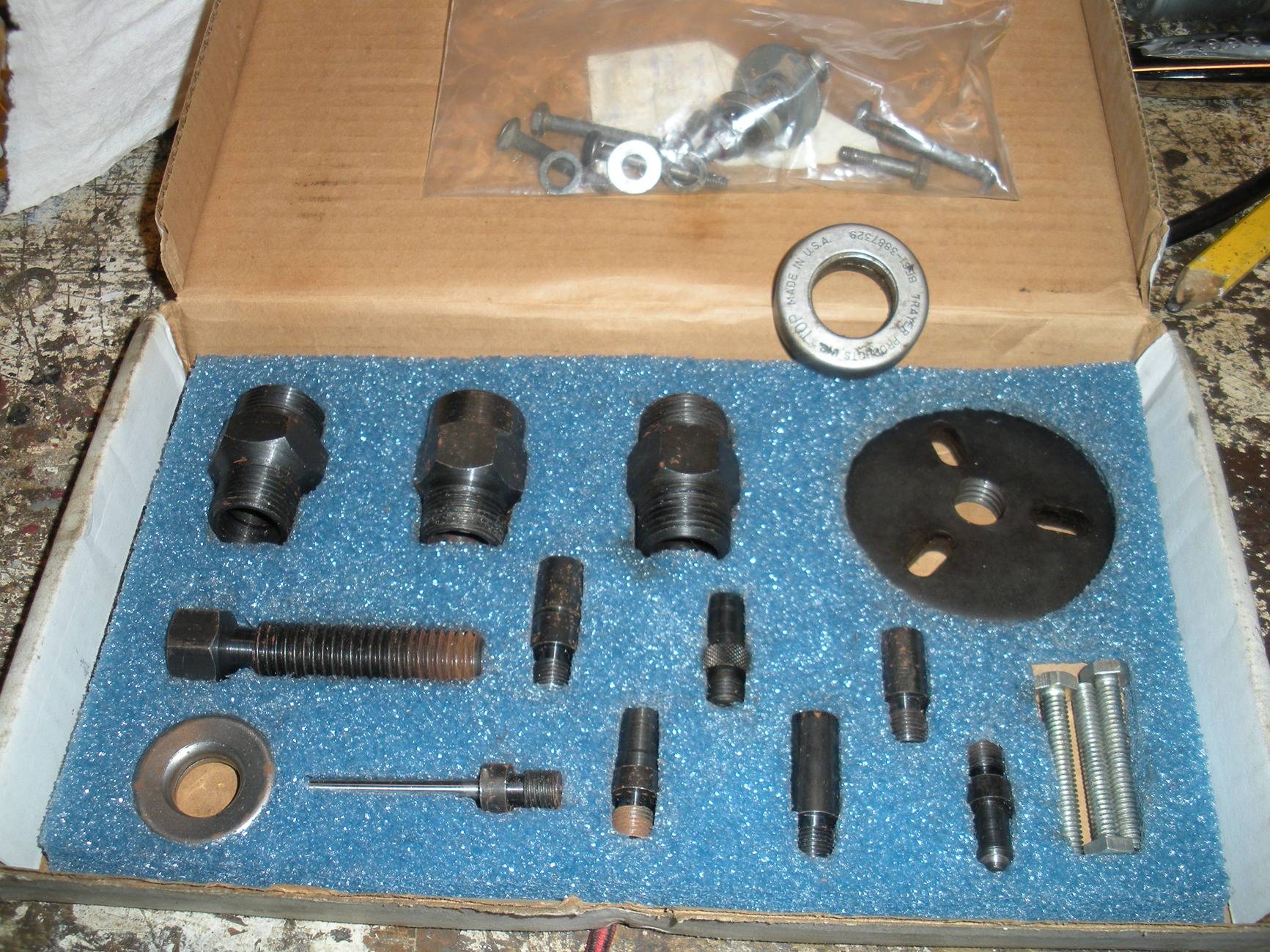

Hello; This is the tool I bought back around 1999-2000. It is from JC Whitney &Co 22-1110 compressor clutch plate tool kit 03-7091. The box show install & removal for Ford rotary compressors.
