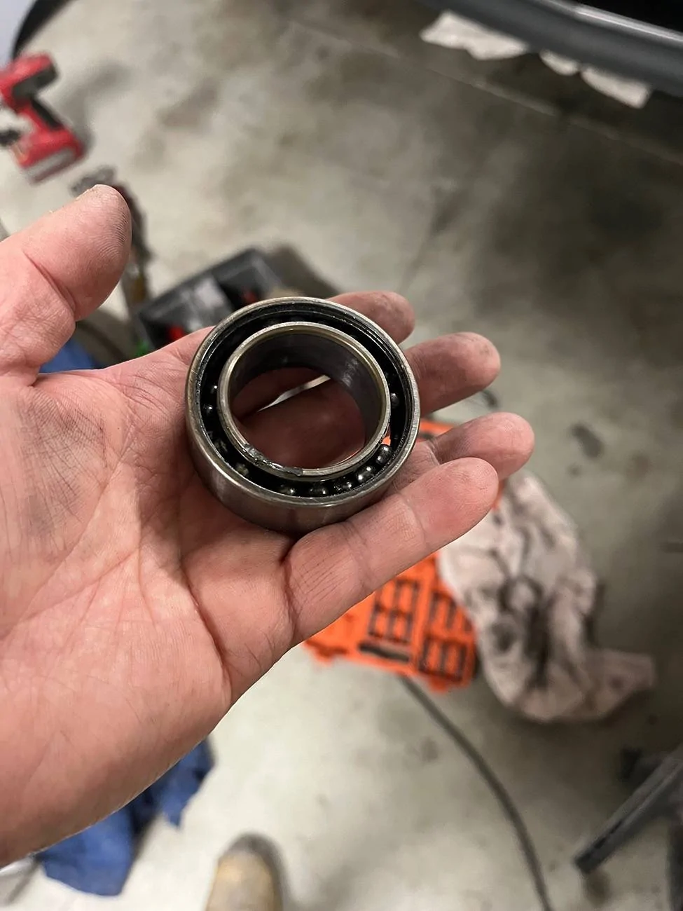

Bought the $30 puller tool, modified the puller tool, removed the bearing, $40 in parts on the way (bearing and clutch plate)… fingers crossed.

Hi sk47, Got the new bearing and AC clutch installed, bought a dumb stretch belt tool that was worthless, ended up just using my hand to hold it against the pulley as I wrenched the crank bolt. Everything lines up and everything spins. But haven't made it to a shop to get the system recharged. It's either going to work or the compressor is bad and all of this was for nothing. But like you said, better to attempt to fix it than just take it to a shop or replace everything from the start. I'm really good at threading my accessory belt now (ha), plus I took the opportunity to fix my split belly pan with fiberglass. Another cheap fix that kept the big piece of plastic out of the landfill.

Ok, final post on the outcome. Although I was able to replace the bearing and clutch, the compressor was shot. So the gratification I got from "fixing" the issue, was short lived. But I bought a cheap compressor and valve, swapped them out, then got the system recharged by a Yelp reviewed mechanic shop, and the system is running cold now. A bit of a pain in the ass, but still much less than having it all done by a shop. <$300 for parts (including the parts I threw away), $150 for the recharge and a couple weekends vs $1k+. Have no fear of digging into an issue, just go for it.

Yes that would have been easier, but I was determined to fix that squealing bearing. haha Considered the Motorcraft part, but the $450 and the fact that the car is pissing me off right now, made me go cheap.

I've learned that when you have a squealing or grinding bearing, it probably indicates wear that has caused seal damage as well. So when it gets to that point, I now replace sealing surfaces as well as the bearings. Not sure how much work that would have been for you @shiparino, but regardless, sometimes it can be worth a try to do as you did.
