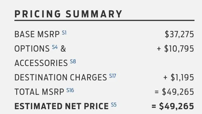

Agreed but look at the cost of a 22‘ with just 301a, PP & MR.
Yep. But used car values are so high, the OP would get strong money for his trade in.

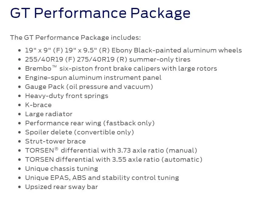

Curious as mine is a base also
How it says “unique chassis , tuning etc.” what’s that referring to?
Bikeman315
Apr 12, 2015
583
16,194
21,915
Myrtle Beach, SC
Ira
It's just that. Special chassis tuning for the package. Ford doesn't give out specifics. Even if you add all the factory parts it will still not be a PP package suspension. That said you can certainly do you own suspension (depending on your needs) to meet or even exceed the PP.

Nice , hmm what do think a ballpark cost ? Might be easier to sell and purchase a pp1 stang . What about magna ride I hear talked about how do you know if a used stang has this option
There is also some changes in the strategies with the stability control, EPAS and the ABS vs. a base Mustang.

The ford performance street handling pack is the suspension on the pp1, but the springs on the kit are better than what came on the car. I'm in the same boat converting my 17 gt/cs to a performance pack car. For me though, spending another 50k on a new car when I can just spend a few thousand upgrading what I have wasn't worth it. Alot of people on this forum bitch about the street handling pack but it's a good setup. Especially if you have low profile tires, live in an area with crappy roads, and don't track your car. The street pack is more than adequate for a daily driver, and you can get it from late model restoration for 1k.
