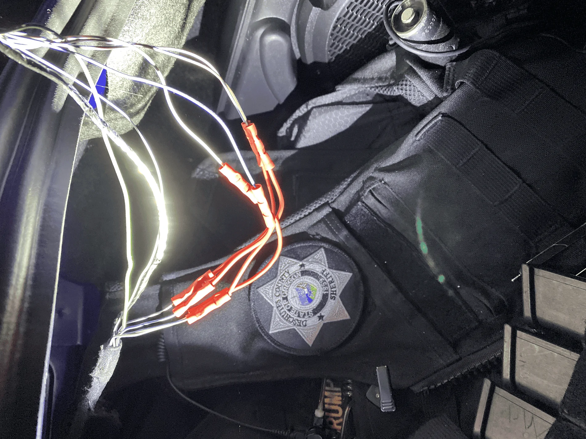

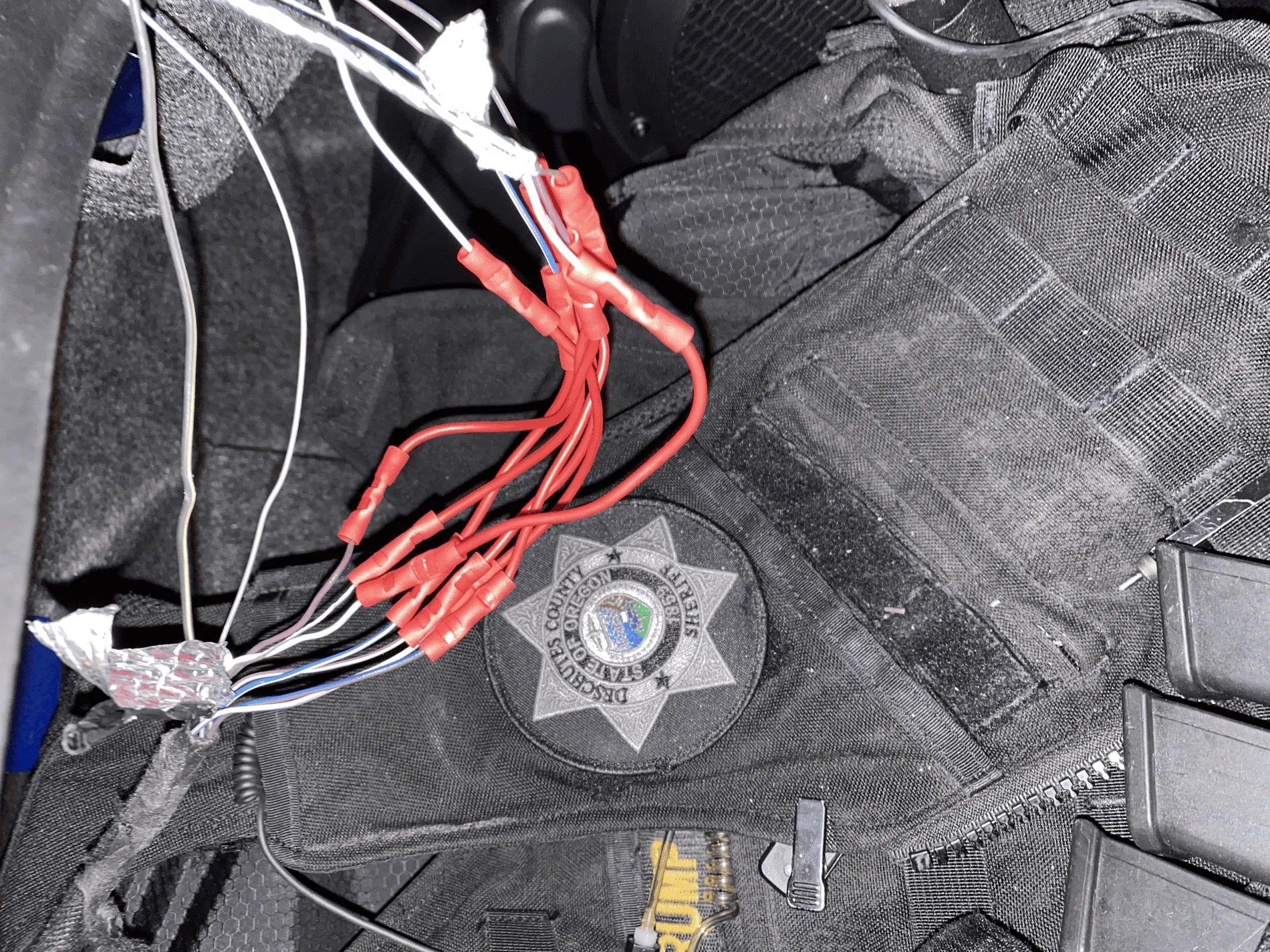

My camera was doing the samething. The wires in the trunk were about 90% cut in half. No idea how anything worked. I added about 2'' of wire and all works fine now.
