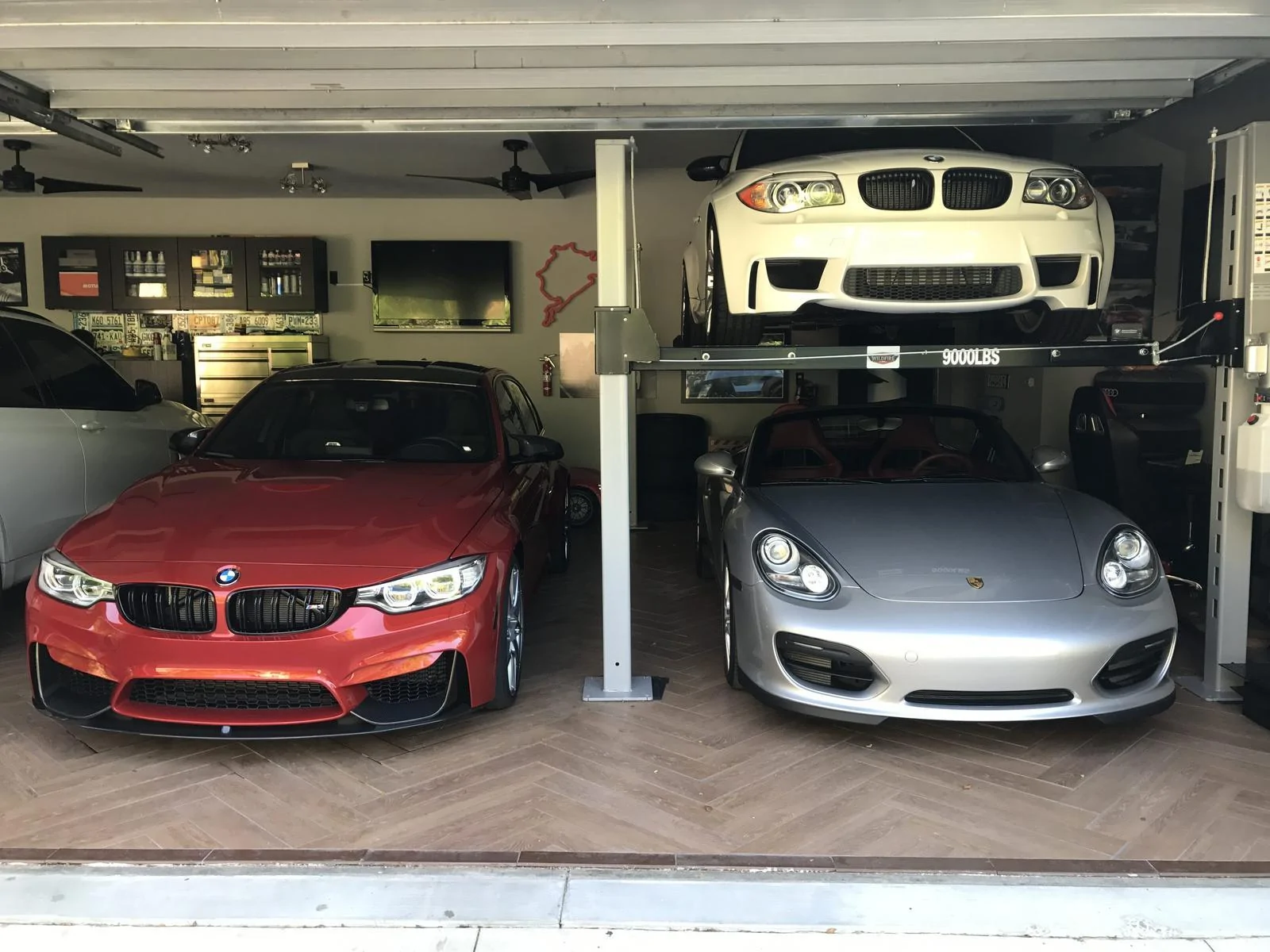

Whether you go with a two or four post lift, I highly recommend Bendpak - their stuff is very high quality, but priced so that it's affordable for the home hobbyist.
I have the HD-9W, which is a four post, 9000 lb capacity, with extra width.
Bend Pack for sure, very nice lifts. Love your garage and cars as well.

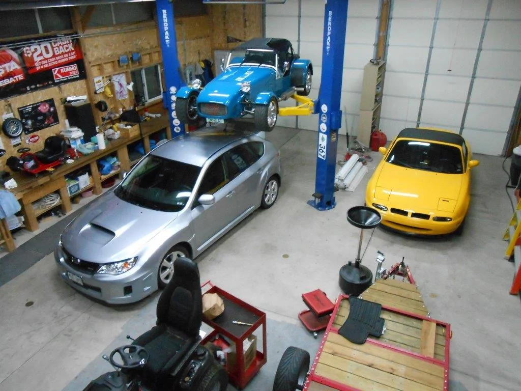

I have a Bendpak 10,000 lb asymmetrical lift in my shop. Only hassle is the GT350 is so low the front arms will not go under it. I have to drive the front wheels up on a 2" ramp to get them under the car. They go under my lowered Miata with no problem.
This is an old picture, all the cars shown have been sold.
#GarageGoals
A friend has a car like the one on the lift. Can’t remember, is it a Lotus or an Alpa Romeo????

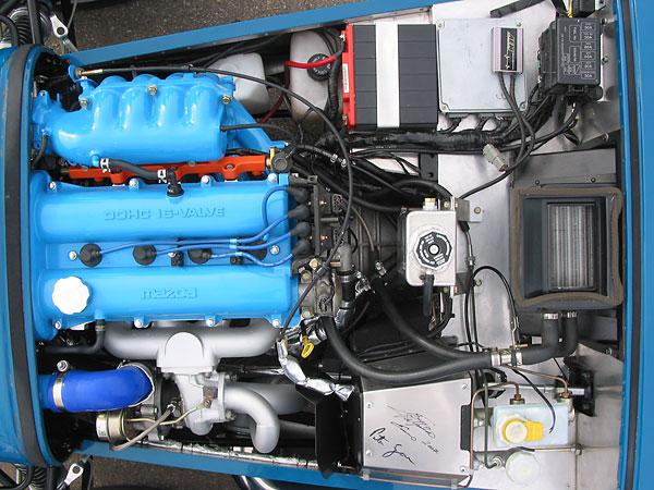

Its a 2004 Caterham 7 SV, the only Lotus 7 clone authorized by Lotus when they sold the rights, parts and fixtures to Caterham in 1973.
When I built it I put in an 1,800cc turbocharged Miata engine and transmission instead of the Ford Zetec and T5 transmission the kit was designed for. It weighed 1,340lb and dyno'd 301 HP at the rear wheels.
