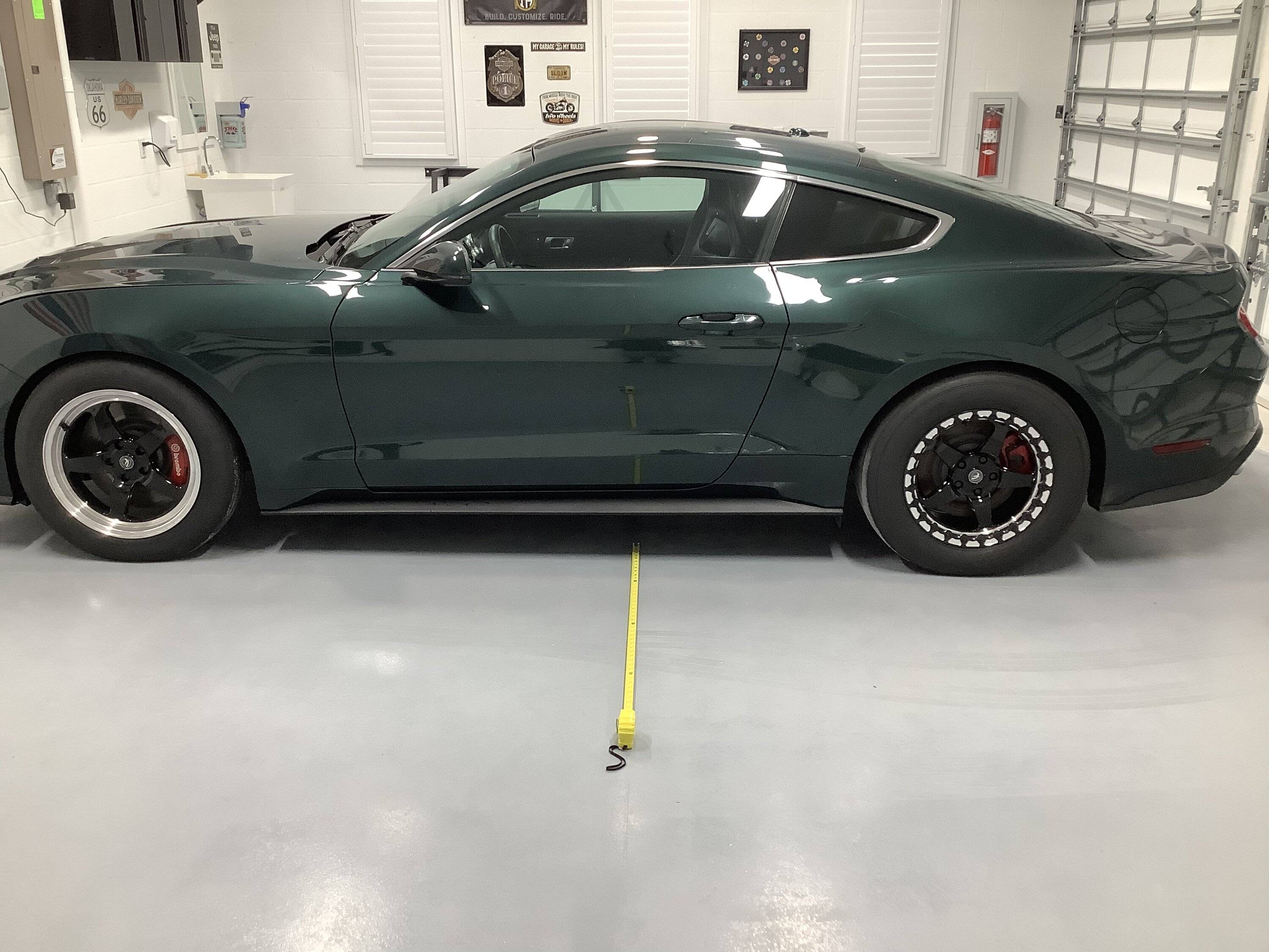

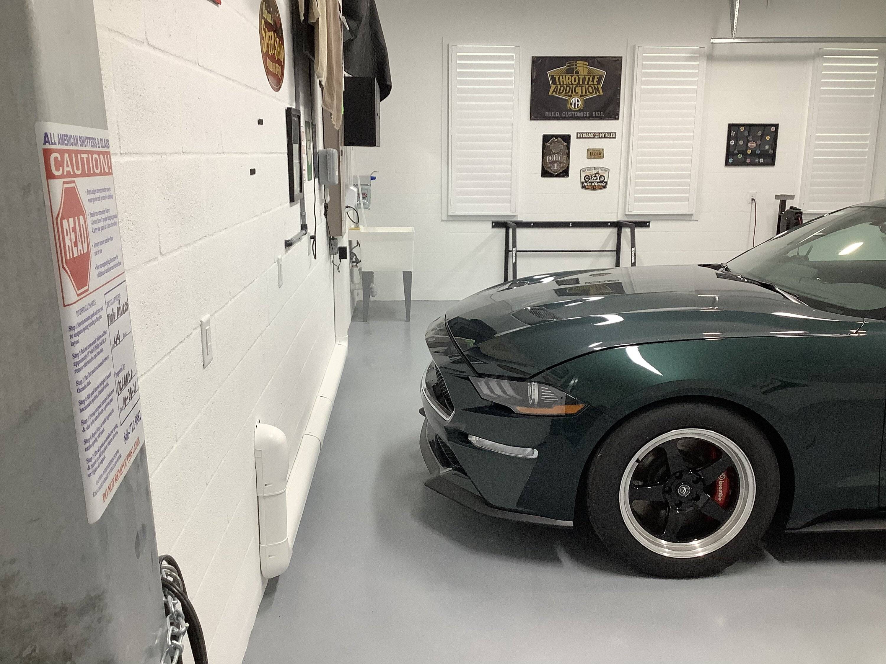

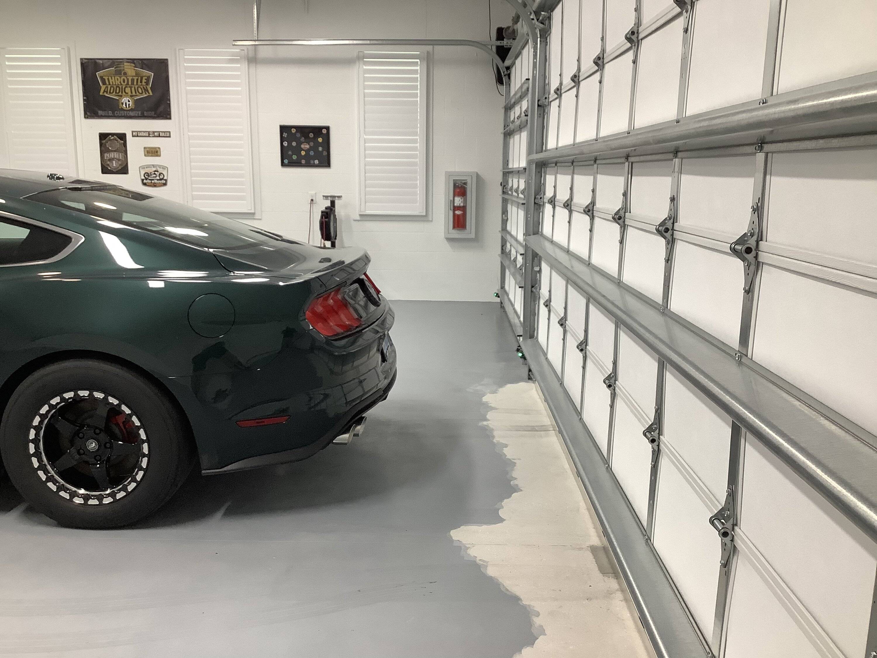

I have a 2 post lift being delivered in about 10 days. I’ve researched the instructions on my lift, as well as many others and I see that it is advised to stay 6” away from any cracks, expansion or control joints. I will adhere to this if it’s an absolute must for safety, but was wondering how big of a deal it would be to drill one hole for each column right on a control joint? I ask this because it would allow me to position the lift in a spot tat will give me more clearance in front of the car when it’s on the lift. As it stands right now, if I stay 6” away from any joints, I will only have about 13” of clearance from the nearest object when the car is on the ground between the lift towers or 9” when the car is parked between them. I should note that all remaining holes would be 6” away from any joints. Any advice drawn from personal experiences would be greatly appreciated. Here are pics to show how much clearance will be in the front and rear of the car If I stay 6” away from all joints. Note: The yellow tape measure is lying on top of the control joint that I am inquiring about installing a single bolt bolt for each tower. Thanks

I personally would not take any chances. I would call and discuss this with the manufacturer of your lift......
Good advice! I will ask the delivery guys (who are also the installers for Champion Auto Lift), to see what they recommend. I knew I was going to add a lift before we build our house a year ago, but I wish I had thought ahead to have the control joint made at least 12” to the right of the tape measure for optimum positioning. I’m hoping they say I can safely cheat it for that one bolt on each tower, but if not, I will do what is best in order to be safe. Thanks

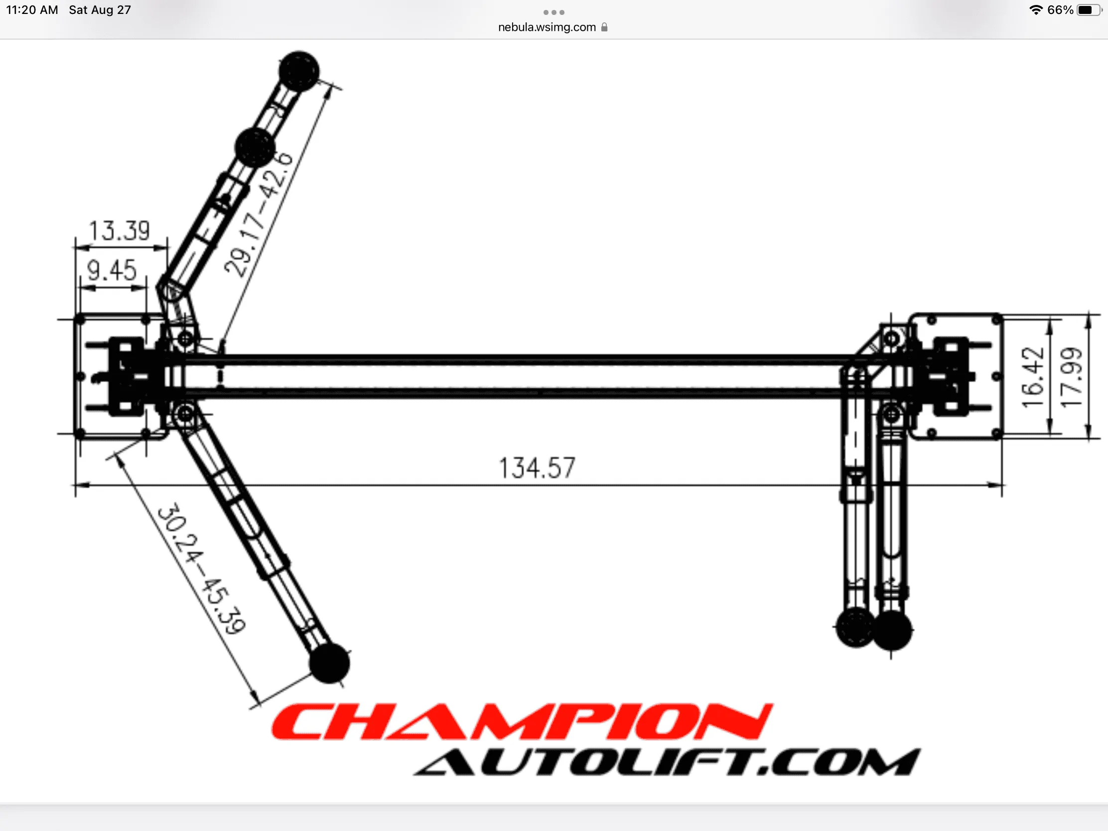

Thanks! I’m chewing on that food for thought.. I won’t know for certain on the thickness until I drill. I’m praying that it is the appropriate thickness. I’ve had so much trouble trying to get this garage dialed in to be a comfortable workspace, that I could sure use a few breaks in my favor.
Okay, I just pulled up this document and took a closer look at the baseplate footprint measurements. It appears that I’m gonna have to just steer clear of the joint to be safe. I’ll still talk to the guys from Champion and report back what they say.

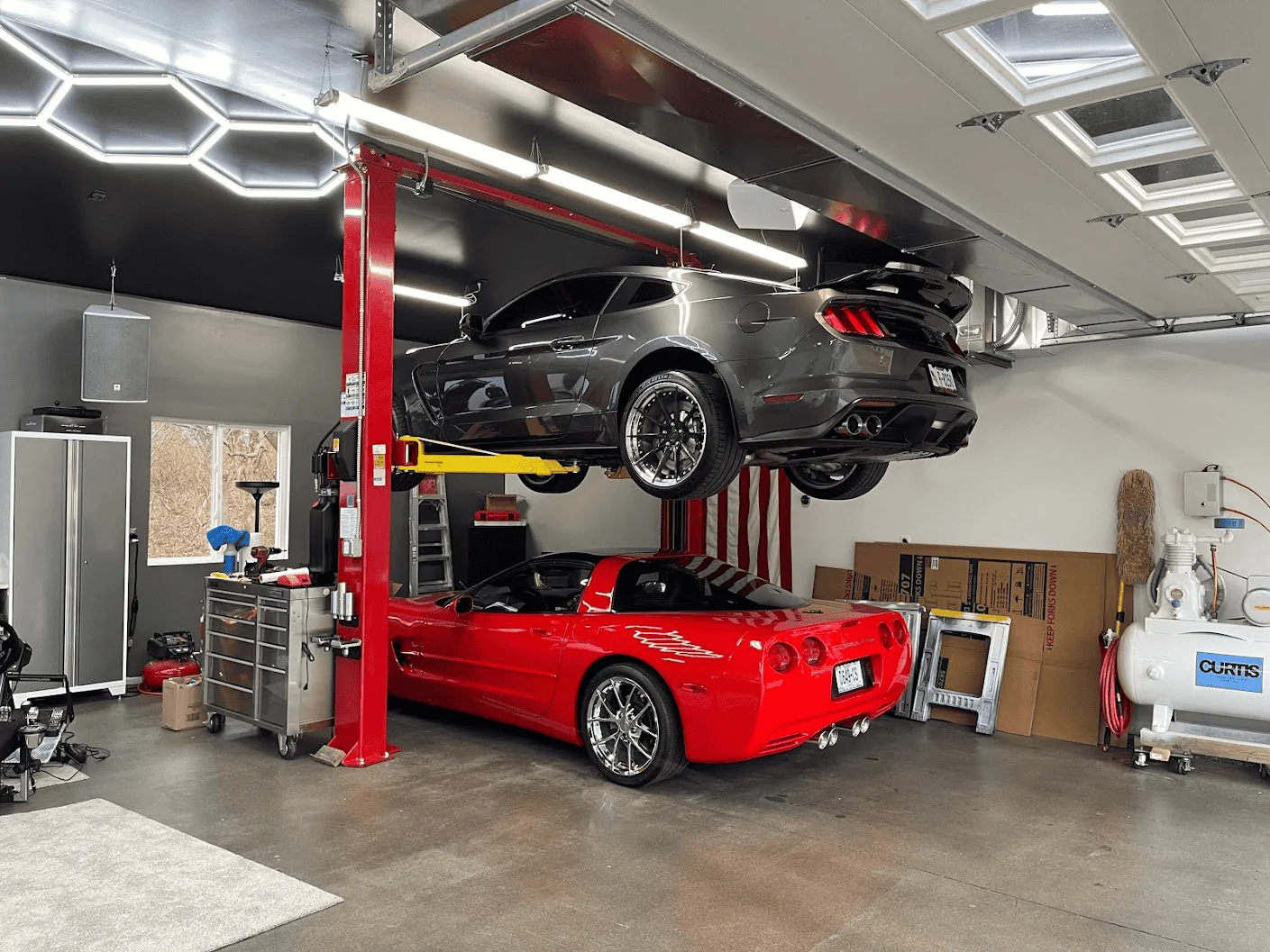

garagejournal.com is a great forum for questions like this. TONS of lift experience over there.
i don't have any joints in my garage but I did gamble on thickness. In general any modern garage should have the PSI rating and thickness to support a modern lift. 80 bucks at home depot can get you the tool to punch a hole or two and see that for sure.
you can fill them in later and touch up the paint. if i were you i'd do like the dude with the red lift up there and stick it as far to one side as possible to keep your middle area clean (i assume is a 3 car garage). that should get you far enough away from any expansion joints.
