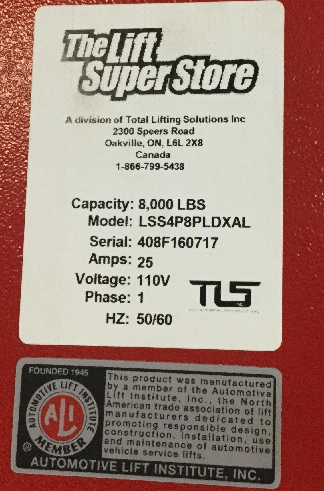

That is also the height of the ceiling in my garage. Please let me know the brand and model of your lift?
Mine is from the Lift SuperStore. Even though this sticker says 110v, mine is 220v. Can be installed either way.
