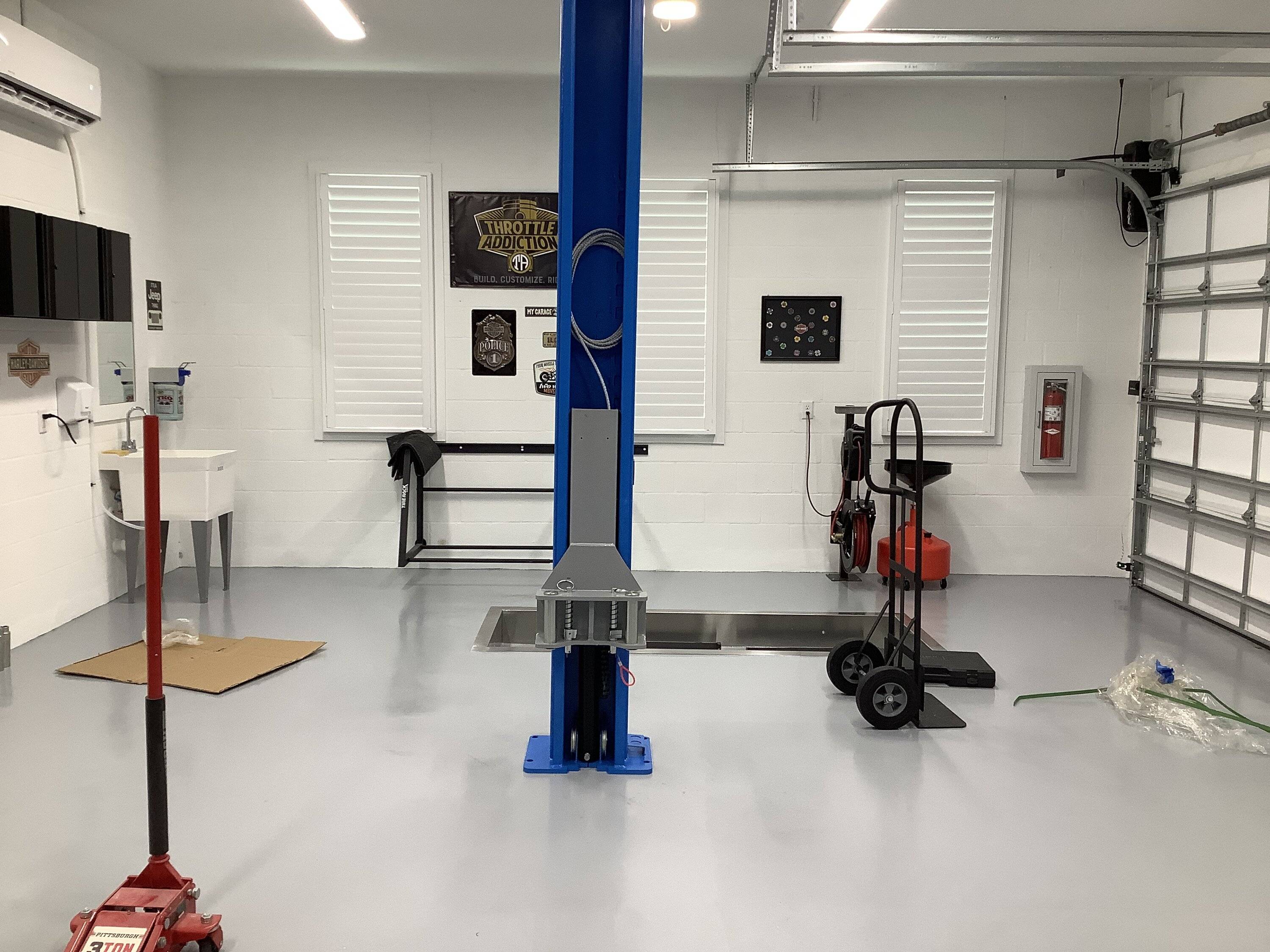

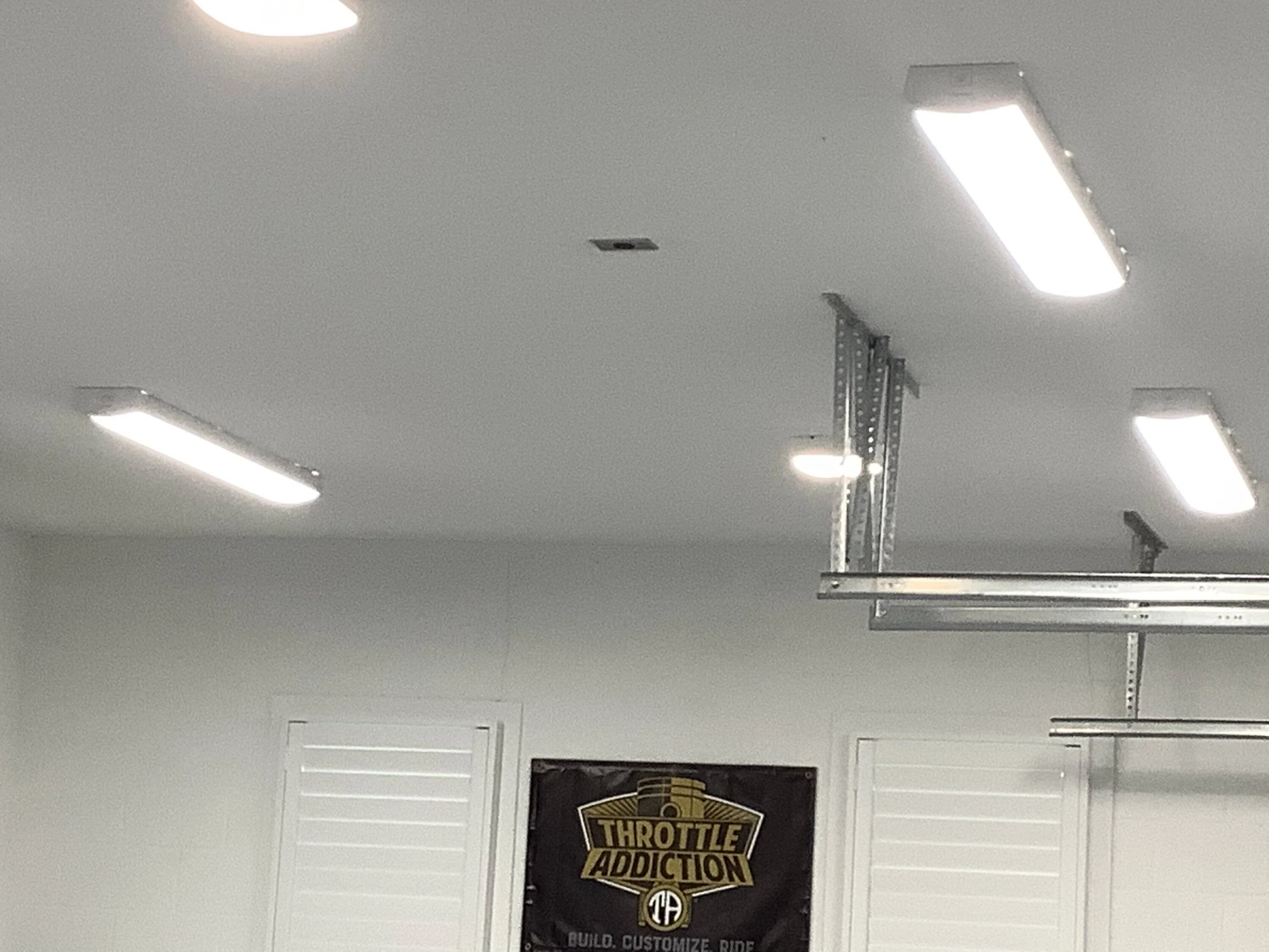

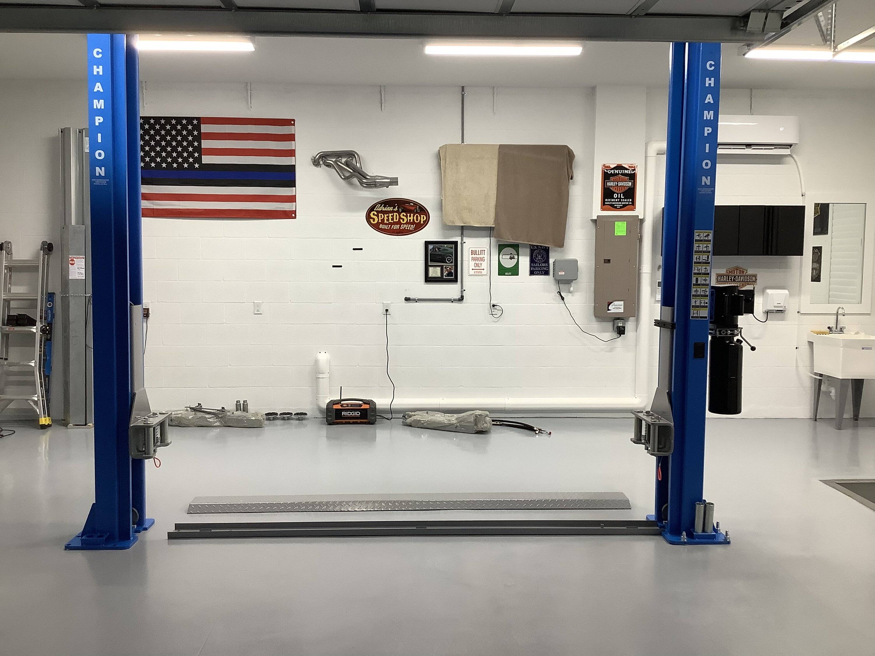

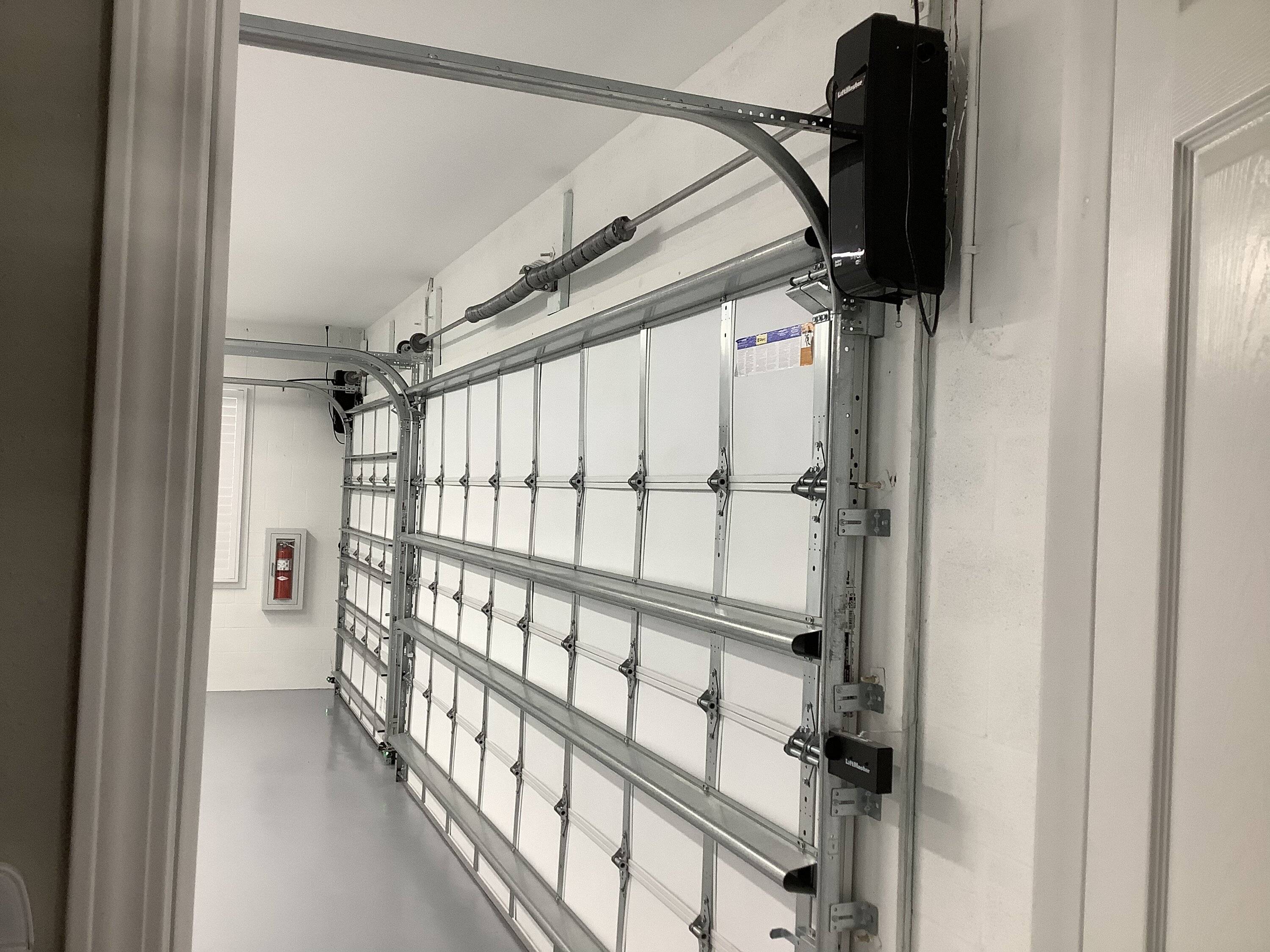

@NGOT8R I'm assuming this is only a working lift since your ceiling is pretty low at 10' 3". I've got 10' 6" with my 4 post and still wish I had at least another 6" to make life a little easier. I would also recommend installing a high lift type garage door opener since the track of your current one will hit a raised car from what I can tell in your pictures.
Good recommendation! I’ve got that covered. I have side mount or jack shaft openers and higher tracks (102” from the floor to the bottom of the tracks).

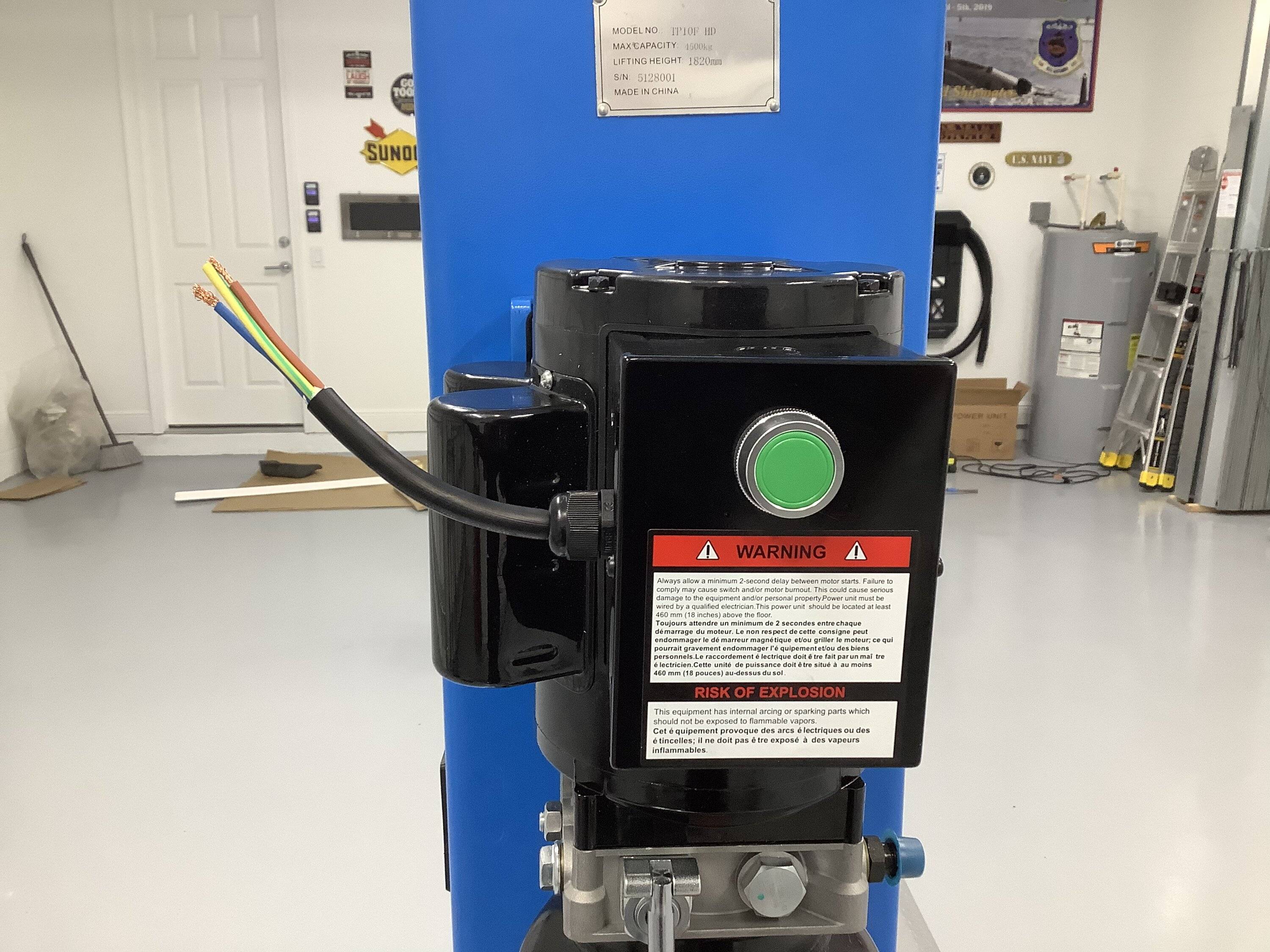

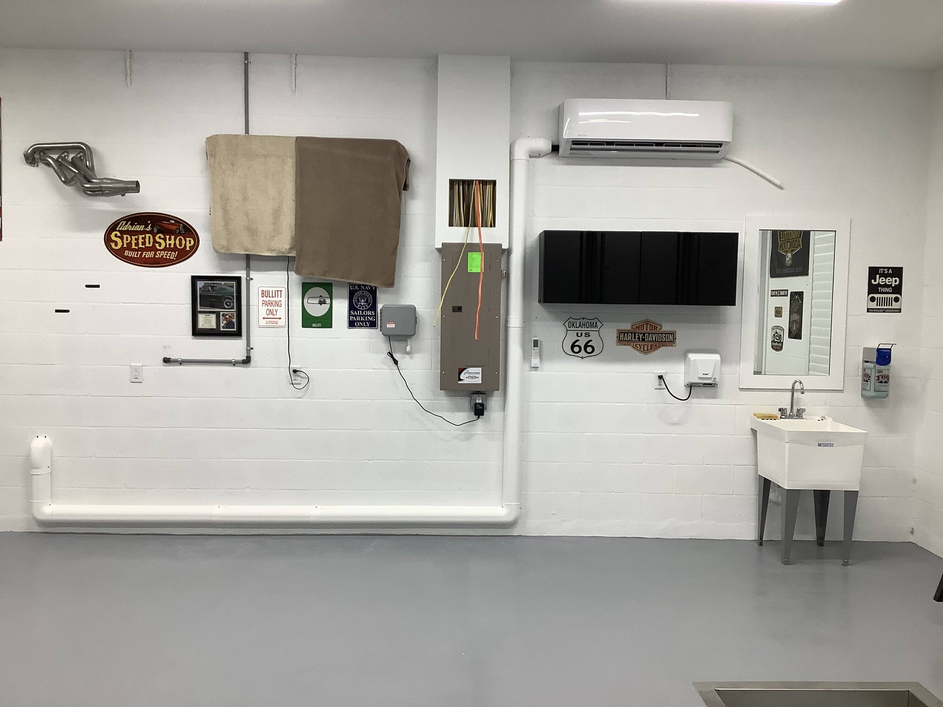

The yellow 12/2 wire is for the 220v mini split and the orange 10/3 wire is for the 220V for the lift. Here’s a pic of the lift outlet and door opener as well. I’m trying my best to work it all out properly and as safely as possible.

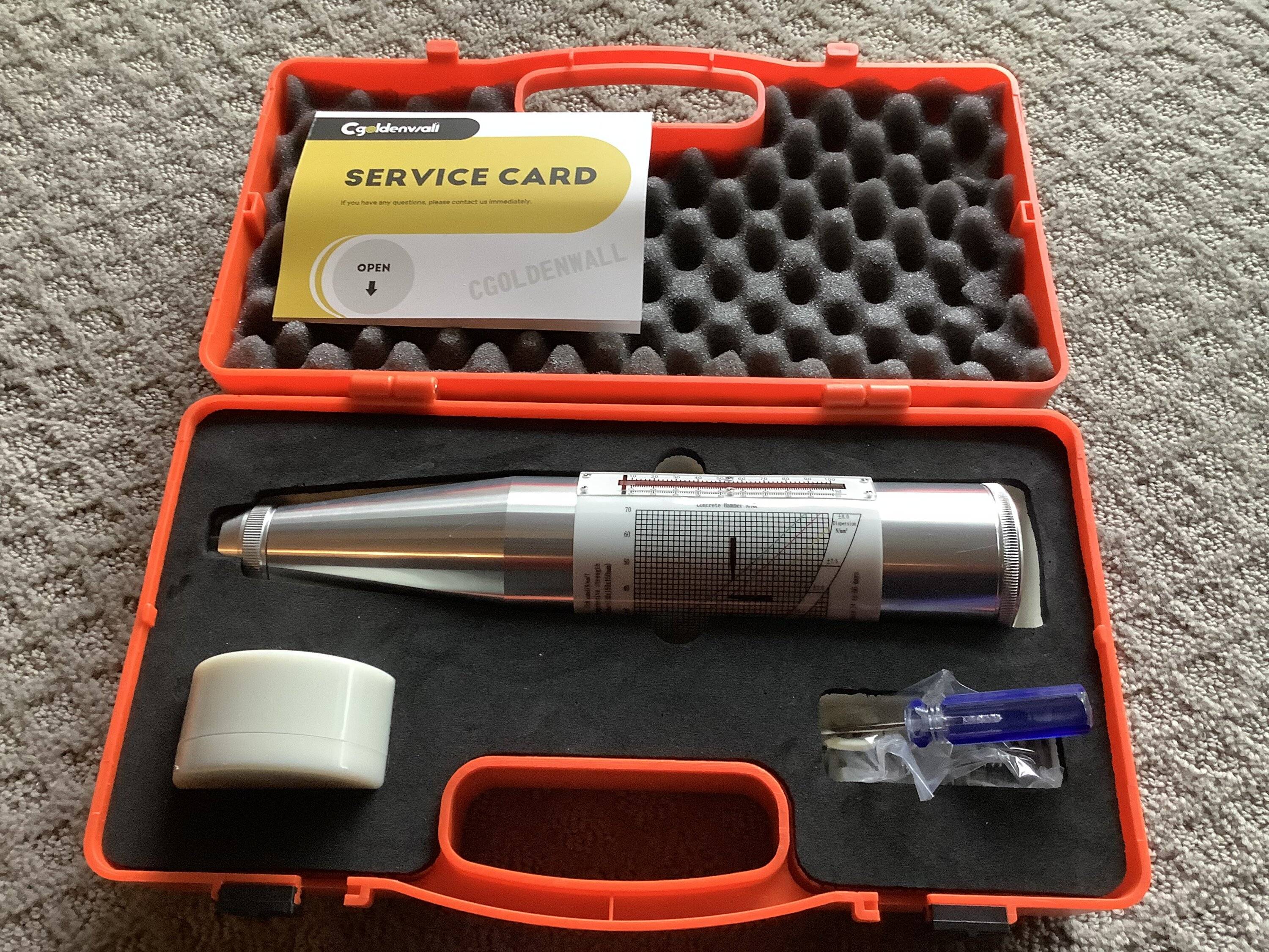

I received my Rebound Hammer Tester today. I took a total of 20 readings from the concrete slab (10 from the area where each of the lift posts would be mounted).

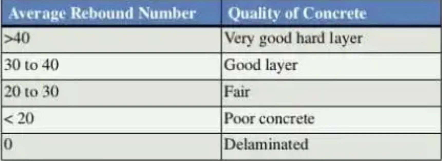

Note: The values for numbers 5 and 7, taken from the right post mounting area were discarded per the instructions and a revised average for the remaining 8 values was taken. Likewise, the value for number 5, taken from the left post mounting area was discarded per instructions and a revised average for the remaining 9 values was taken. Finally, the results of those tests were compared to the attached chart to read the quality of the concrete.

Note: When comparing the values to the chart, please bear in mind that the accuracy of the test is said to be plus or minus 25%. With that being said, my test results indicate that the quality of the existing concrete (in the areas where I intend to mount the lift posts) is “Very good hard layer” (taking into account plus 25%) and “Fair” (taking into account minus 25%).
Lastly, I am simply gathering data at this point and still intend to speak with the lift delivery/install guys to have them weigh in before a final decision is made to either proceed with the install (provided the concrete is thick enough), using the current slab, or cut out two sections and repour with higher PSI concrete.

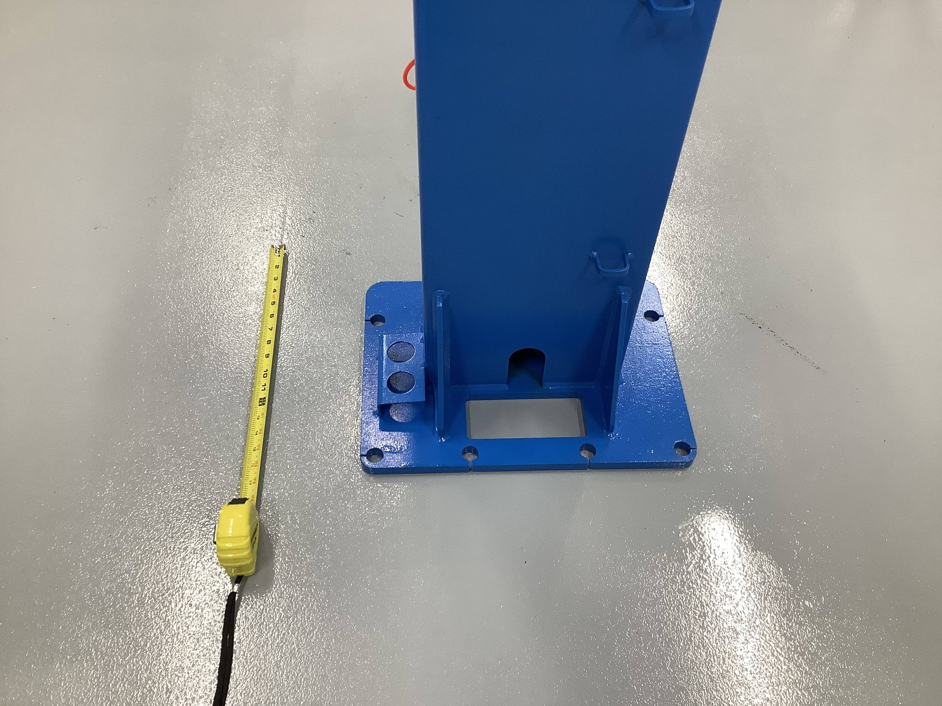

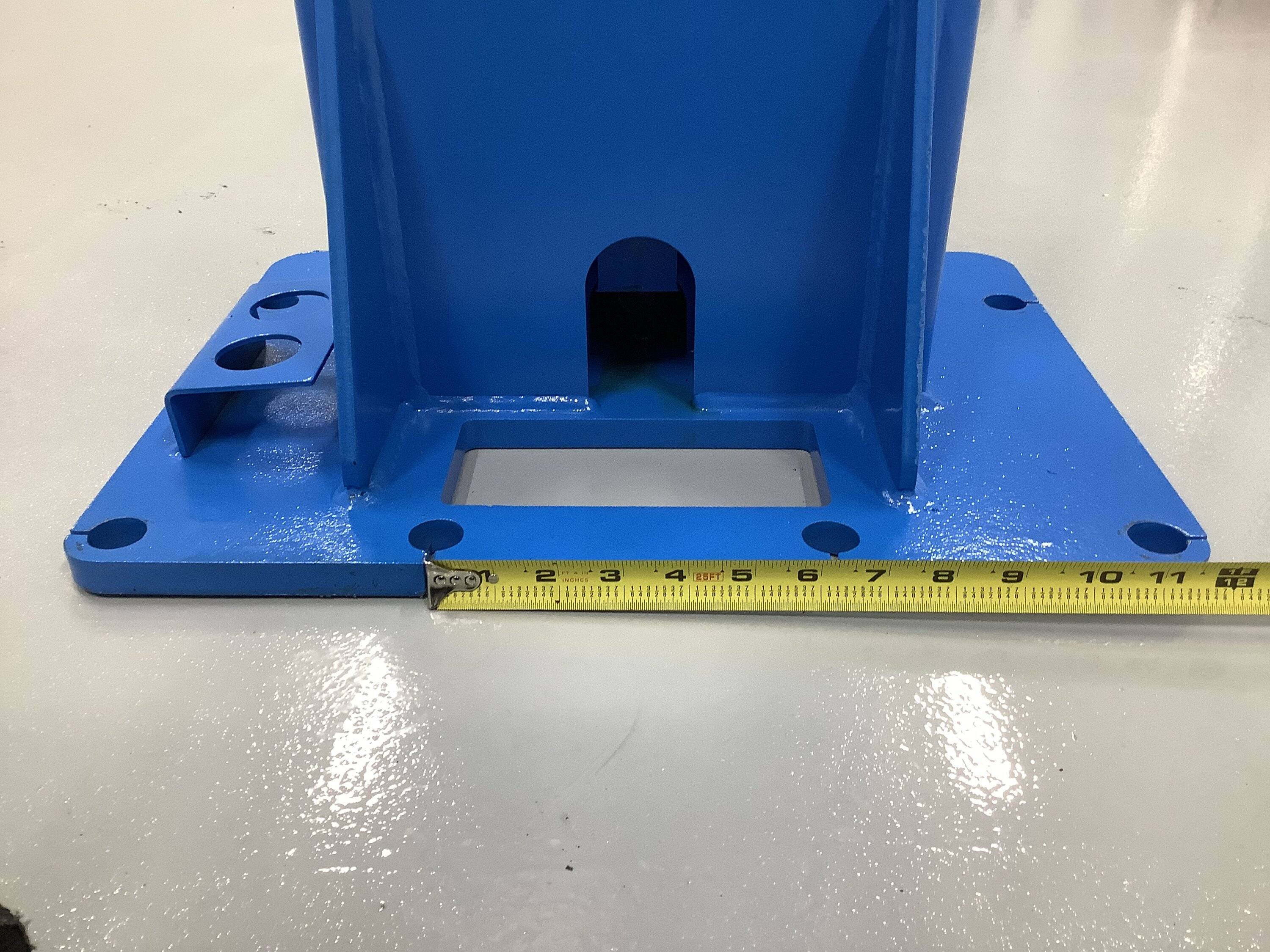

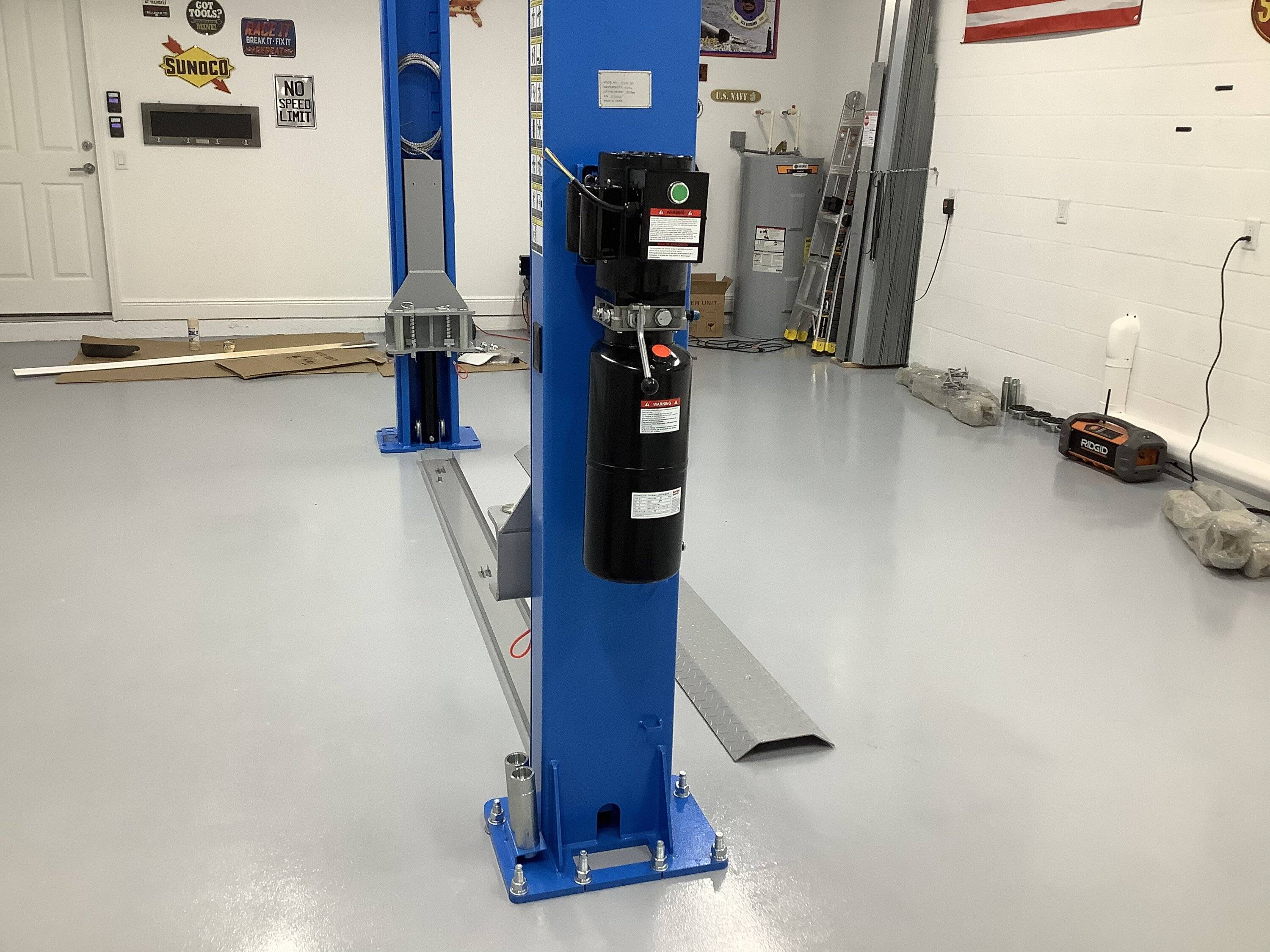

Okay folks, the lift was dropped off this morning. I wasn’t home when it was delivered, but my wife and daughter were. I left them with a list of very detailed questions to ask the delivery/installer guys. One of the questions was whether I could straddle one of the control joints. The seasoned/experienced guy, Sean said that it was perfectly fine to straddle the one control joint that is referenced in the photo. Doing this will still keep me 3 1/8”away from the holes on either side of the control joint. This is the optimum position and will allow me to have an equal amount of room (15”) in front and back of the car to walk around it. Note: The four remaining holes will be 8 1/8” away from the control joint. This is what I am going to do. If there’s a problem, I will halt the install and take the appropriate action.

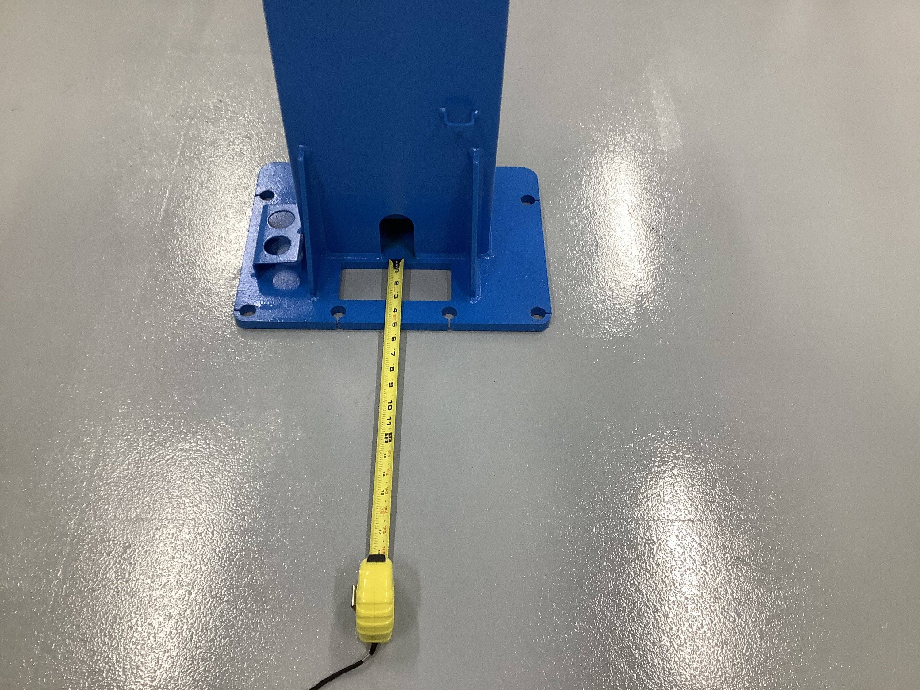

The right tower has been drilled and bolted down. The concrete measured at 4 1/2” - 4 3/4”. All six bolts took the recommended torque setting of 90 ft-lbs. I stopped for the day because I need to run to the hardware store and pick up some 1/2” X 3” Tapcons to mount the C-channel for the floor plate, so that it doesn’t move whenever I drive the car over it. I was quite surprised that Champion didn’t supply hardware for that. Another thing that I wasn’t aware of until I pulled the motor/pump assembly out of the box was, it only comes with a 6” pigtail. This means I’ll have to buy some cable to wire this up to accept my twist lock connector for the ceiling outlet.
