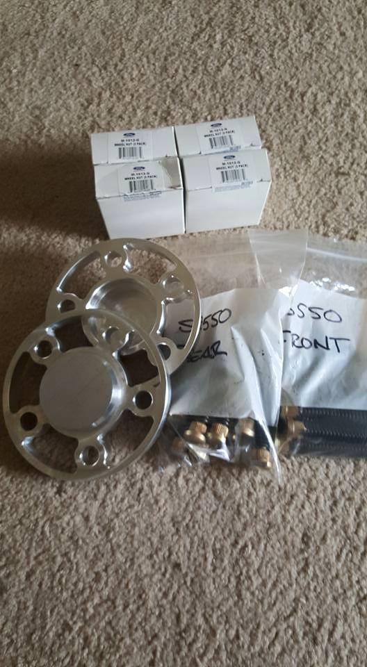

maybe 18X10 or 10.5 BBS. Dean sells them pretty cheap and they are only about 20#'s. Lot of Mustangs running in TA3 in TransAm so tires(R7's) for my purposes (moderately used) would be cheap. I just HPDE so I just want something to beat up on anyway. With his spacer the 18X10 would gain an inch of wheel width and move it away from the strut .320" from stock 9" PP wheel. It would give me more room to grind the top strut hole for camber. Forgestars are a lot cheaper but I want to take as much weight out of the car. BBS's are very strong and mass produced. I will take well used beat up wheels if they become available, because I'm cheap and not into the show crowd.

Nice spacers:)

Oooou. Those look light....

I figure if I go with 18X10's and 295 R7's it will remove about 70 pounds out of my car...all unsprung weight, less work for the dampers to do. 60 vs. 45 on each front, 64 vs 45 on the rear. Factory PP wheels and tires tip the scales at just under 250. 20 pound wheel and 25 pound tire add up to 180. That's a serious diet and a bigger footprint.
Spacers are 15.5oz each, ARP studs are 2lbs, nuts are about a 1lb. I think the larger factory 14MM studs and nuts will cancel out.
