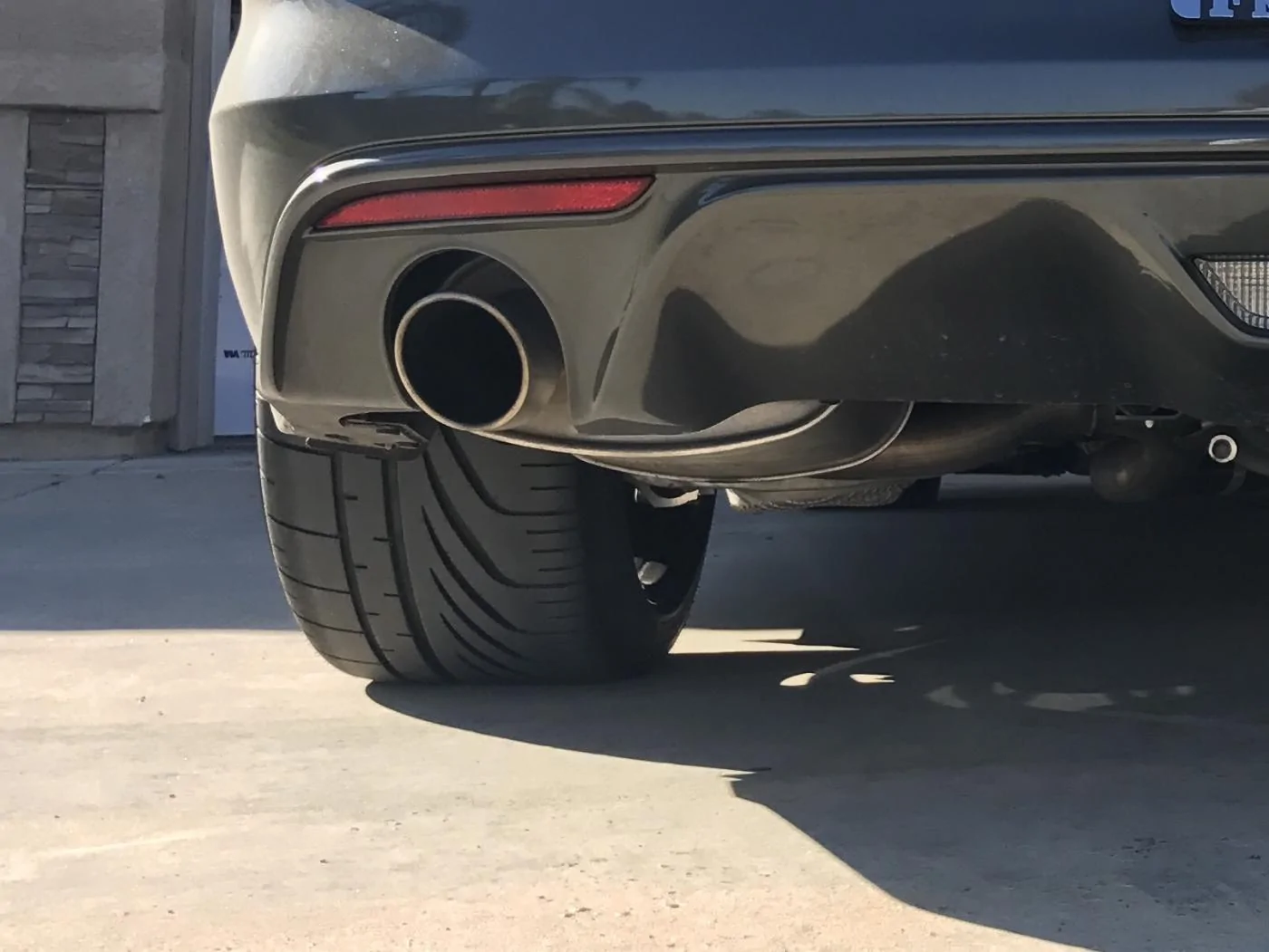

maybe a picture will help
this is your rear tire and my tire suggestion

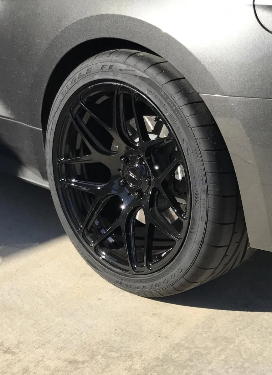

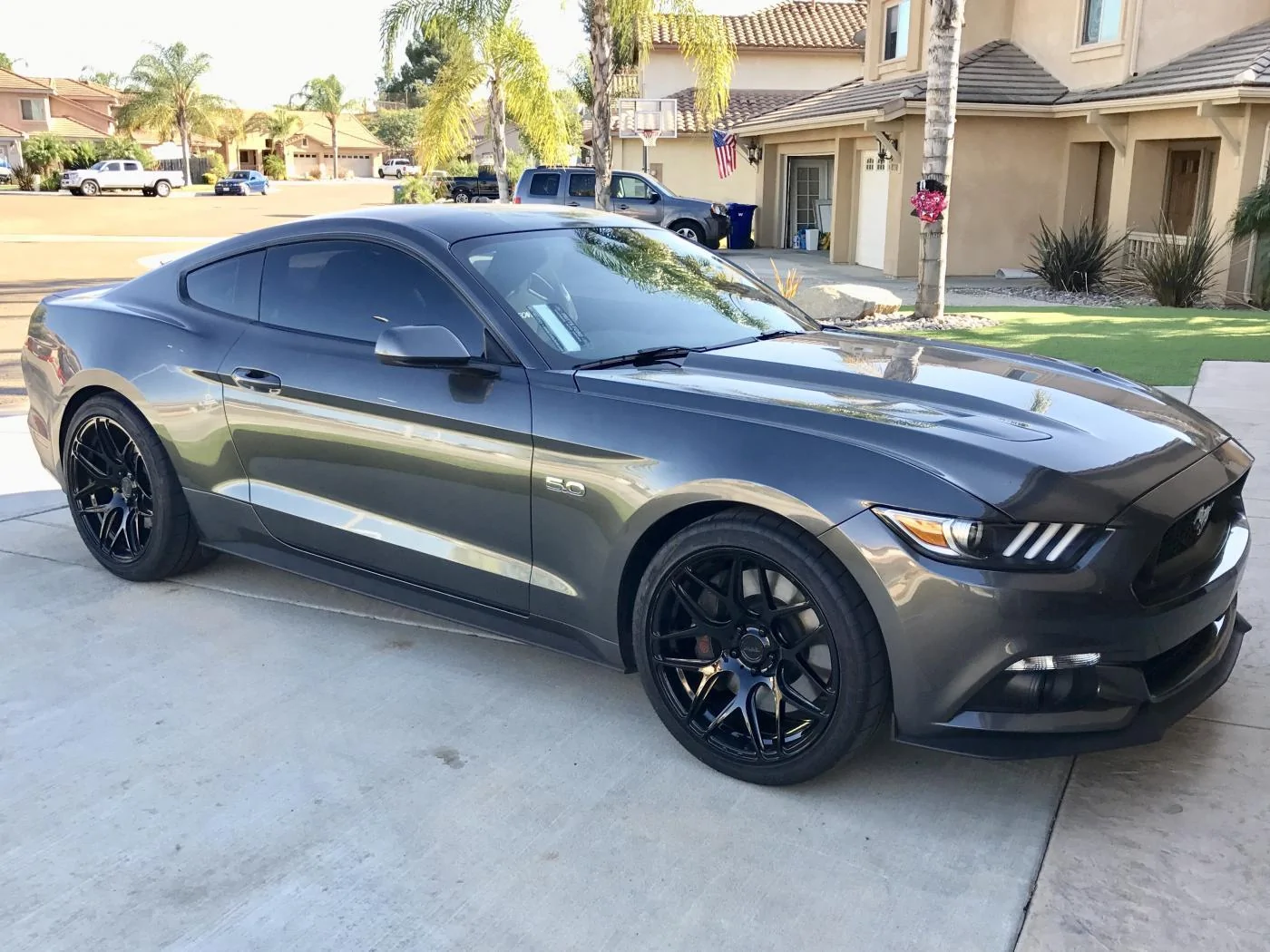

MRR FS01 wheels ..... 20x10 front with 35 offset and 20x11 rears with 50 offset. Just threw them on today. Nothing rubs and just enough room for the wheels to tuck when I lower it without having to run crazy camber. Paul knows his stuff and MRR will make the correct offsets ... you can't go wrong!
285/35/20 front
305/35/20 rears
