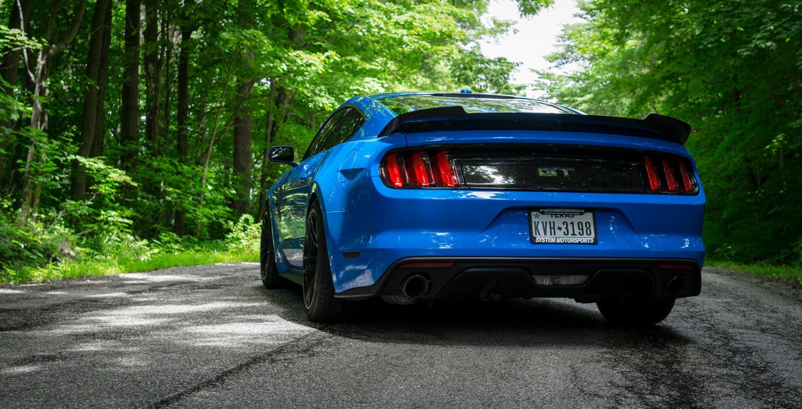

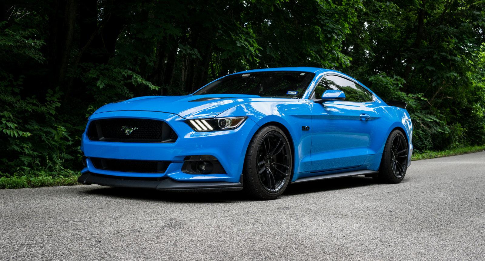

19x10 +35 square with 5 mm spacer up front (effectively making it about +30).
Lowered on CJPP springs with -1.5 camber up front, 275/35/19 Bridgestone Potenza RE760s squared.
Will post pics soon of what the car looks like on coilovers and a bit lower
