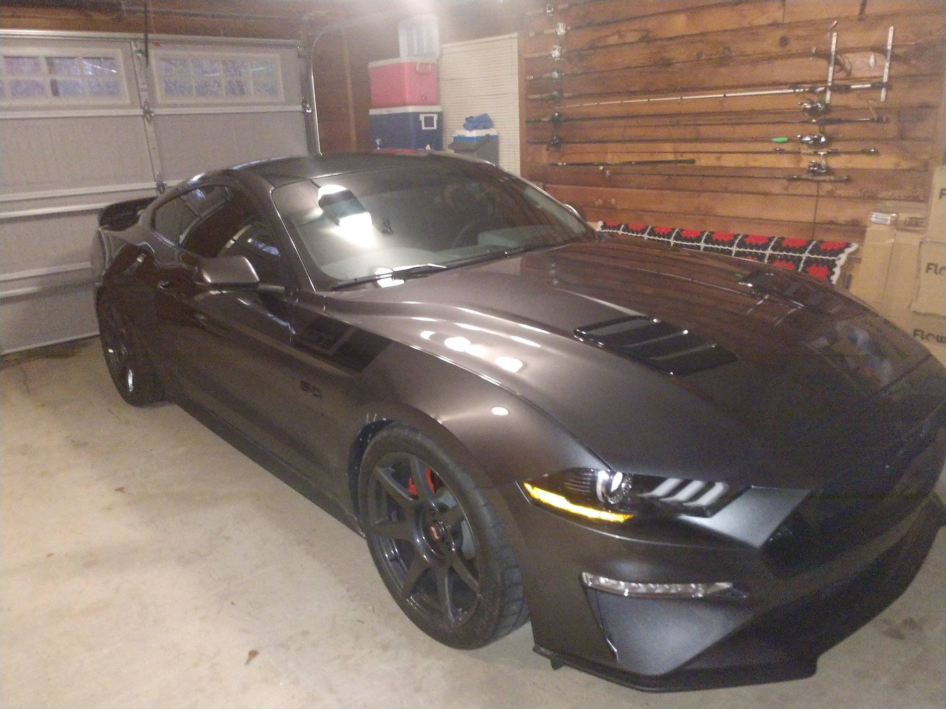

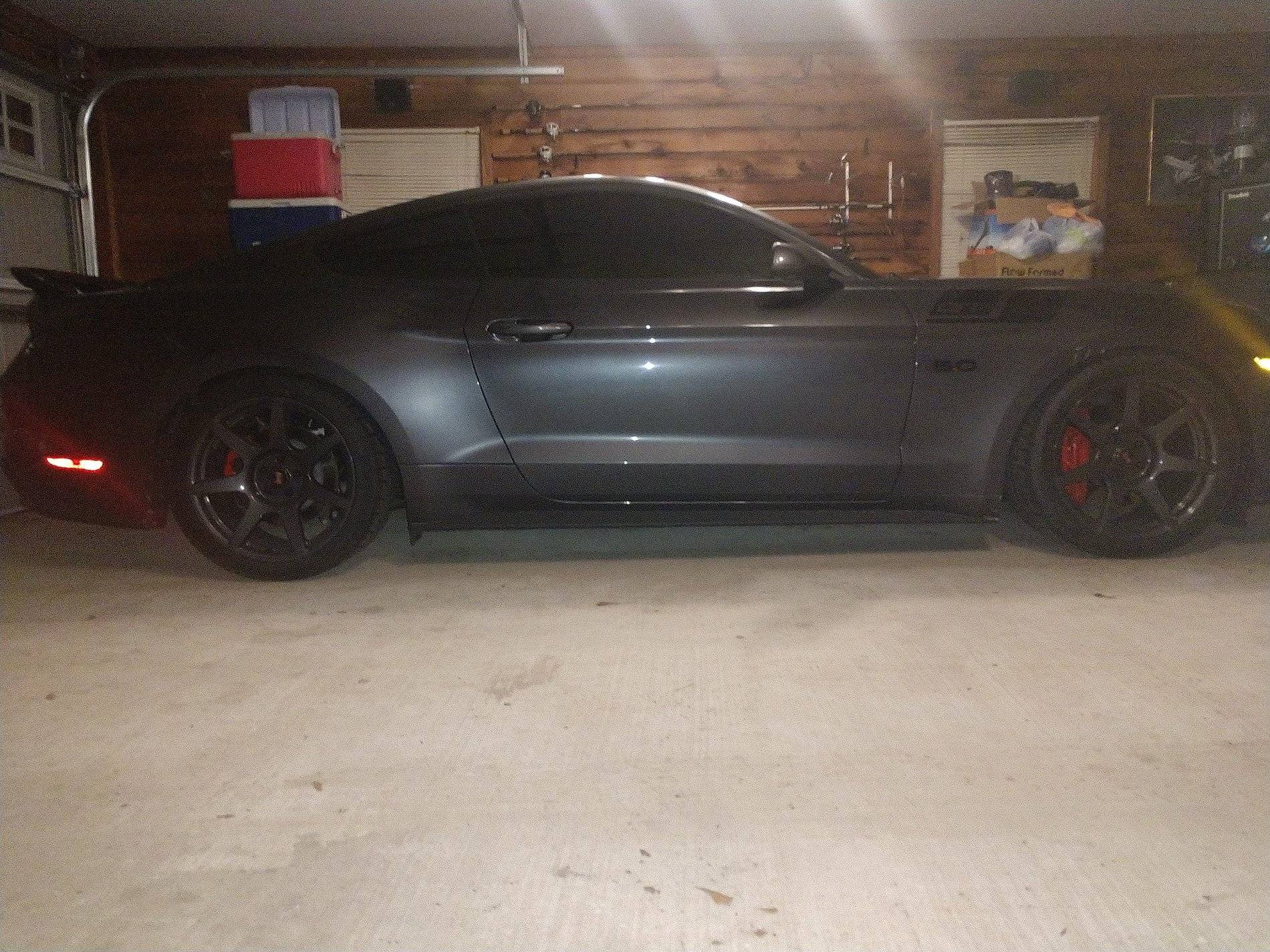

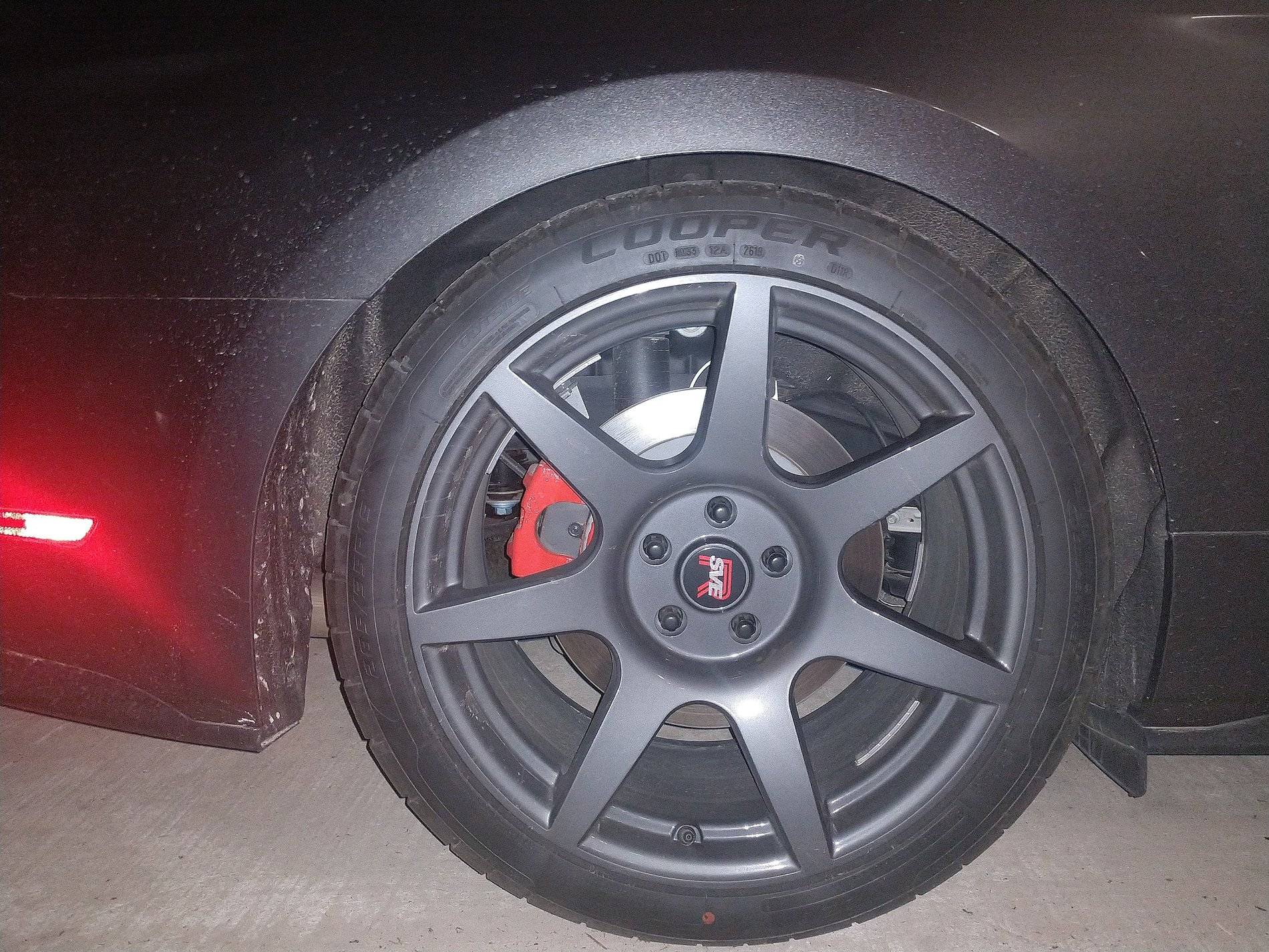

I have 19x10 s+35 with 285/35/19 Cooper RS3's lowered on Steeda Progressives with the Steeda Active valve shocks and camber plates and have no rubbing at all

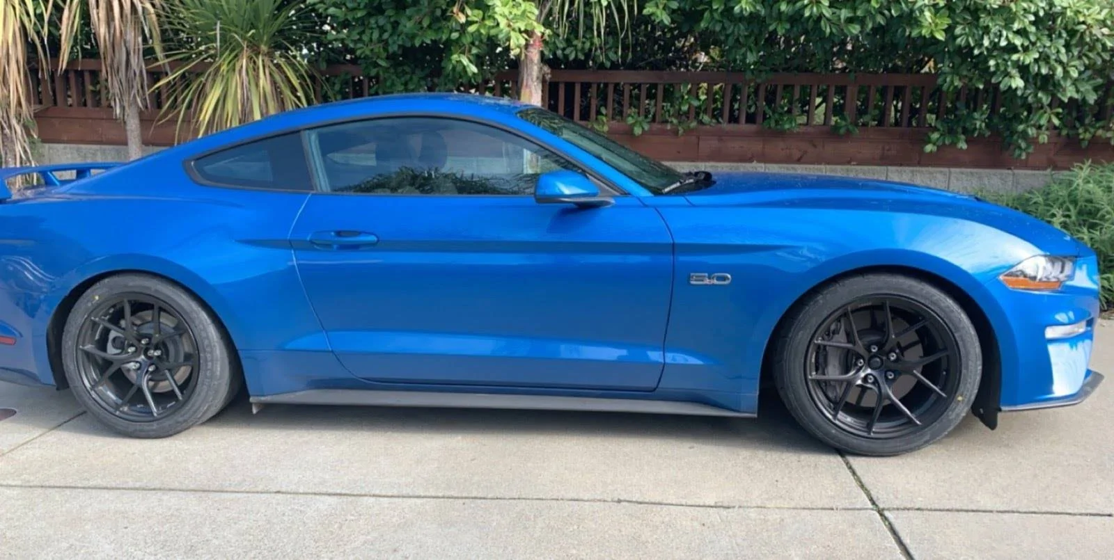

Here's a customer with a set of 18s on his GT. Running a 275/40/18 tire setup all around. No rubbing or issues.
