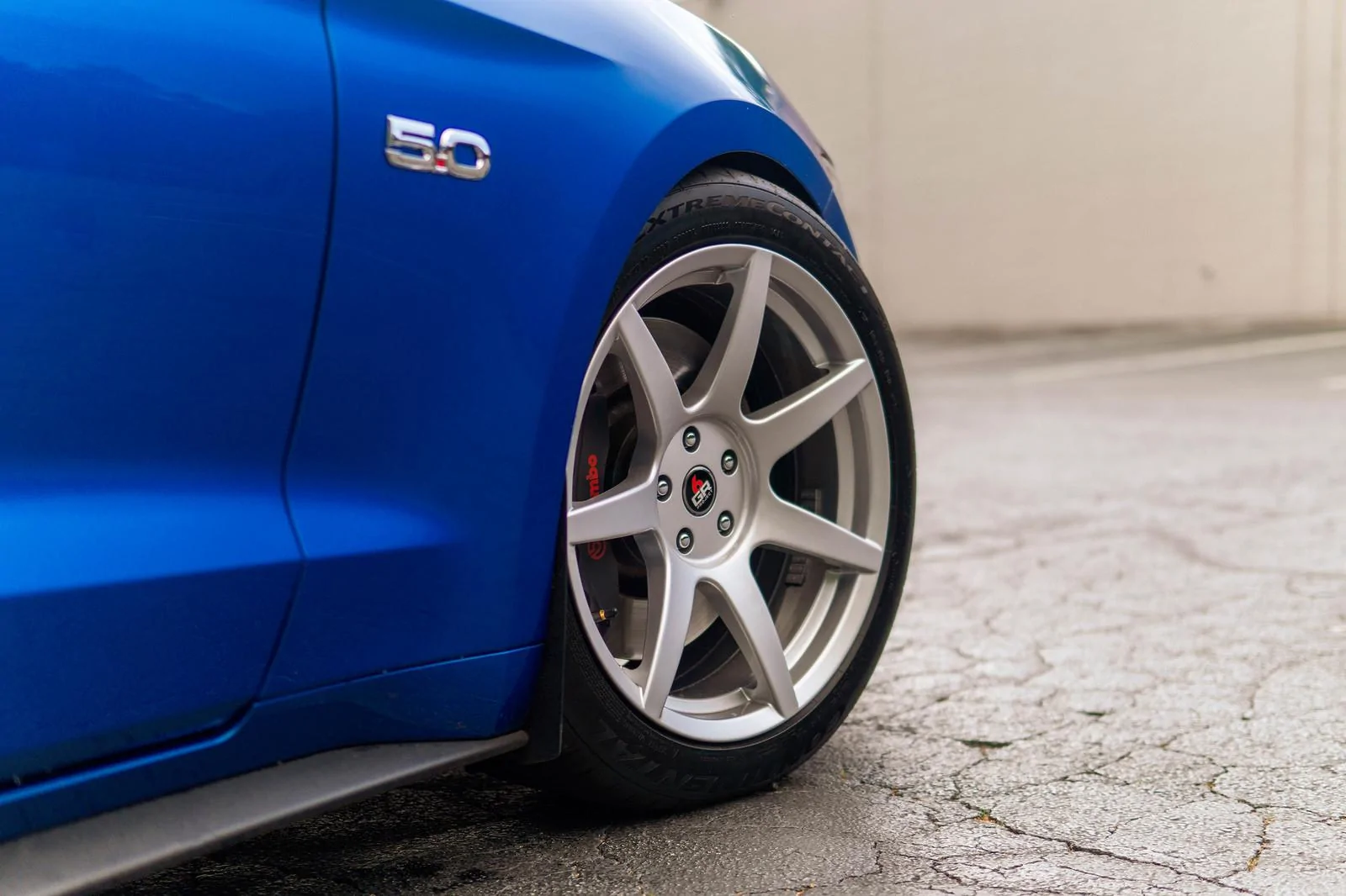

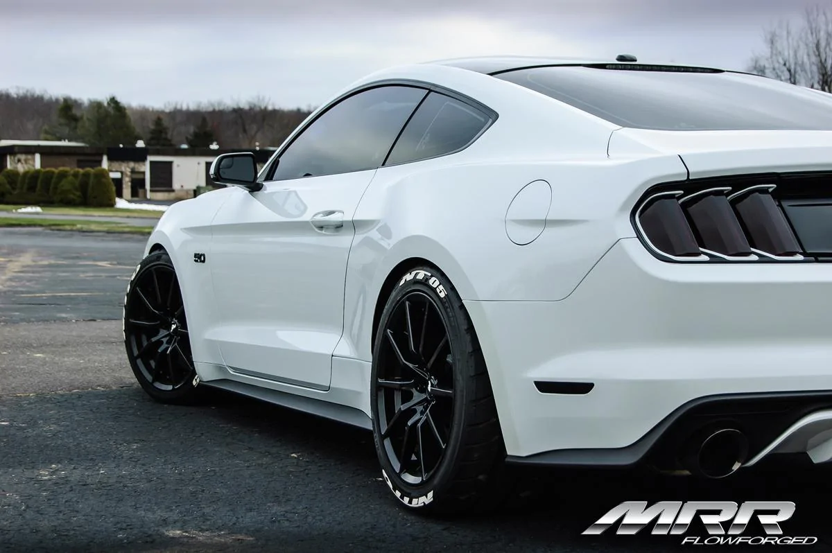

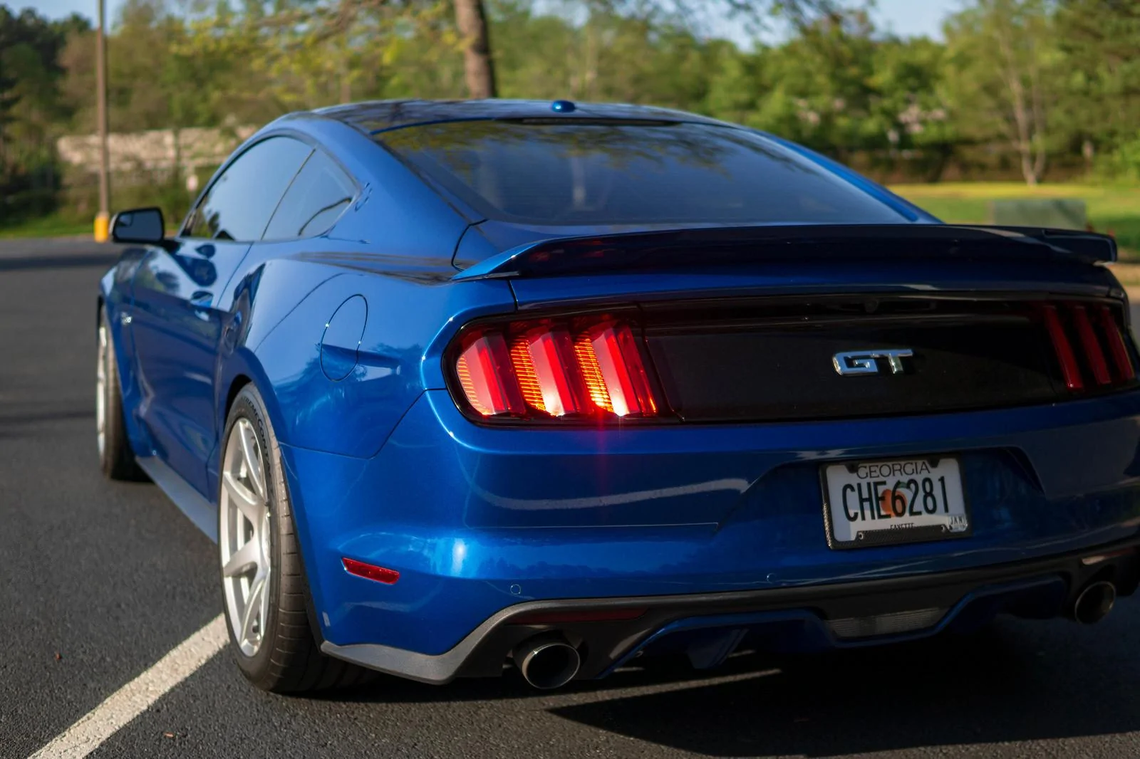

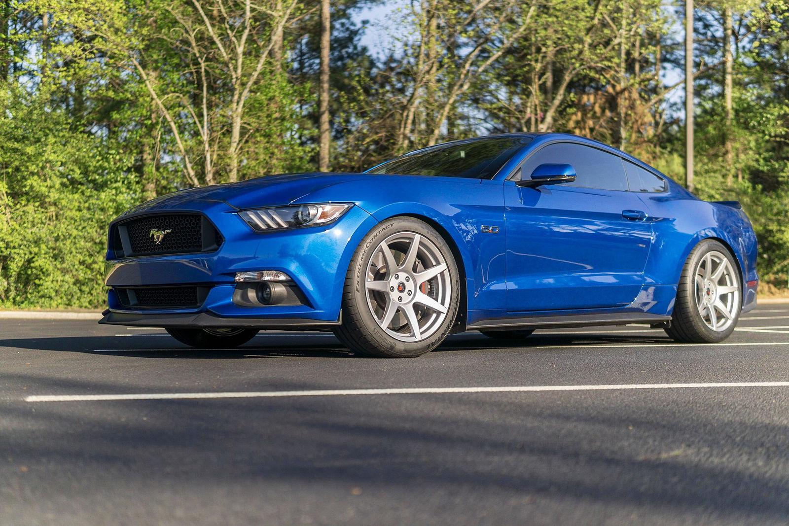

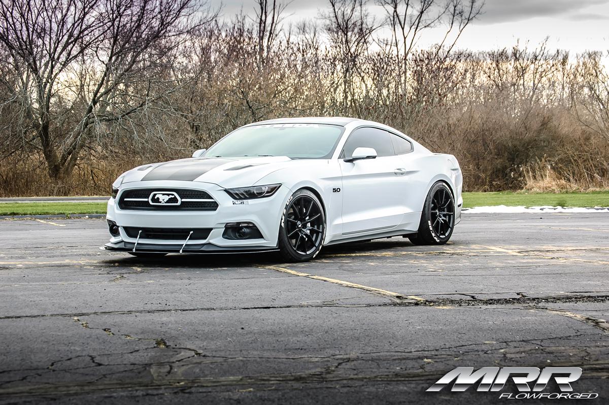

some visual
these are 19x10 40et no spacers
and
19x11 55et no spacers
a higher off set allows for a wider tire with out the rubbing factor
That's a great look!!! What size are the rear tires?
Thanks
