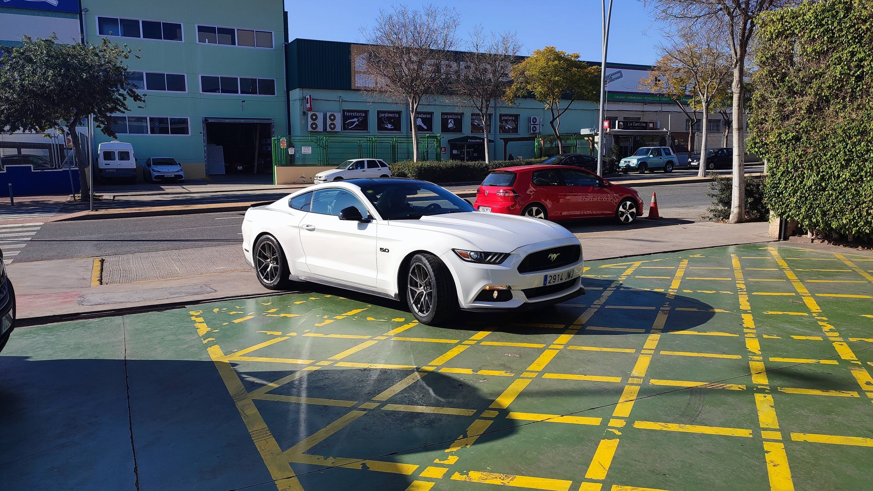

I don't like spacers. Don't like an intermediate piece between wheels and studs.
For that reason this is what I have done:
4* 19 9,5" aftermarket wheels et35 with 4 * 275 40 r19 continental sport Contact 7. No spacers, no rubbing, stock height. Just picked Up my car from the tire shop today. Perfect stance for me. Could not be happier.

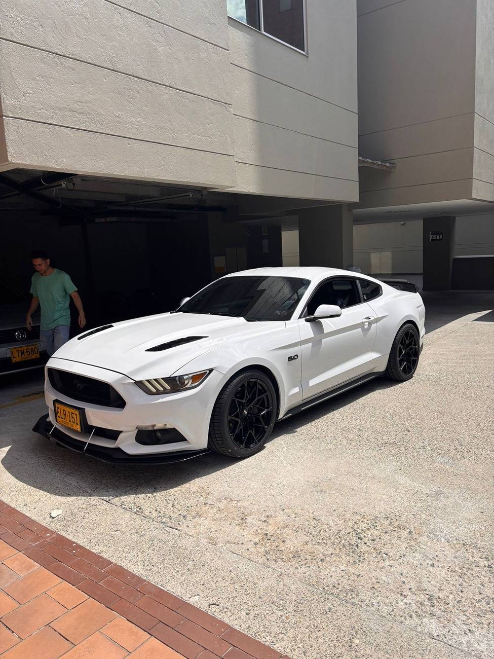

Thanks for the reply. I ended up going with the LMR MHP1 in 19x10 squared with 285/35r19 tires

Very intelligent decision as well. Love the stance. Congrats.
