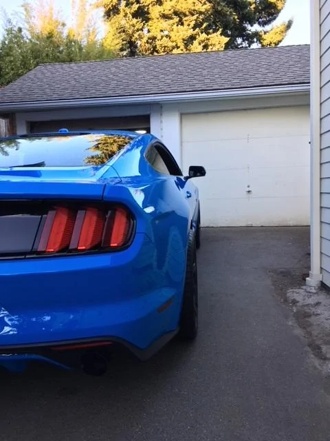

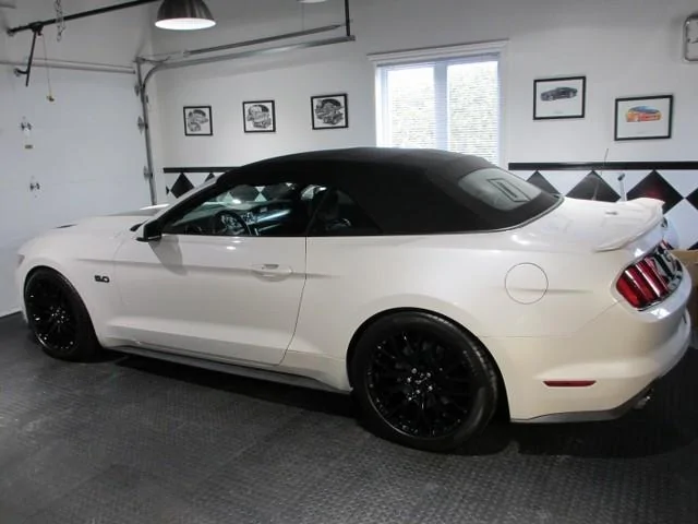

Not the best , but .....
That's the with BMR min drop 7/8" Fr , 1/2" Rr , but once settle it went 1" front and 3/4" rear, notice that vert are heavier in the rear then coupe, oe tire size, 25mm spacer all around

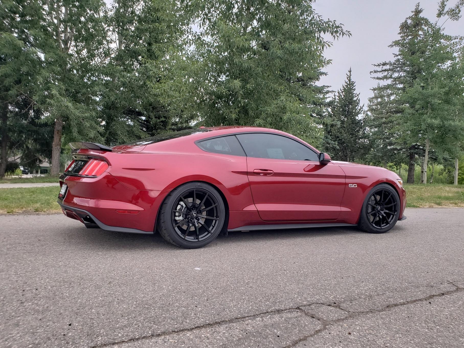

I'm on 285/35R19 tires with a 19x10, as are a few hundred of us. Its a very common setup and looks great, especially if you are going from stock to a properly flush +35 or +40 offset. The visual difference in the flush offset more than makes up for any tire height you're loosing. I have zero point zero regrets going to a square 285/35R19 setup.
(FWIW, its only 0.8" difference, not a full 1.0", and thats about the difference between a bald PZero and a brand new tire with full tread anyway).
What he said.
Pic of 1" drop, 19x10 square , +40, 285/35/19
_

^ What springs 'cause I've got more gap than you in the rear?

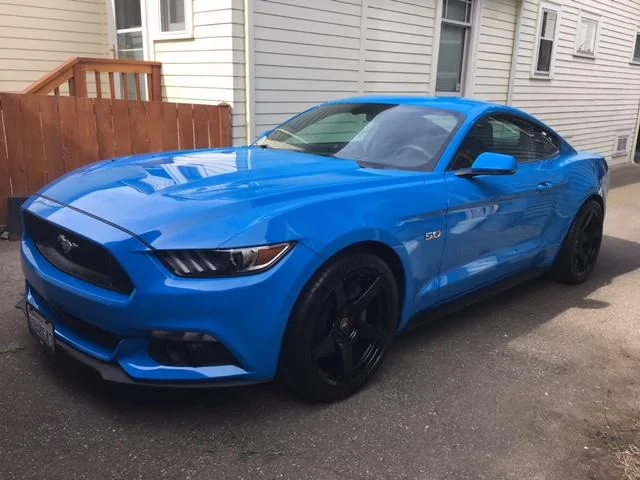

NightmareMoon
Nov 22, 2015
7,176
6,468
Austin
2016 Mustang GT PP w/ Voodoo

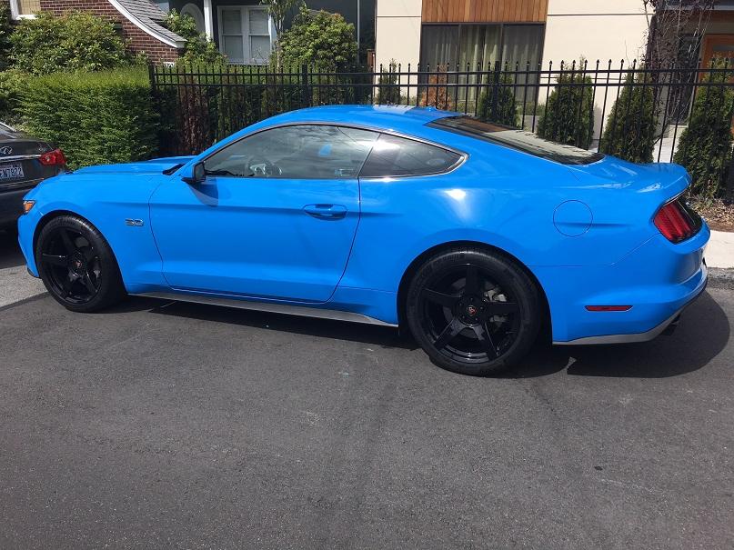

NightmareMoon can you please tell me what wheels they are?
Those are Project6Gr 7-spoke in satin black from Need 4 Speed Motorsports (n4sm.com). 19x10 +35 square.

Steeda progressive springs. 1" in rear and 1 1/8" in front. Wheels are the SVE S350.
Do you get any scraping on the fender on hard bumps? Or do the tires still sit inside the wells enough to absorb the impact?
Have not had any scrapping. I do think they sit in just far enough to avoid. Of course I always avoid potholes and rough roads as best I can but no issues so far.

I got the same wheels with the same offset. When you lowered your car did you end up getting camber plates?
I did install the Steeda camber plates. Folks are 50/50 on needing them with only a 1" drop but installed them anyway. I'm sure it made the alignment shop's job easier.
