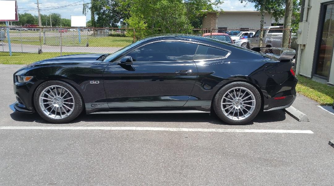

I'm running 19X10 with 285/40/19. These tires are only 1% difference (taller) from stock PP rear tire diameter. 285/35/19 is 4% difference (shorter).

Now lowered. I did put a 5mm spacer up front though as the tires were rubbing on the struts slightly.

My s550 is my daily driver and I'm looking to get away from the staggered (PP) and go to squared for additional miles and rotation. I'm leaning more towards the 19's, but wondering if anyone has a similar setup/situation and could provide feedback. I'm at stock PP ride height and have no plans on lowering the car.
Thanks for all your help!
Here ya go Felix. 20x10 square, stock height, and even the same color as yours:
