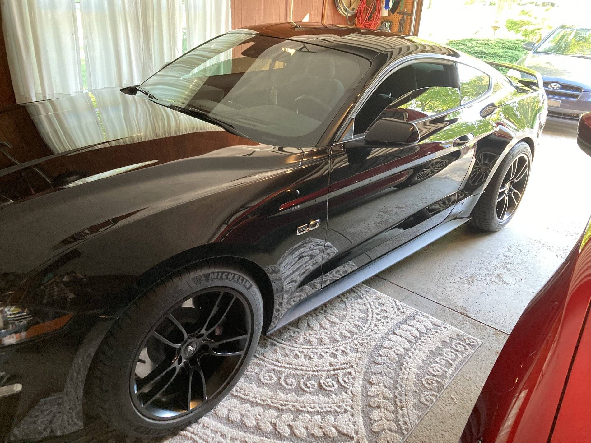

I literally just dropped my car off at the tire place, with these exact wheels to put on a 2020 PP1 car and they called me back to warn me about the fitment. I said a bunch of people are running the same setup with no problems, but now I'm worried. MRR M600 19x10 35mm all around with 275/40/19 Michelins Pilot Sport 4 S all around

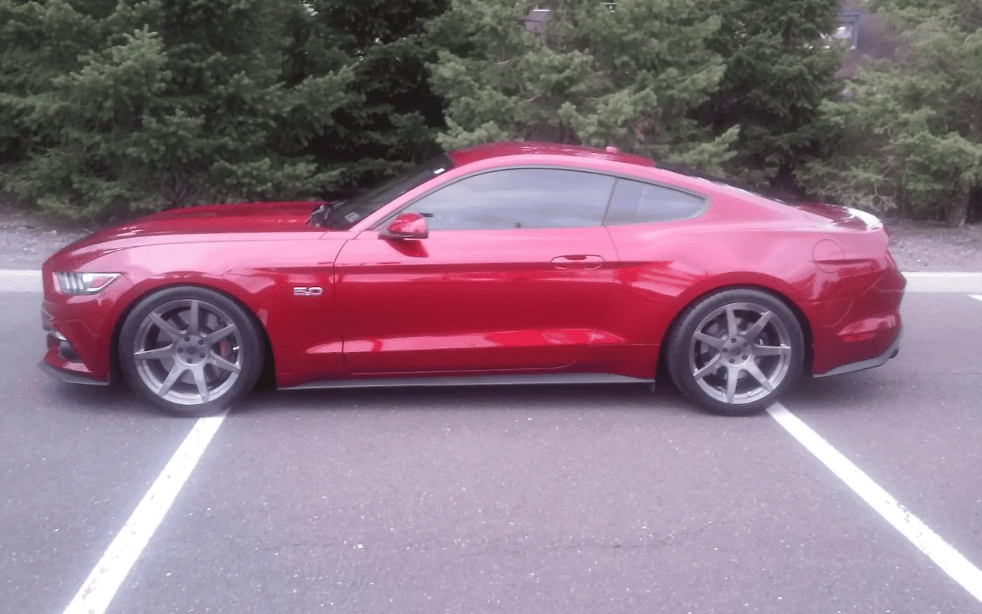

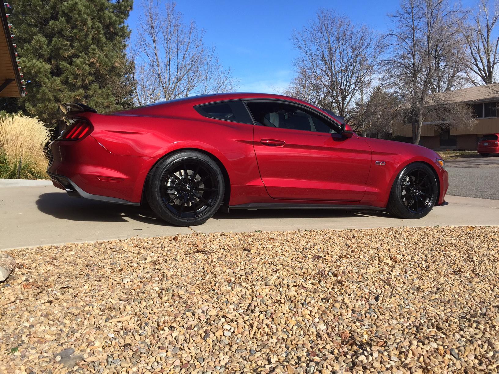

BTW, running 19x10 +34 (+40 with 6mm spacer) and fits just fine as you can see:

Ended up being no problem. When they test-fit just the wheel without the tire in front, they said it was only half an inch from the strut. Darren from MRR had already assured me they would fit, and it turned out fine. I live in small-town Ohio and I don't think they get the chance to install many aftermarket wheels

Yes, I made sure to check that and counted at least 8 full turns on the lugs when I stopped counting.
I've done 14 track days (at least 3 sessions 20 minutes each) on this setup and have not had any issues with the wheels. FWIW, these are high quality billet custom spacers not the universal crap from AutoZone. I would not use those, or anything thicker.
