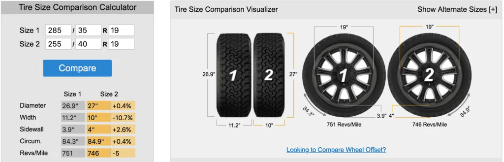

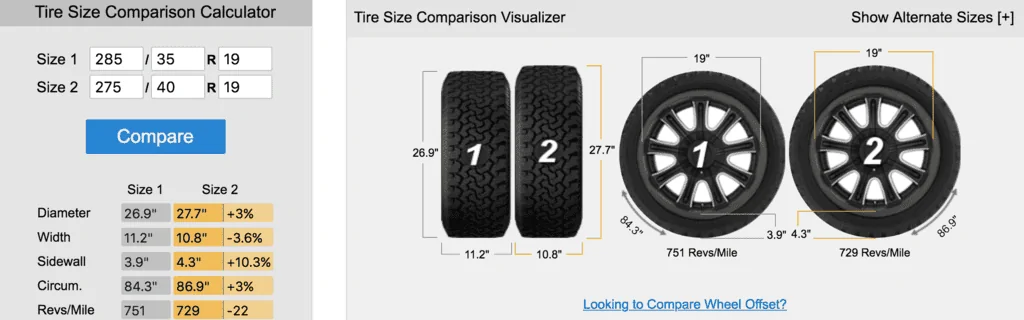

Being that I am going with a 19x10 setup with 285/35/19 tires I decided to look up the dimensions of the tire before and after.
What I found was that the front diameter didnt really change but the rear did by an inch over all. This lowers the rear by a half inch and opens the wheel well the other half an inch showing more gap.
My question is, what's the fix? Are there other setups that dont do this?
I already think the font is a little high. I definitely dont want more fender gap in the rear or it to be lower. Suggestions?
See pic below.

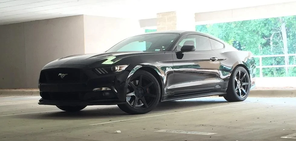

NightmareMoon
Nov 22, 2015
7,095
6,367
Austin
2016 Mustang GT PP w/ Voodoo
Do you have a good pic of your car to share? Just curious.
I went looking, and I didn't have many where I'm not accelerating with the rear squatted down haha, but I did find one. This is before I started running +5mm spacers in the front.
FWIW checking it out a moment ago, to my eye, the gap from wheel to fender looks equal front and rear.

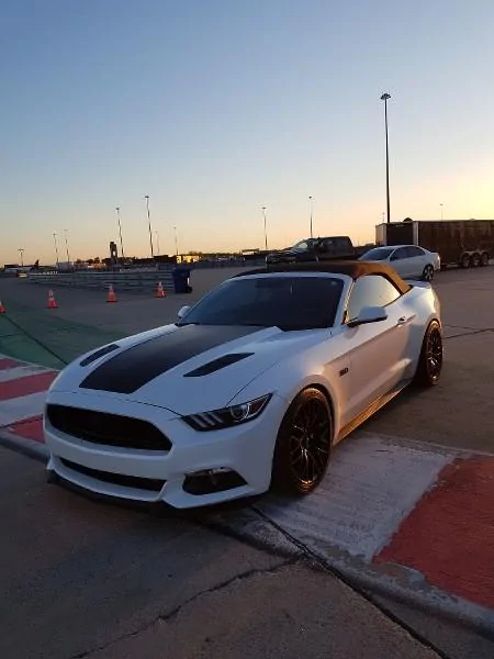

Synar
Apr 4, 2018
Quebec , Canada
Sylvain
2017 GT Premium PP Convertible Platinum White
Any side pics?
Not the best , but .....
That's with BMR min drop 7/8" Fr , 1/2" Rr , but once settle it went 1" front and 3/4" rear, notice that vert are heavier in the rear then coupe, oe tire size, 25mm spacer all around

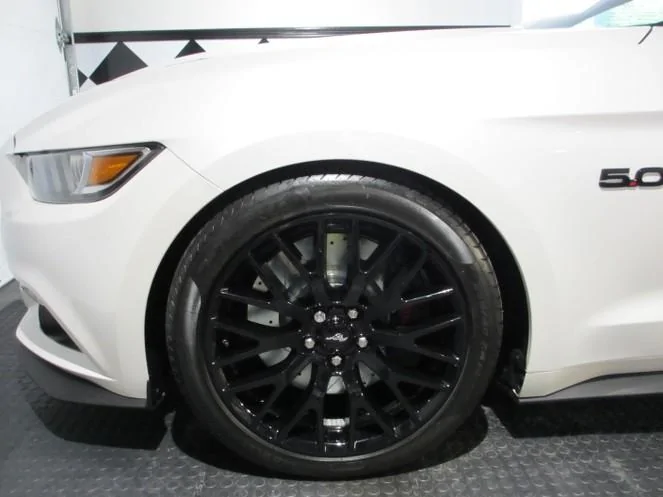

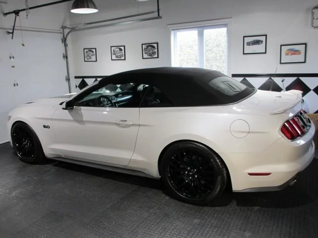

NightmareMoon can you please tell me what wheels they are?
