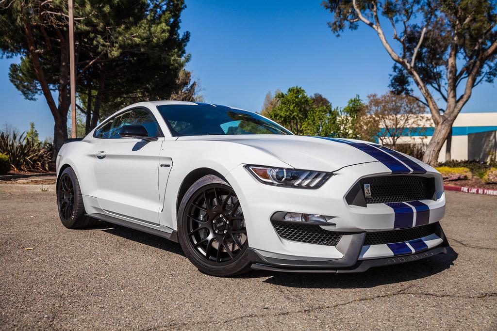

As others have mentioned, with an ET48 you would need to run spacers up front for proper strut clearance. The spacer thickness required would depend on your tire brand/size and the type of suspension setup you are running as not all are created equal. You would need something between 5mm to 10mm.
Ideally you would want to go with something closer to an ET40 if you want a spacerless fitment. Our EC-7 19x10" ET40 Mustang wheel has worked very well with 275 or 285 tires.
- Ryan
