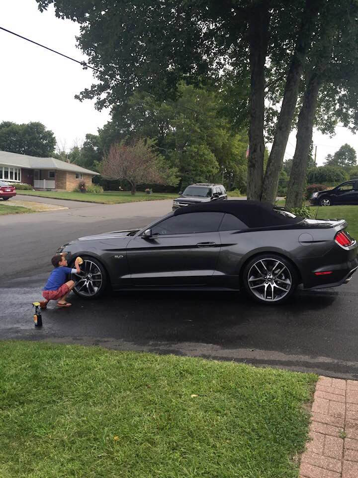

My car with min drop fronts and stock rears, the rake is even a little exaggerated because the car is pointing down hill.
Great color choice :) I'm not sure which I like more...your drop/stance, magnetic style wheels, or the fact you have a kid washing the car! :cheers:
Thanks man. He handles all my wheel/tire detailing! Someday I'll promote him to paint.
