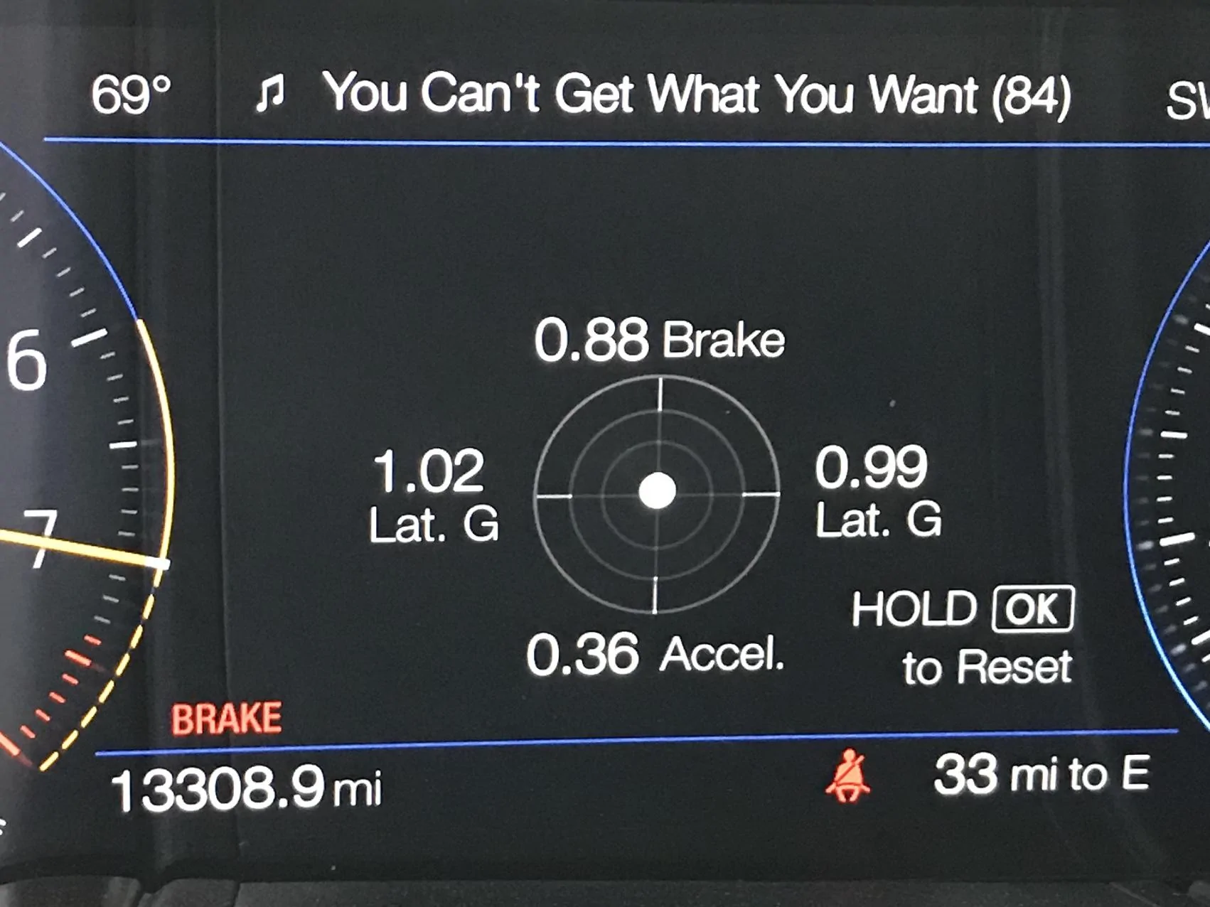

Well this convertible owner had a turbo Miata before, lol.
But most are just getting one to cruise, your an outlier. Long live us outlier's

I was cruising at the track the other day...lol.
