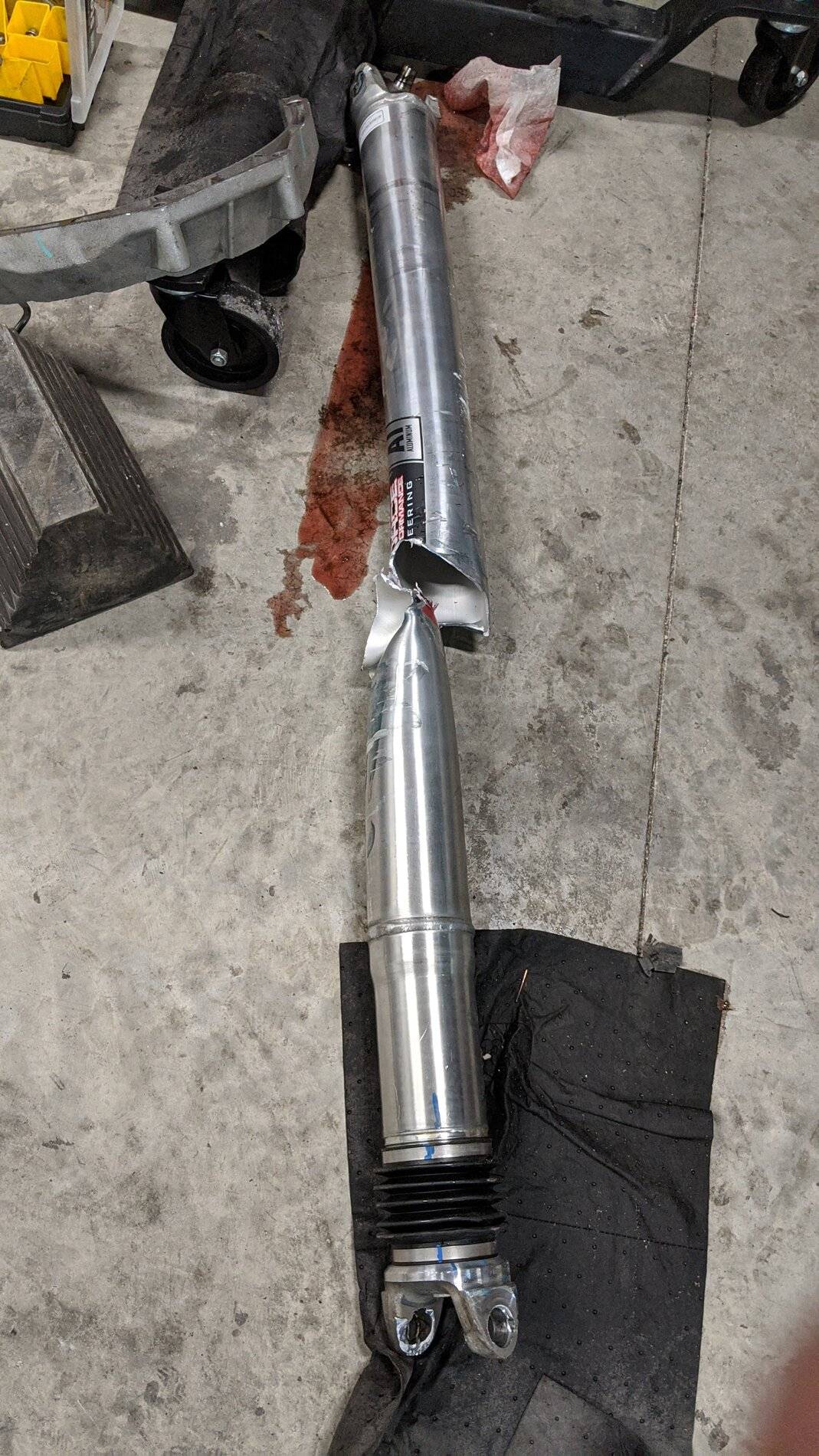

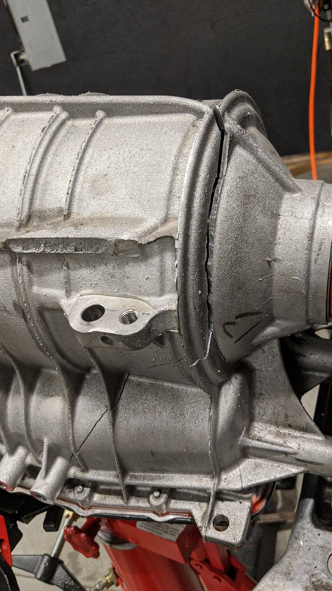

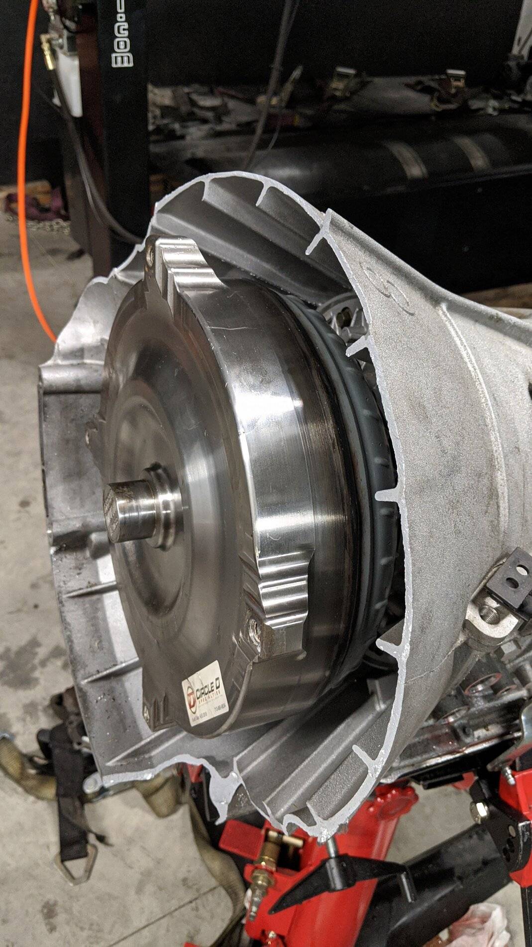

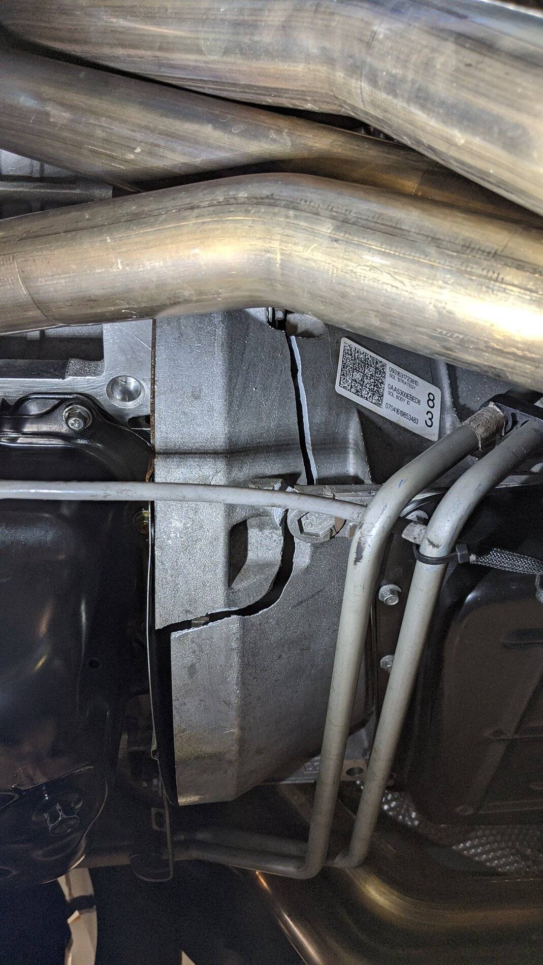

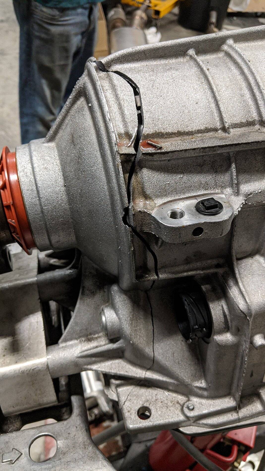

Ok folks, I got back on the dyno so PBD could dial in the id1700s with HPtuners. Same 4.38 pulley, car made 1273hp. Thats the good.... The bad is that the trans, driveshaft and diff all took a shit.... On the 1273 pull, a second after he let out BAM. Trans case split, driveshaft broke and front ears on diff broke off.

Its possible that we exceeded the critical speed of the driveshaft causing the rear ujoint to fail. Upon the u joint failing, decell after letting off makes the pinion move downward as the drum is now driving the wheels. The pinion movement coupled with the vibration of the ujoint failure led to what you see above. Glad it didn't happen at the track...

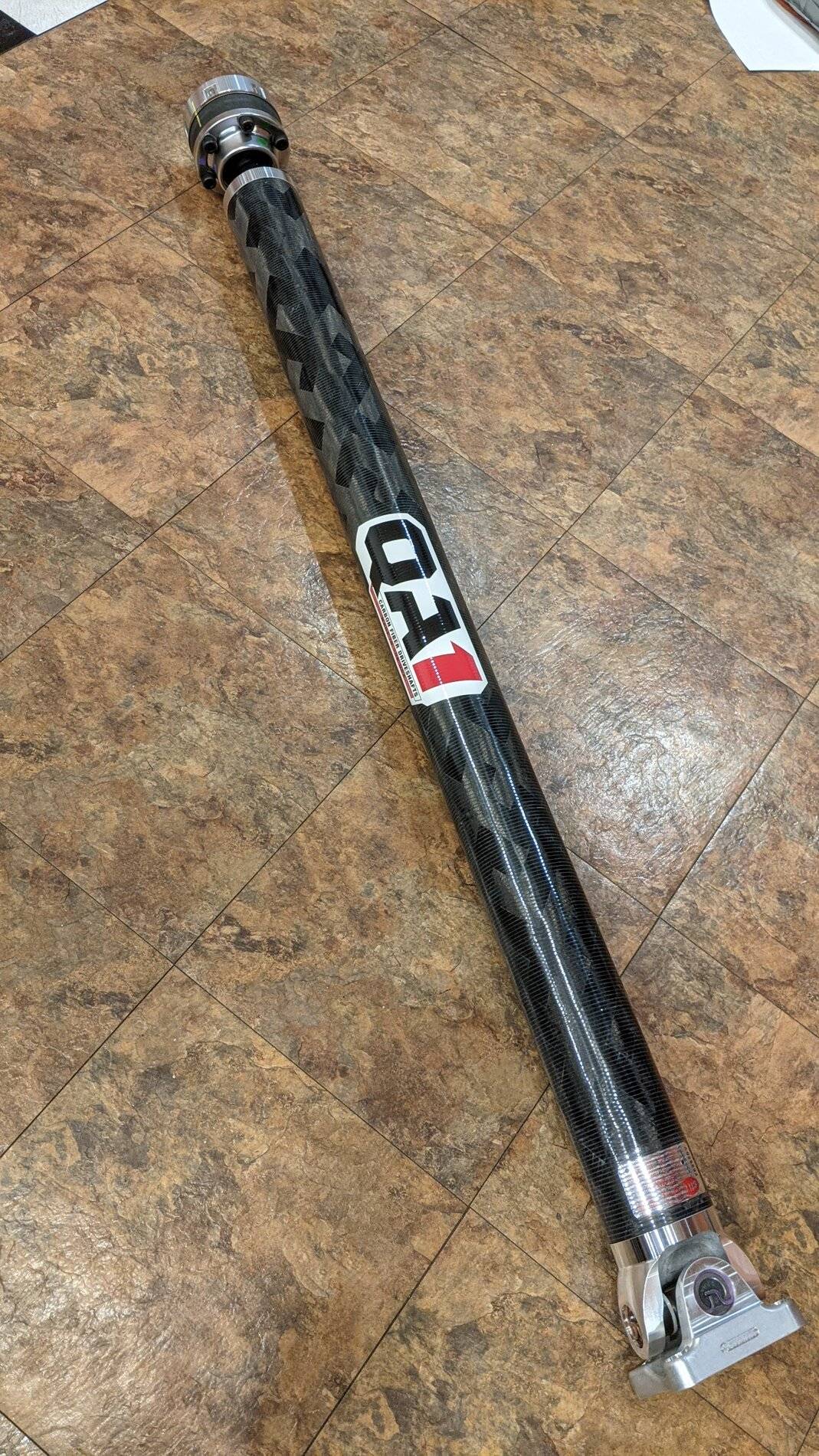

Got new shit ready for action. New DS, clutches and billet planetary. Will reuse TCS intermediate shaft and my circle D converter.

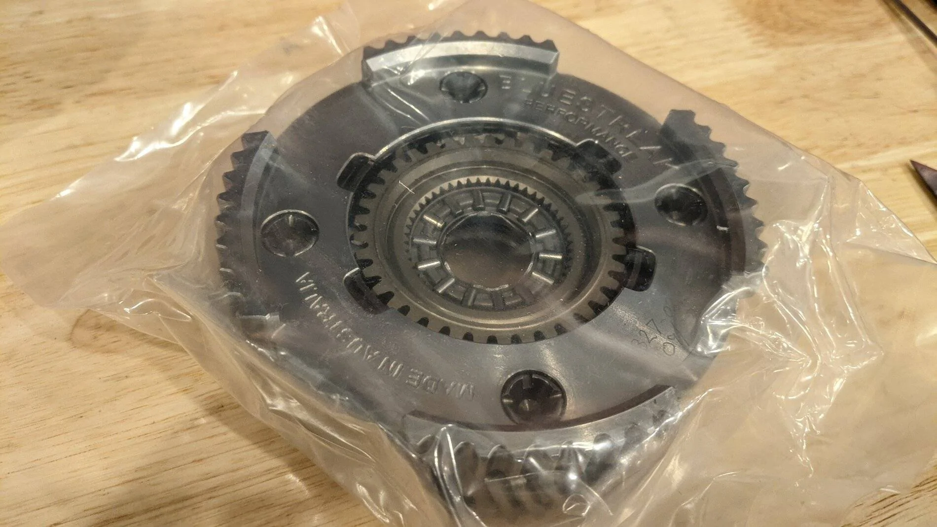

We disassembled the trans and there were NO broken internal parts.... But the new oem forward planetary we installed just a few months ago was about to fail. This had 1k miles and maybe 10 passes on it.... 800whp and up, just go ahead and get the billet piece.
