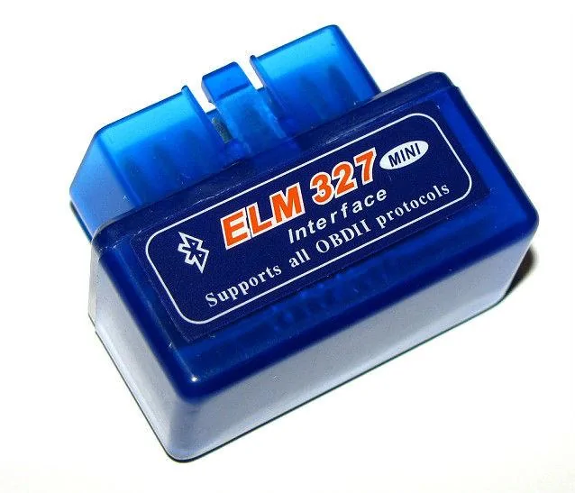

The only option I ordered was the OBD II Bluetooth adapter. It sends information to the head unit for displaying live engine data and diagnostic codes in the Torque app. A picture of it is below. I hope to get that working this weekend.
The ATSC Digital TV adapter is to watch over-the-air TV programs. The DAB+ adapter is for Digital Audio Broadcast Plus. Forty-four countries broadcast DAB+. The United States is not one of them so I passed on that one too. The DVR is a dash camera for recording the road ahead while driving. The External 3G Module is for receiving data like cell phone. I didn't want pay for that service. I'm using my smartphone as a mobile hot spot to send data to the Seicane unit. Our cars already have a back up camera that can be connected to the unit. I didn't see the need for the $99.99 TPMS (Tire Pressure Monitoring System) as we already have that system built into our cars.
