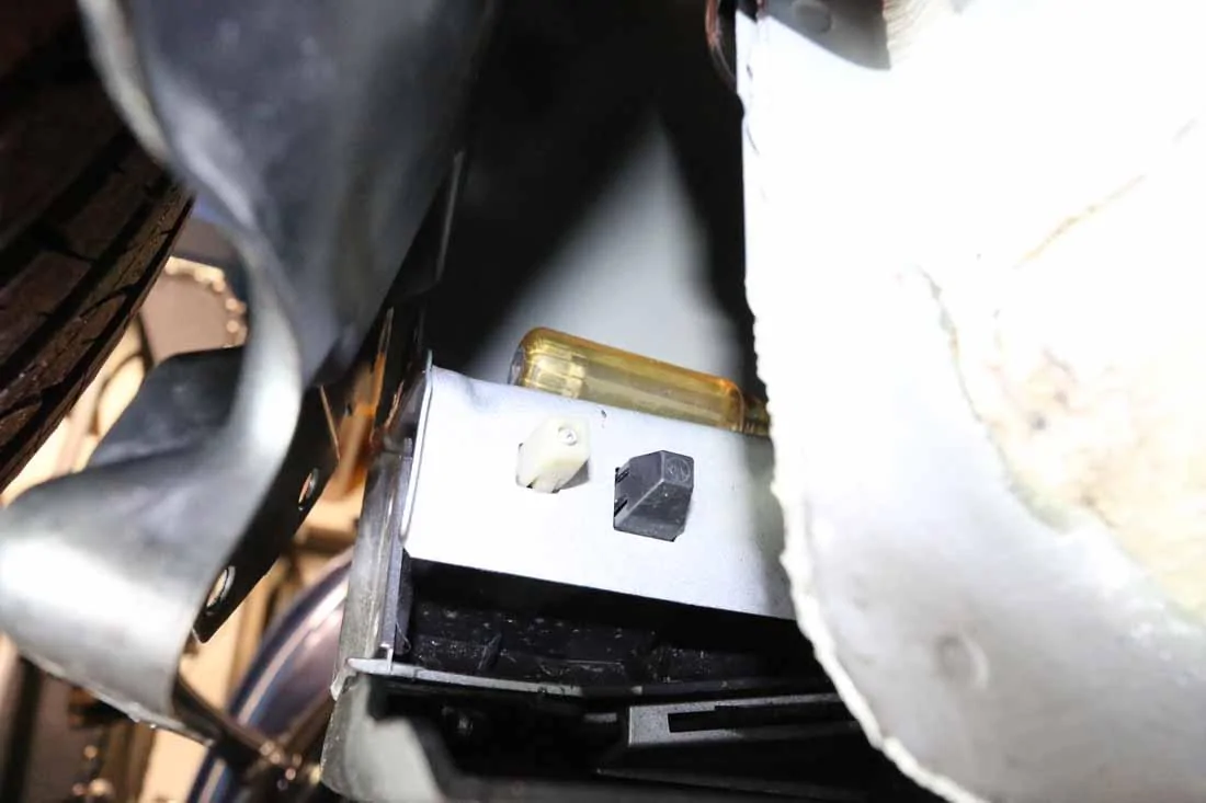

    I removed the 1/4-inch socket screwdriver handle several weeks ago. Like you said, all I had to do was remove the three push pins at the bottom rear of the inner fender and pull it back. Because the car was on a Kwik Lift I was able to be underneath the car to get to the nut driver. I don't have any push pins in the hole underneath at the rear of the inner fender. It really didn't take very long once I figured it out. Here's a picture: IMG_2989a.jpg

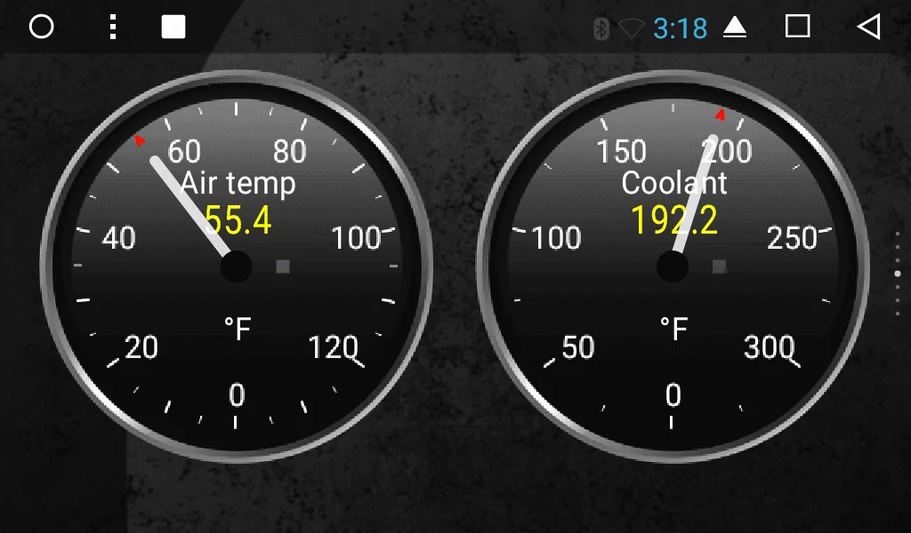

    I found an outside ambient air temperature gauge in the Torque app that reads Fahrenheit. There is exterior temperature displayed in the the HVAC window that pops up every time the factory controls are adjusted but it is Celsius.
    I deleted all the gauges that were loaded on the screen. In center area of the 7-panel screen I now have two big temperature gauges. I changed the setting so that this screen comes up when the app starts up. I will add other big gauges to the other panels that can be seen by wiping up or down on the screen. The app loads the center screen unless I can find a setting to change that. The little dots on the right side of the screen show I'm on the middle one. The task bar at the top of the screen is not normally showing. It is displayed because I used the screen shot function on a pull down menu and this task bar comes down as well. Screenshot_20170330-151817.png
