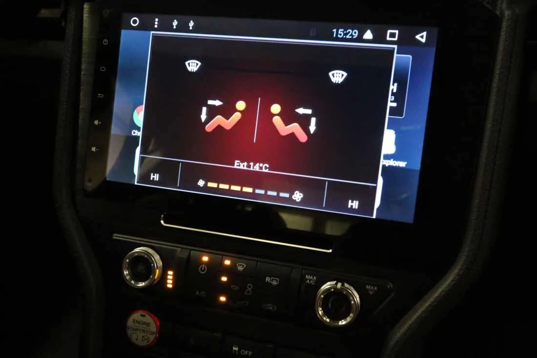

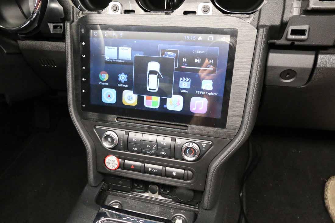

When turning on or making adjustments with the factory HVAC controls a window pops up on the screen.....Wait! I'll take some pictures!
The first picture is the overall view of the panel illuminated by an LED shop light hanging from the visor arms. The plastic protective screen cover is still on. It is staying on and the trim panels are staying off until I'm sure I'm done with the installation. The passenger door is open and that automatic pop up stays on for several minutes at least.
In the second picture you can see the "Ext 14oC" on the HVAC window that pops up every time the factory controls are adjusted. I'm assuming this means exterior temperature. I just turned on the heat in the garage and it is a little warmer than the 57 degrees F that the car is showing.
The screen shows with arrows and window icon what the controls are displaying. The defrost, vent and foot areas are on with the fan speed around medium. This pop up screen stays up for around 5 seconds after each adjustment.

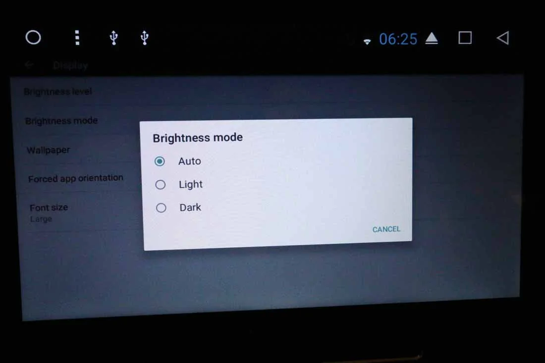

Do these screen dim when you press the +/- buttons next to the headlight knob? Also, when the headlight switch is set to auto, does the unit auto dim when it gets dark?

The Seicane screen does not dim when the +\- buttons on the headlight switch are pressed. They only control the instrument panel. It does not dim when the headlight switch is set to AUTO either. I believe that will automatically turn on the headlights when it is dark outside.

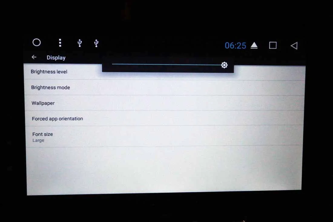

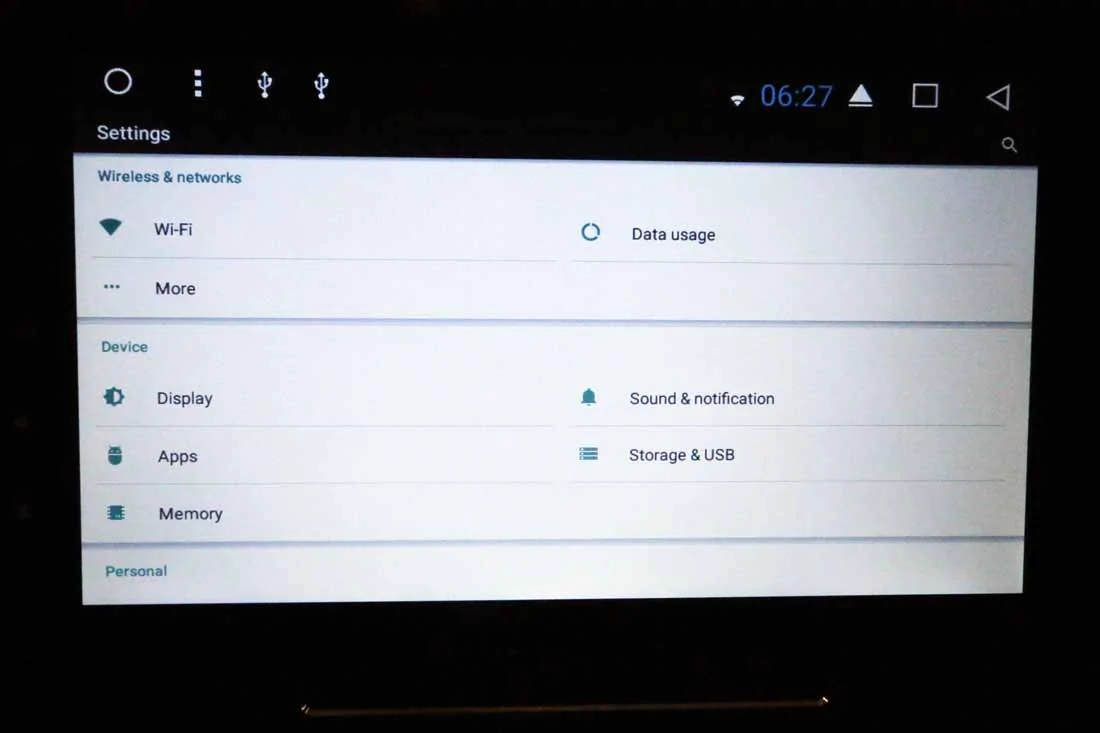

I found two ways to dim the display. The first way I found was to touch the Settings icon on the main screen to go to the Settings screen. On the Settings screen, touch Display to open the Display screen. On the Display screen touch Brightness Level and a bar with a slider button will appear. You can adjust the brightness with that.
Touch the Brightness Mode and a screen comes up that allows you to set Auto, Light and Dark. In Auto mode, when you turn on the parking or headlights the screen will automatically dim. It only seems to dim so much based on the what the Brightness is set to. It seems like the higher the brightness is set, the dimming is not as low as if the Brightness was set lower. The lower the Brightness, the lower the dimming goes. Below half bright it really gets dark. I was happy to see this dimming function.
If a person doesn't want Auto dimming, changing the Brightness mode to Light or Dark makes it stay that way regardless if the headlights are on or off.

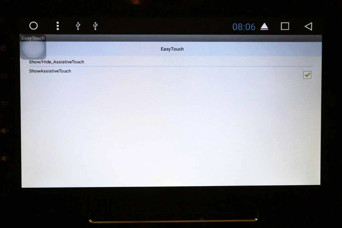

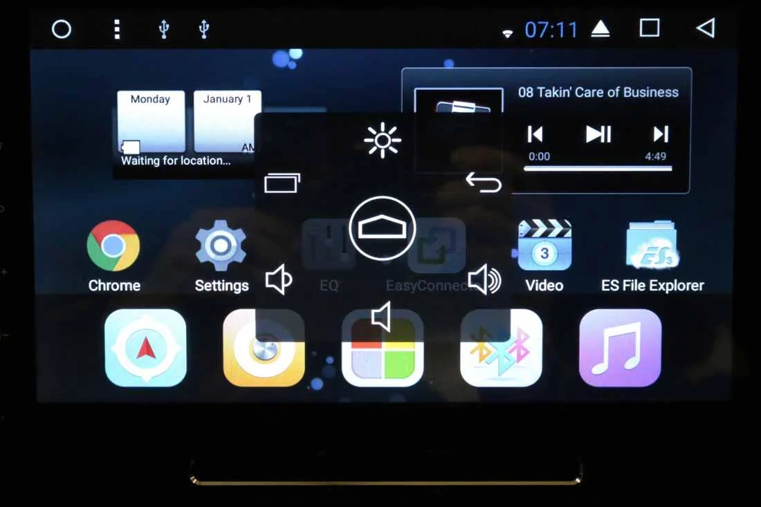

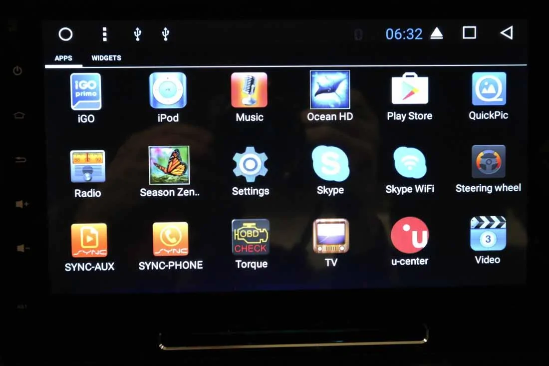

There is a function called Easy Touch. I thought it came up automatically but since I've been turning the car off and on I have to start it. To start it, touch the middle square button with four colors in row of buttons at the bottom of the screen to go to the Apps. A screen opens up with a bunch of icon buttons on it. Easy Touch is at the lower left corner. Opening that up and selecting ShowAssistTouch by touching a square box to put a green check mark in it turns it on. Now a dim round button shows up in the upper left corner of the main screen. It can be moved anywhere. Touching that will bring up a square black pop up window. Touching the icon that looks like the sun shining at the top of that screen will dim the screen. Touch it again and the screen turns off. Touch somewhere away from where that button was turns the screen back on at full brightness. Buttons at the bottom of that pop control the speaker volume. The center button goes to the home page which is already on display. The button on the upper left opens up a pop at the bottom right corner of the screen to select Wallpaper, Manage Apps and System Settings. The screen dimmer/off button is the only one I would use on this pop up.

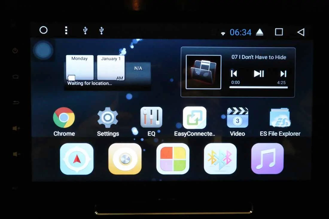

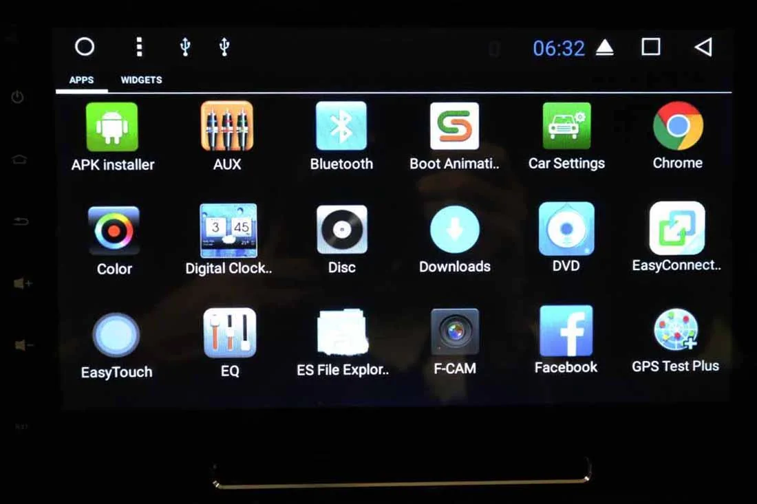

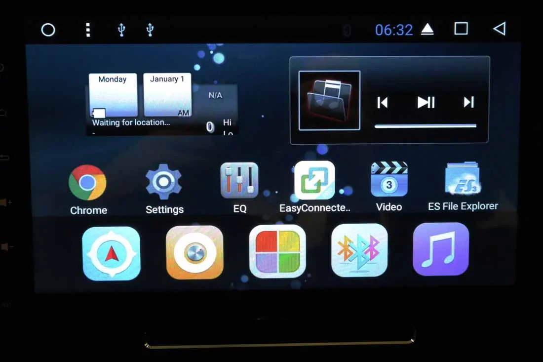

Below are pictures of the different screens as they appear in my description. The last one shows what you see when you wipe the first screen of apps to the left. There is one more app screen that has WPS Office and You Tube on it.

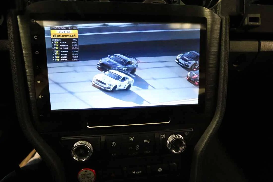

I tried to play You Tube using my home wi-fi but the signal is not strong enough for video in the garage. I then set up my Samsung J3 phone to be a wi-fi hot spot. I was able to play the 2017 IMSA BMW Endurance Challenge race at Daytona in 720p60HD. The picture quality is excellent. There is a loss of quality when photographed. The screen shot below shows the Mustangs leading the pack to the green flag at the start of the race. I never thought I'd be watching Mustangs racing at Daytona on You Tube while sitting inside my Mustang! This means I will have wi-fi anywhere I have Verizon phone reception. :thumbsup:
