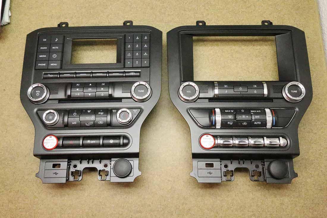

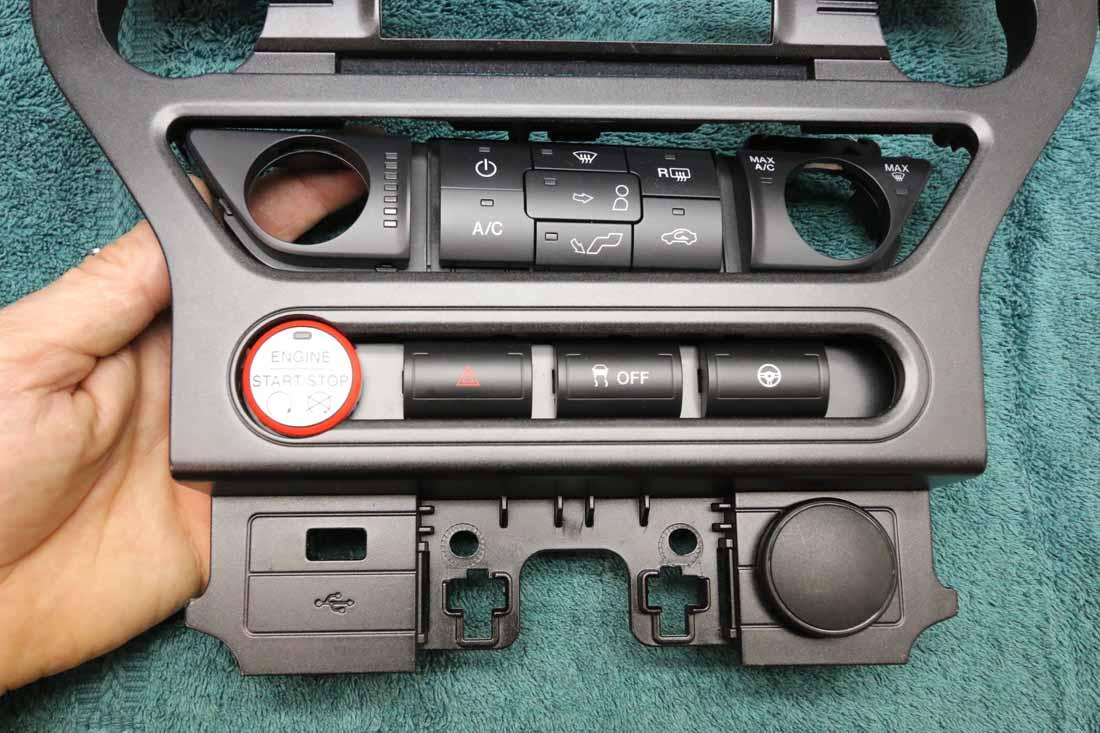

    Yes, if you are talking about the Secaine unit it only fits the base model. It took them awhile but eventually they put a picture on their web site stating that it does not work with the Premium radio. That is probably because the Premium bezel has an extra toggle switch along the bottom. The Secaine panel is built to use the base model buttons along the bottom and HVAC control panel. There are more buttons on the Premium bezel. When I had both bezels apart I tried to put the premium switches and HVAC button panels in the base bezel. The buttons fit but the HVAC control panel was little shorter. Then there's the problem of both bezels having completely different circuit boards on the back. They just can't be transferred easily if at all.
    I actually bought a premium bezel off eBay back in December before I bought the car. After extensive research here on this forum I was considering doing a factory Sync 3 upgrade or trying to install a double-din unit using the Premium bezel after I bought a V6 base model Mustang. I was not going to buy the car if I couldn't upgrade the stereo. After I bought the car in January the Metra and Scosche units started production. Then when I saw the Secaine unit I knew I had to take a chance on that. It is almost unbelievable how many options have become available for upgrading the stereo/navigation since I first starting looking in December last year. I still can't believe how good the Secaine unit looks and works. It is more that I would have dreamed possible when I first starting planning a stereo upgrade before I bought the car.
    The second picture is me holding the base model panels in the premium bezel. One of my ideas was to use the premium bezel with base model controls to install a Kenwood head unit. The panels kind of fit but I'd still have to use the large base model circuit board which would not allow the installation of the head unit without cutting it and then it might not function. I was desperate and it was was a gamble to see if it would work. Thankfully the Secaine unit came along. IMG_2816a.jpg IMG_2873a.jpg

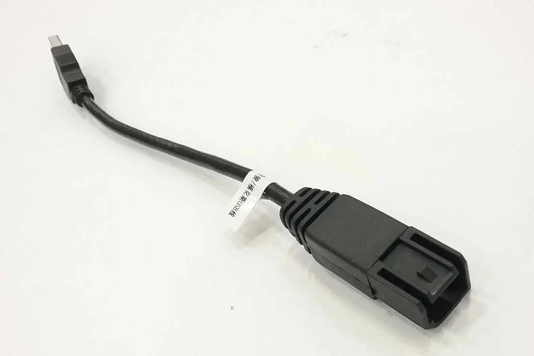

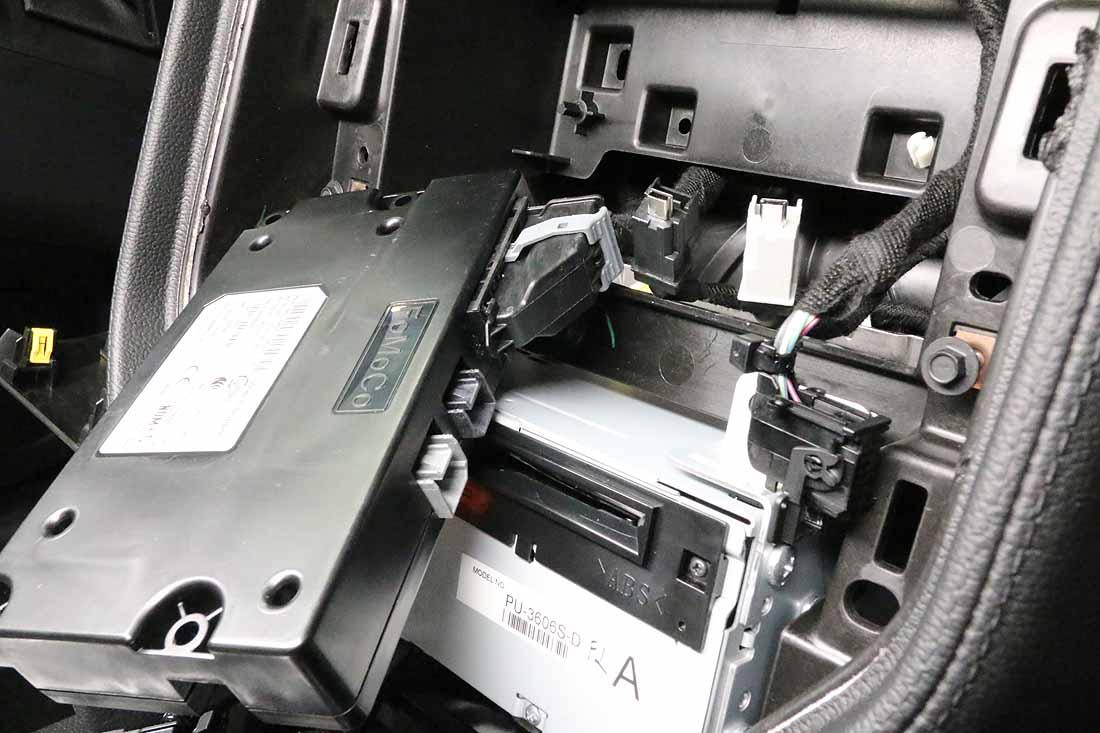

    Good question! I've been meaning to post a message about this.
    The adapter that came with the Secaine unit plugs into the black colored jack on the factory Sync box. It will not plug into the lighter colored one. The angle at the corner of the jack is on the opposite side.
    Connect one of the USB cables on the head unit to the adapter and you will now be able to use the front USB jack under the start button for data transfer and charging. I ran the other USB cable into the glove box.
    The rear USB jack in the storage area under the center console arm rest will have power to it for charging devices but it will not read data.
    Here are a couple of pictures showing the jacks on the Sync box and the Secaine adapter. IMG_2808a.jpg IMG_2809a.jpg

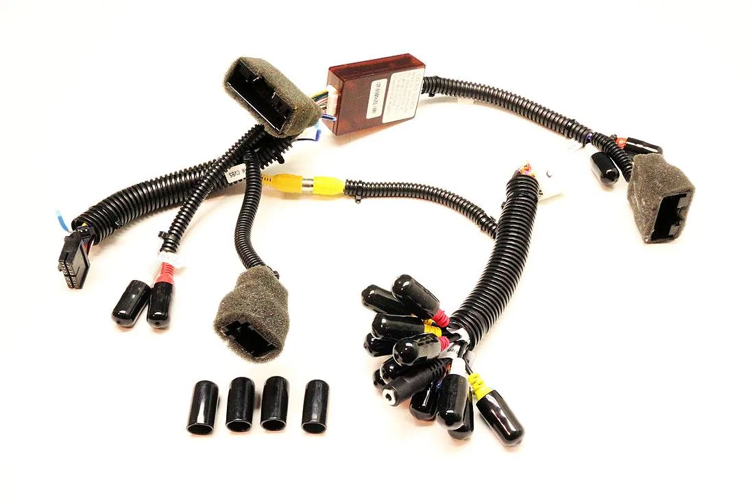

    Another thing I did was cover all the wires on the Secaine wiring harness with split loom tubing and secured it with cable ties at each end. There are a lot of sharp edges on the metal supports under the dash. I didn't want to take a chance on a cut through the wire insulation and having a short circuit.
    I also put plastic caps on the 15 RCA jacks that I didn't use. Again, I didn't want any short circuits. I bought the thread protector caps from MOCAP off internet. They are the RVCC9022-20 black round vinyl 7/16 (.437) inside diameter x 1-inch long. I had to buy 100 of them for $28 so I have some left over for other projects.
    Here's a picture of my harness: IMG_3029a.jpg

    The bezel on the eBay and Secaine units is for the base model push buttons and heater controls. I posted pictures in a message above showing both factory bezels. There are four push buttons at the bottom of the base model bezel for engine start, emergency flashers, traction control and steering. There is a bar between the three rectangular push buttons on the bezel. The premium has four toggle switches in this area and will not fit. The heater controls and circuit boards are different as well. These units definitely are for the base model Mustangs only.
