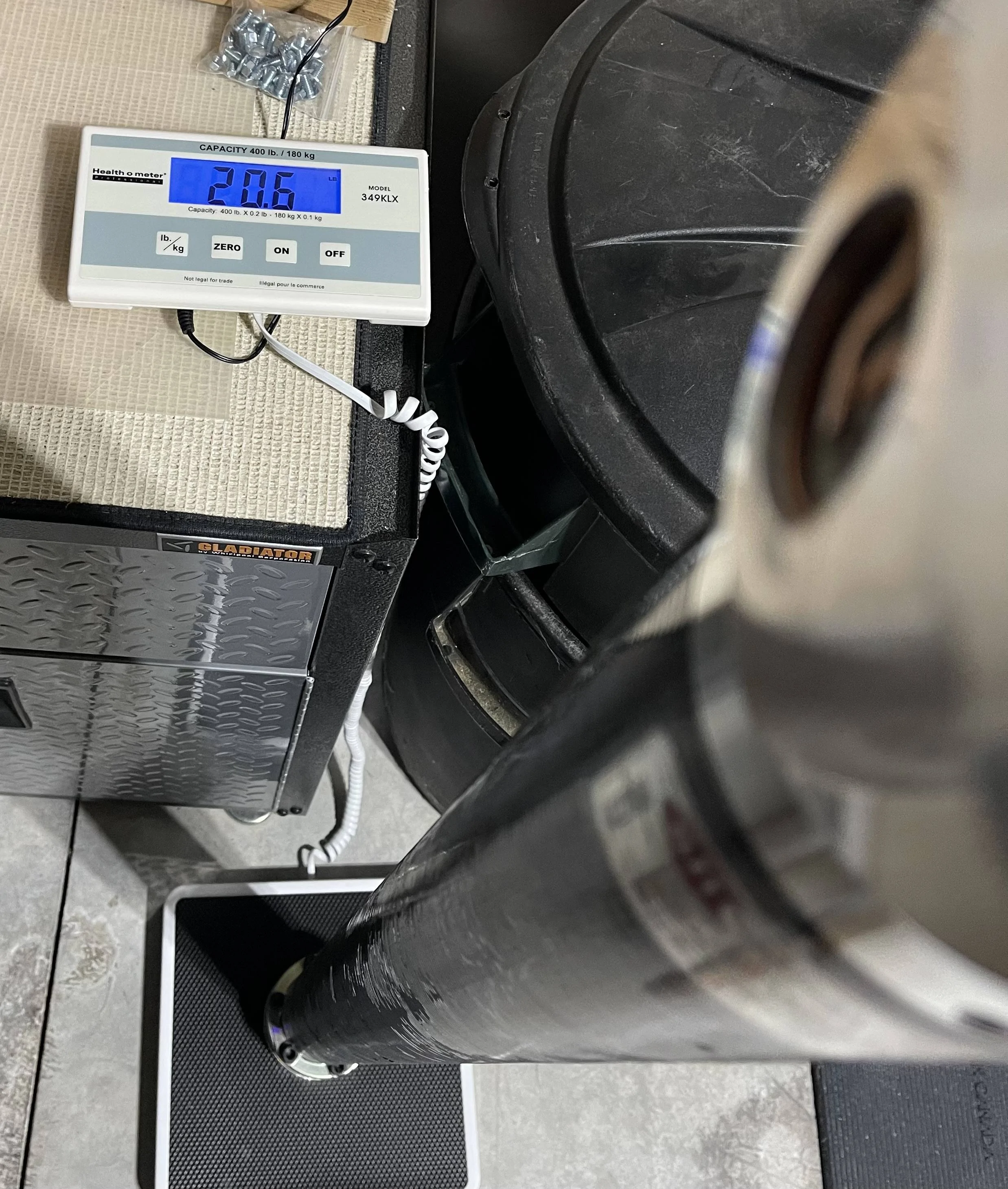

Yeah, that doesn’t seem right to me either. I’ll verify here in a couple weeks. Im about to order the QA1 for my M1. I’ll weigh the new ds as well as tge 2 piece and the bearing when I remove them.
Good deal. The "how much do things weigh" post and a few other postings have always listed the 10r80 stock DS as around 29lbs. The MT82 DS showed to weigh more at 36.2lbs.

I have debated getting a QA1 for my car. With the stock 10r80 DS weighing 29lbs and the QA1 CF weighing 23.5lbs, I'm just not sold on the potential improvement vs the cost. If I were needed something stronger for FI, this would be my move.
Do you happen to have any before/after acceleration data?
No, I don't. That was merely my unprofessional analysis.

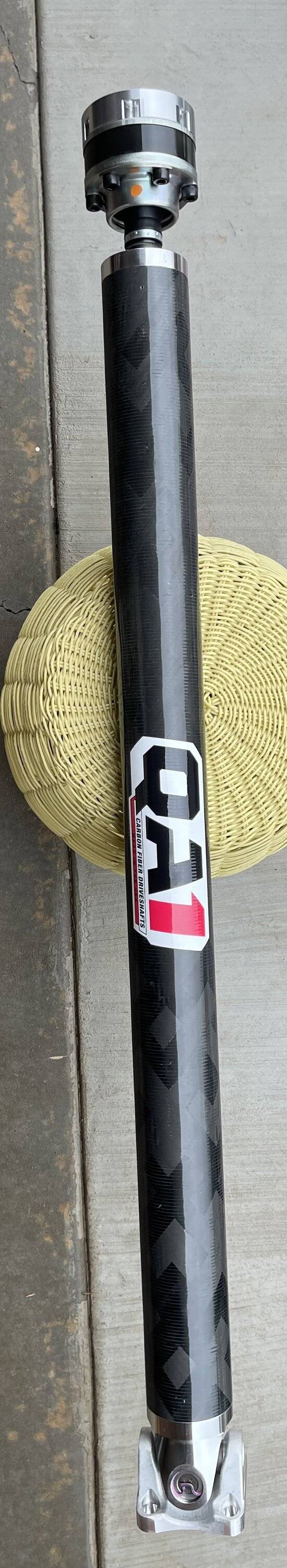

Works like a champ! So much lighter than the 2 piece anchor and carrier bearing. The QA1 isn’t cheap but it’s been one of my favorite mods. Car feels more instantaneously responsive.

I second this evaluation of the QA 1. I also have it in my 2022 Mach 1. Still breaking in the car (only 400 miles), but love the way it handles and no Noise, Vibration, or Harshness (NVH). Weight reduction is significant over stock. I must confess though, I also have additional weight reduction from my brake rotors and forged rims, so my reduction in rotating mass will be lower than just installing a carbon fiber drive shaft.

I don't have a Mach 1, but I'm my car the driveshaft was most certainly the one mod that is a must have. The difference was just so therapeutic to the acceleration. I have light weight forged rims also. The QA1 driveshaft is really nice. I would buy another without hesitating if needed.
