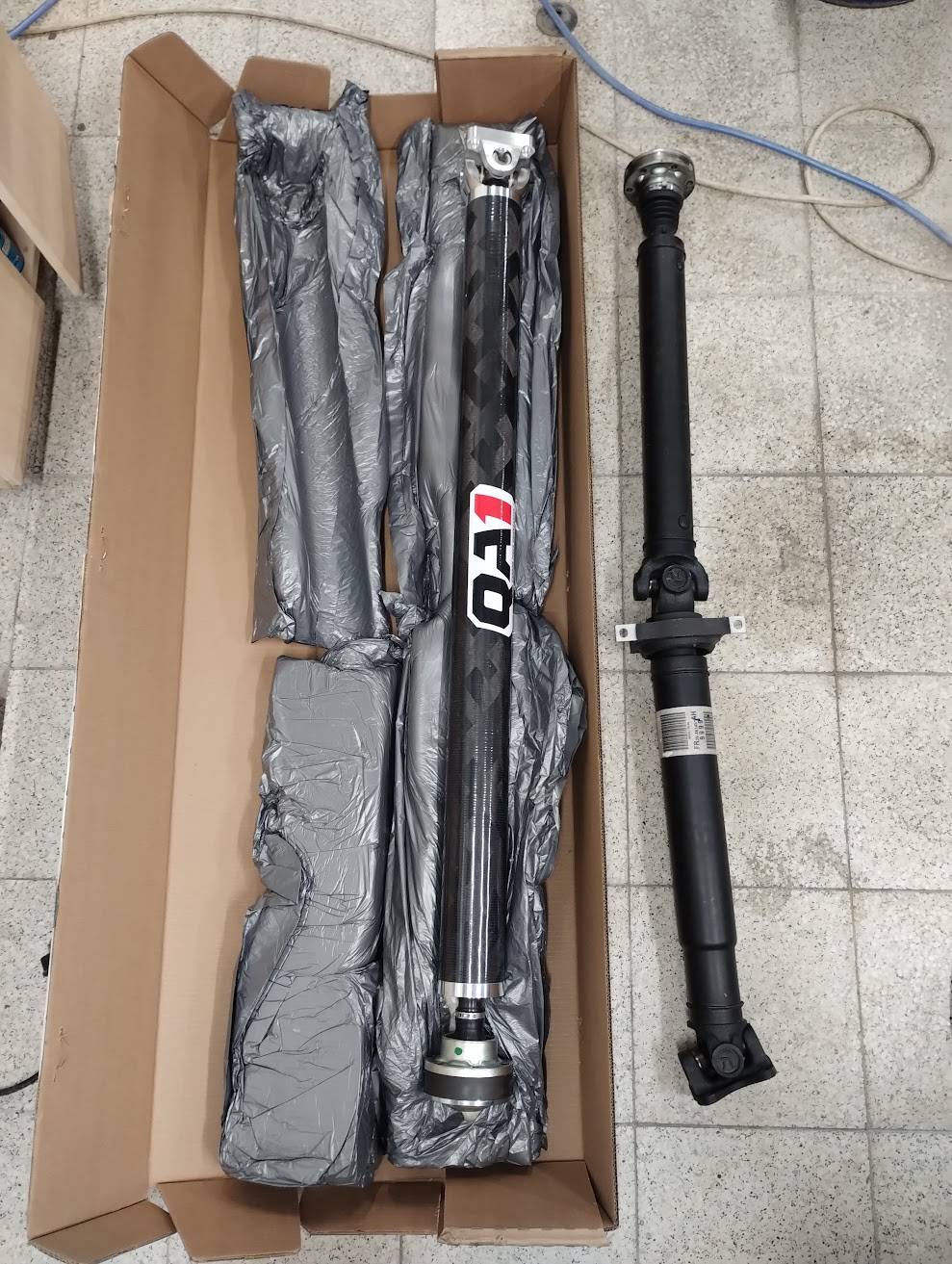

I finally got around to installing the new shaft and am happy to report that everything also fits the European version of mach1. NVH may be a bit higher at WOT, but mainly I have fixed the problem with the original shaft which made a ticking sound at about 50 km/h (no sticker). Overall, I'm very pleased with the result
