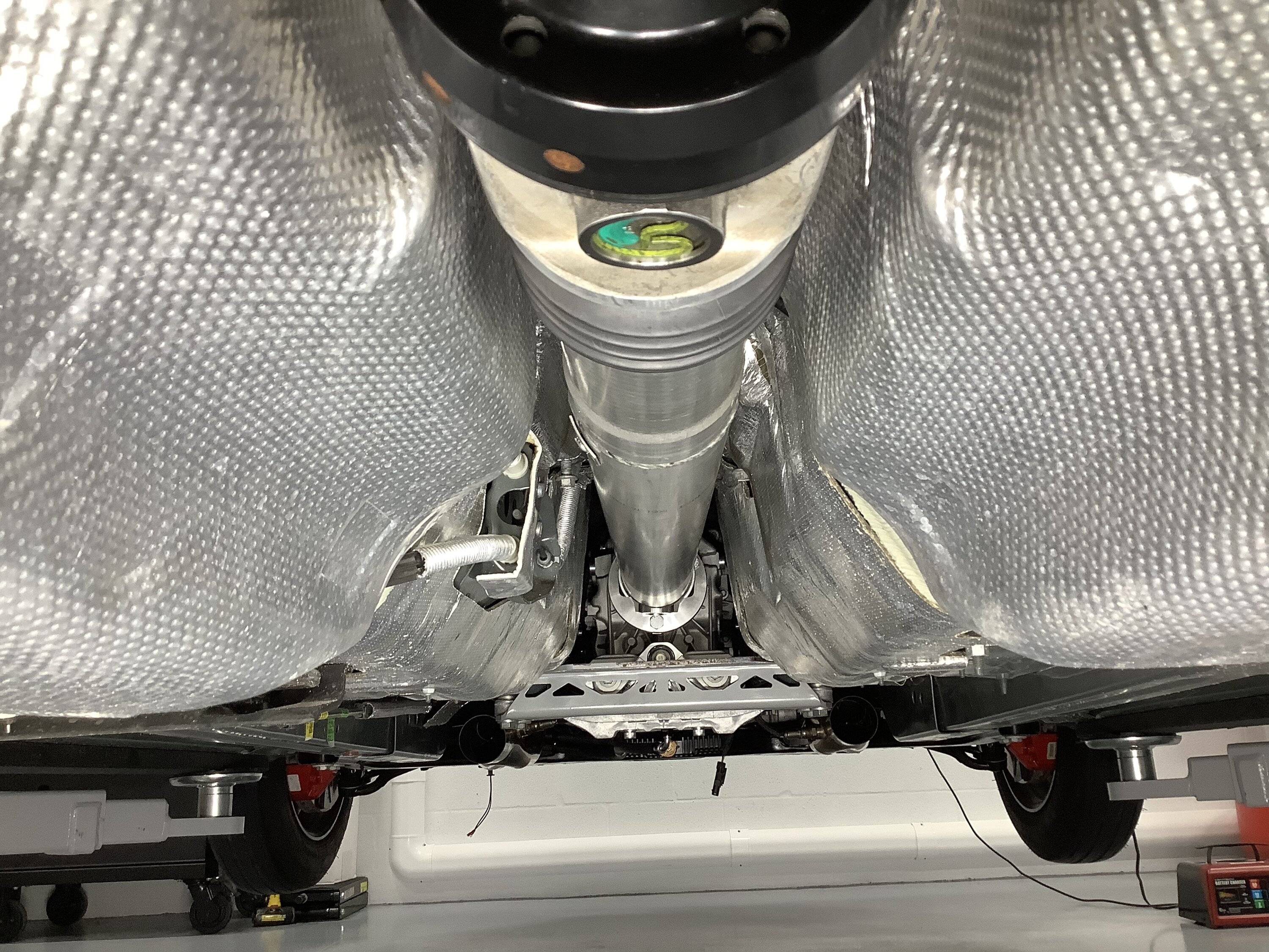

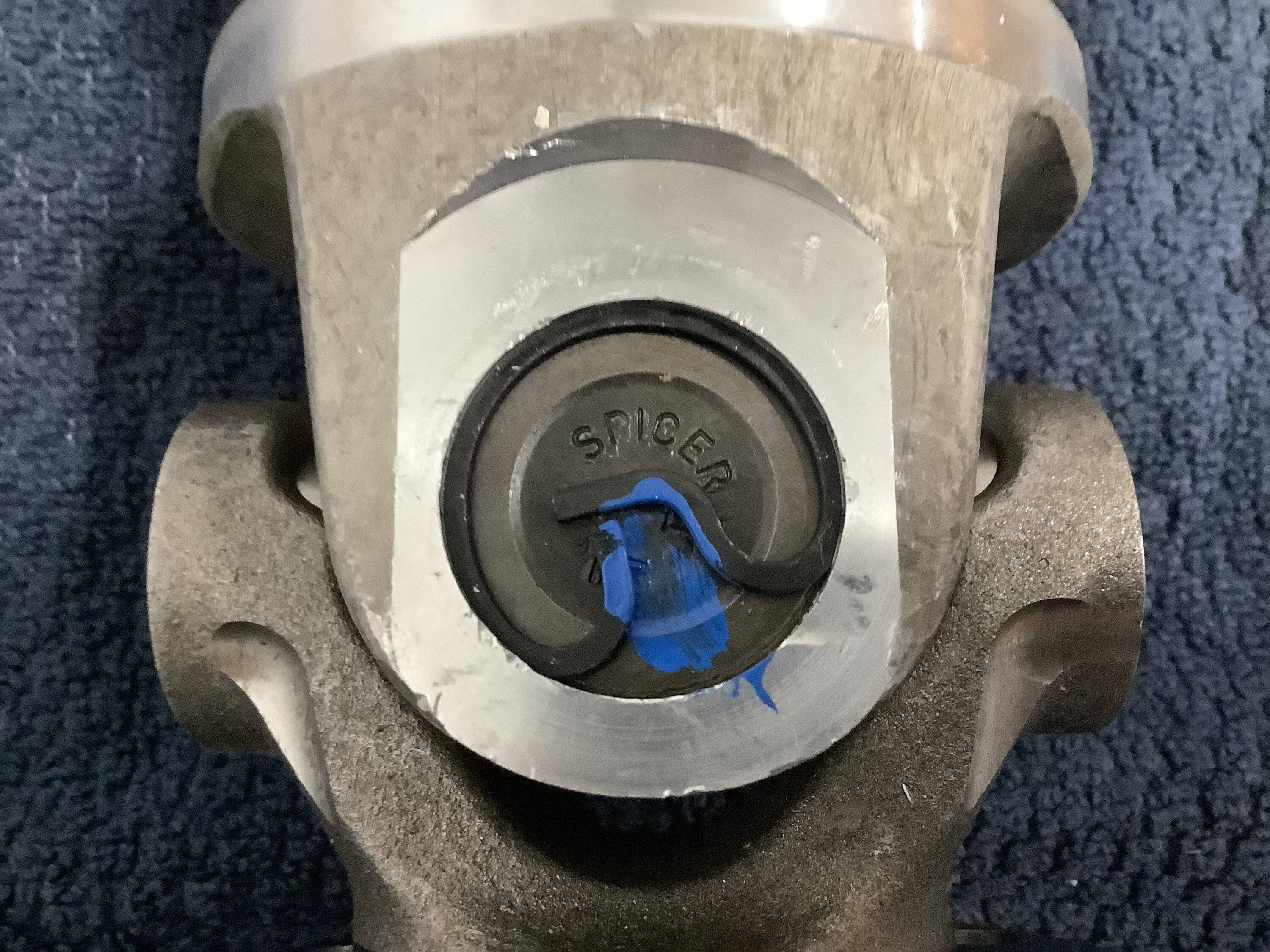

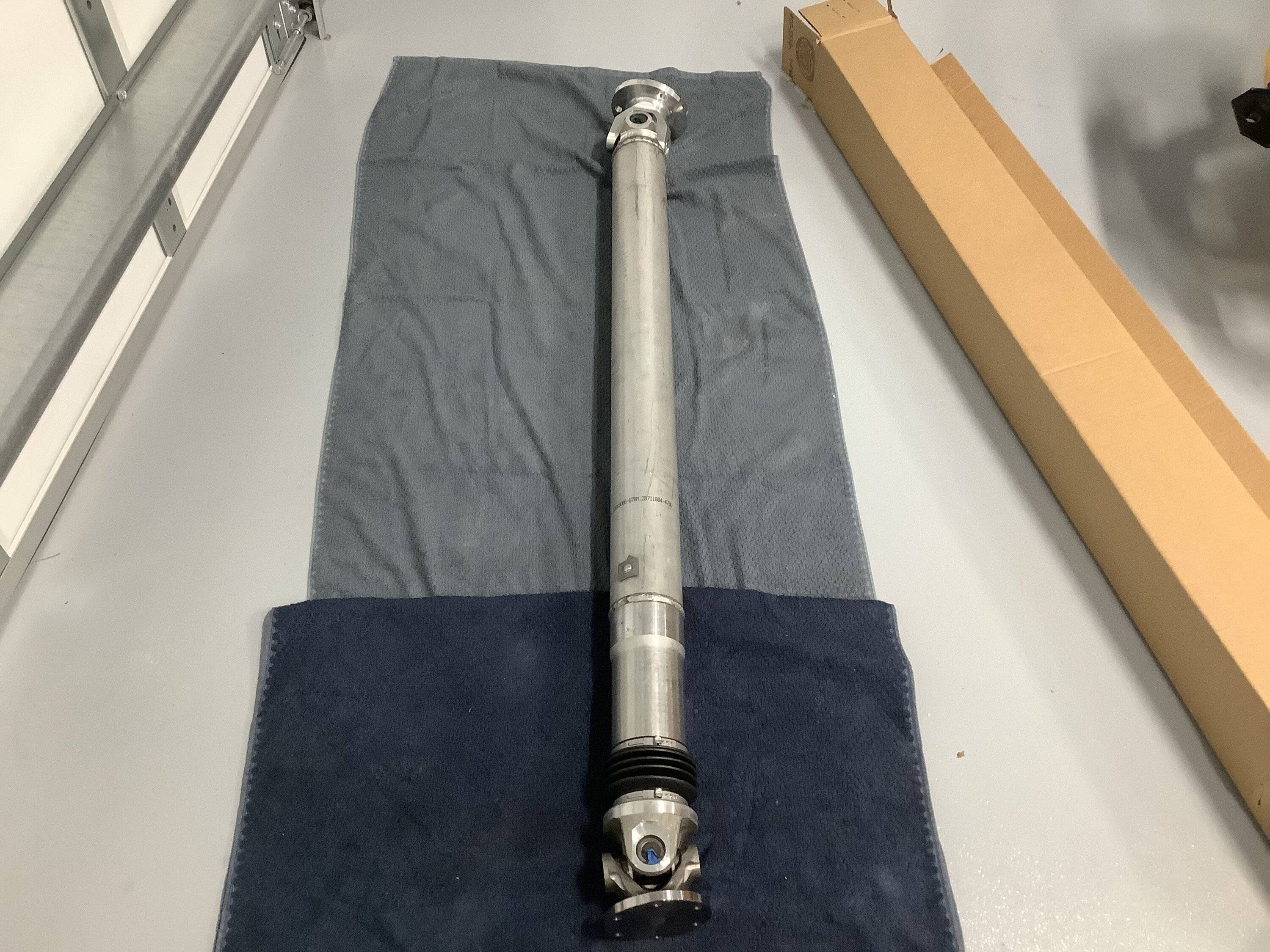

I‘m not sure if Steeda offers an aluminum 1 piece ds for the M1 and GT350, but if they do, I can attest to the quality being top notch for my 2019 Bullitt. There’s no vibration or noise at all and it’s as smooth as glass. I believe it is made by Spicer for Steeda, as mine has Spicer components on it.
It may be worth a call to Steeda and/or Spicer if you don’t see one listed on Steeda’s website.
Looks like a Shaftmasters Driveshaft
Now that you say that it does, but when I contacted Shaftmasters a while ago, they said they were no longer building a ds for the 2018+ cars.
