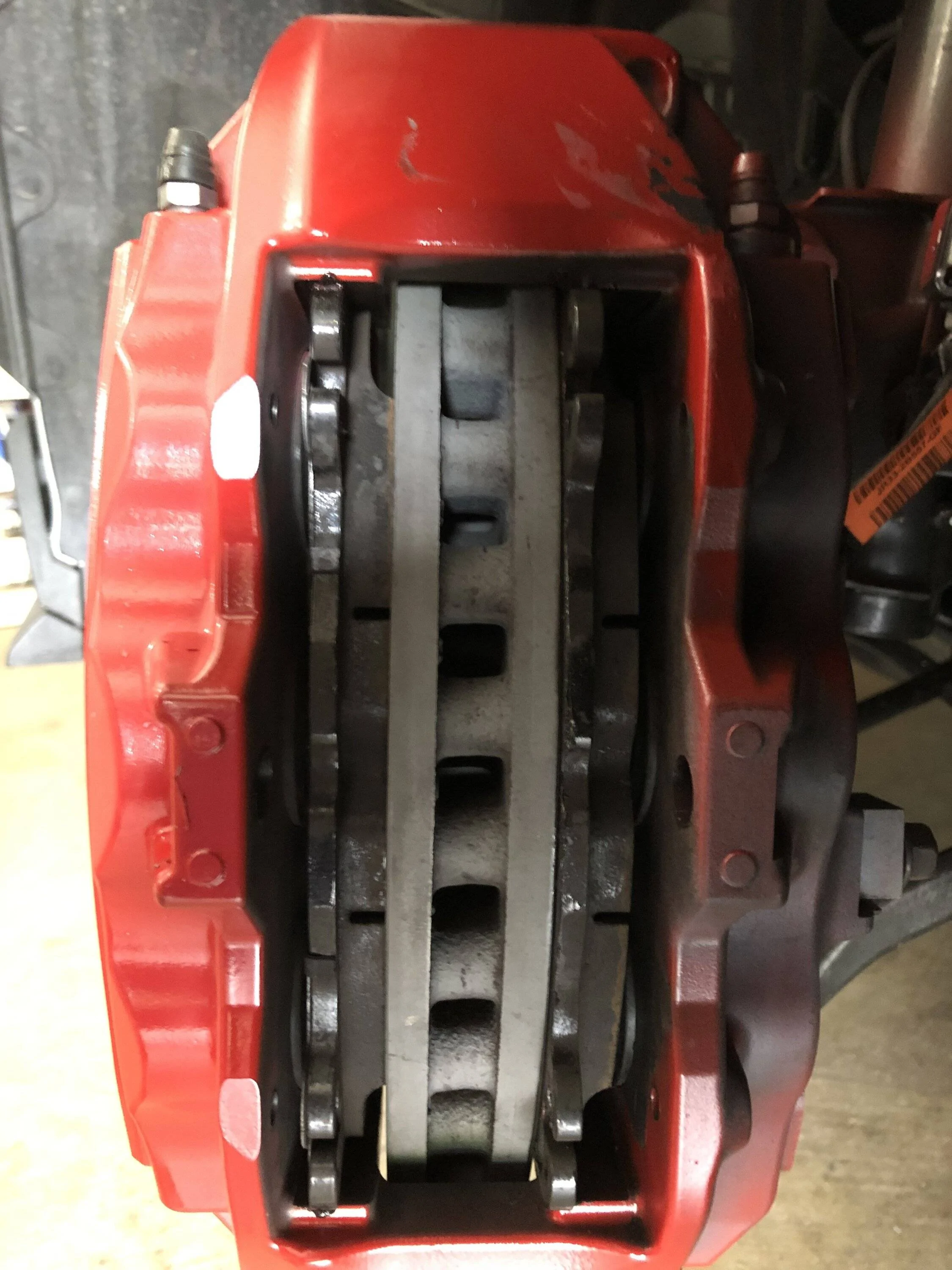

I have been running Z26 in the front for quite a while now with no issues, but I did have a problem at original installation, heard a lot of racket and eventually figured out what the problem was… Hard to imagine this could possibly be your issue, but just throwing it out there.
