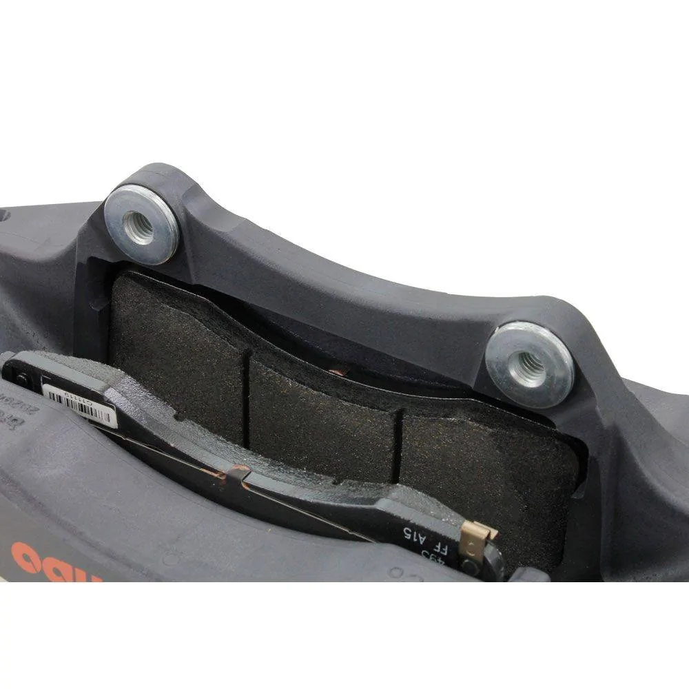

Not sure about the GT500 brakes, but on the GT 6-piston Brembos you need to ensure the brake wear indicator/squealer is on the outer side of the caliper. If its on the inside, it can come in contact with the inner caliper housing and cause the inner brake pad to bind unevenly against the rotor.
Not sure if that’s your issue, but something to check.
