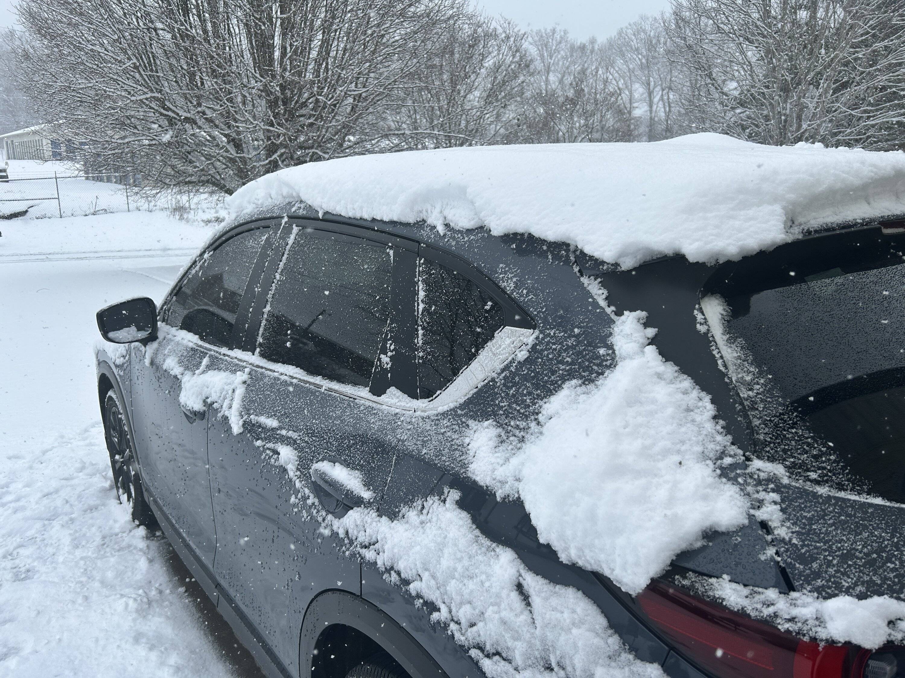

What my Mazda looked like before I went out Tuesday as I was cleaning off the windows before driving :) very unusual again for East TN

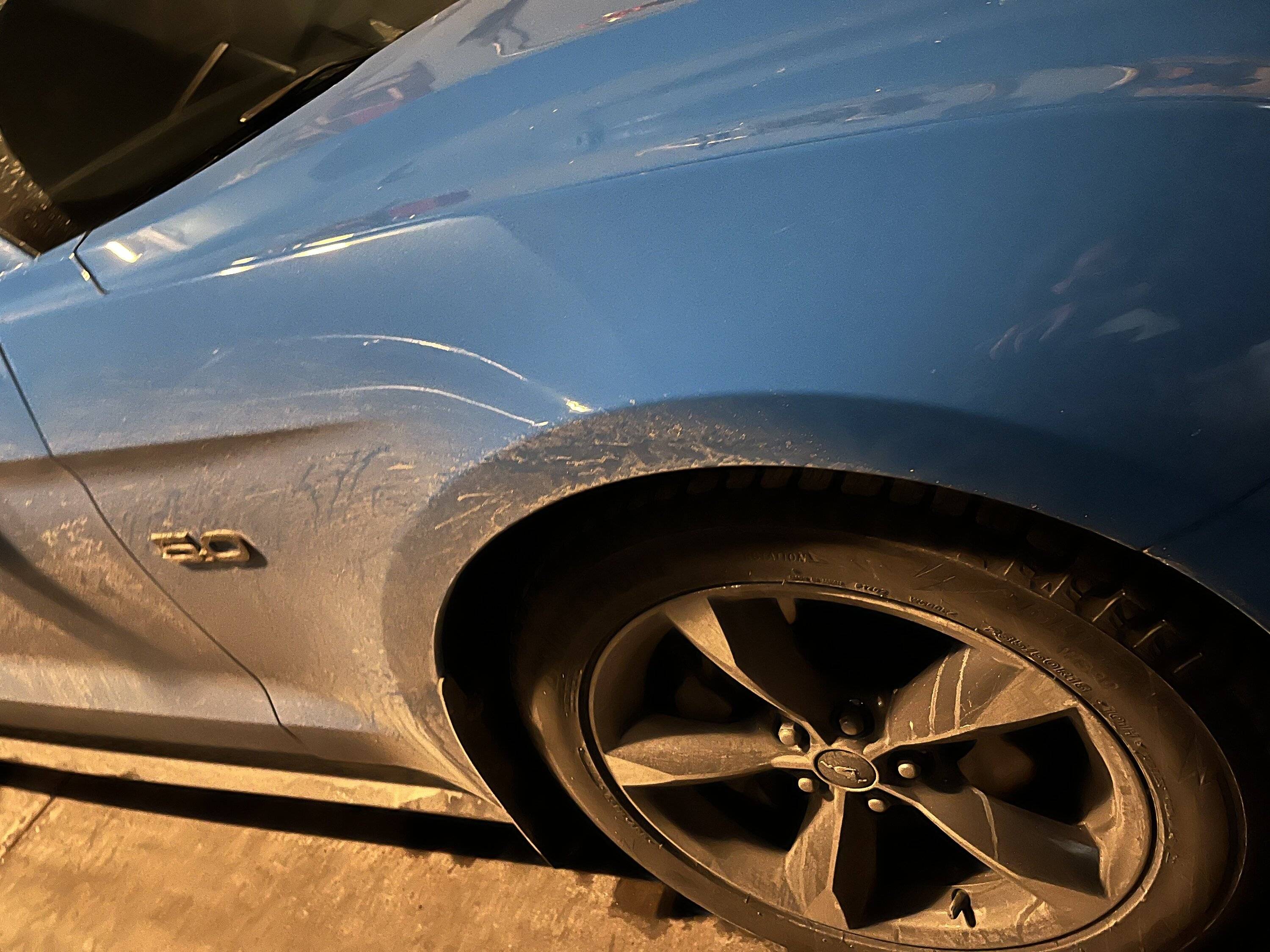

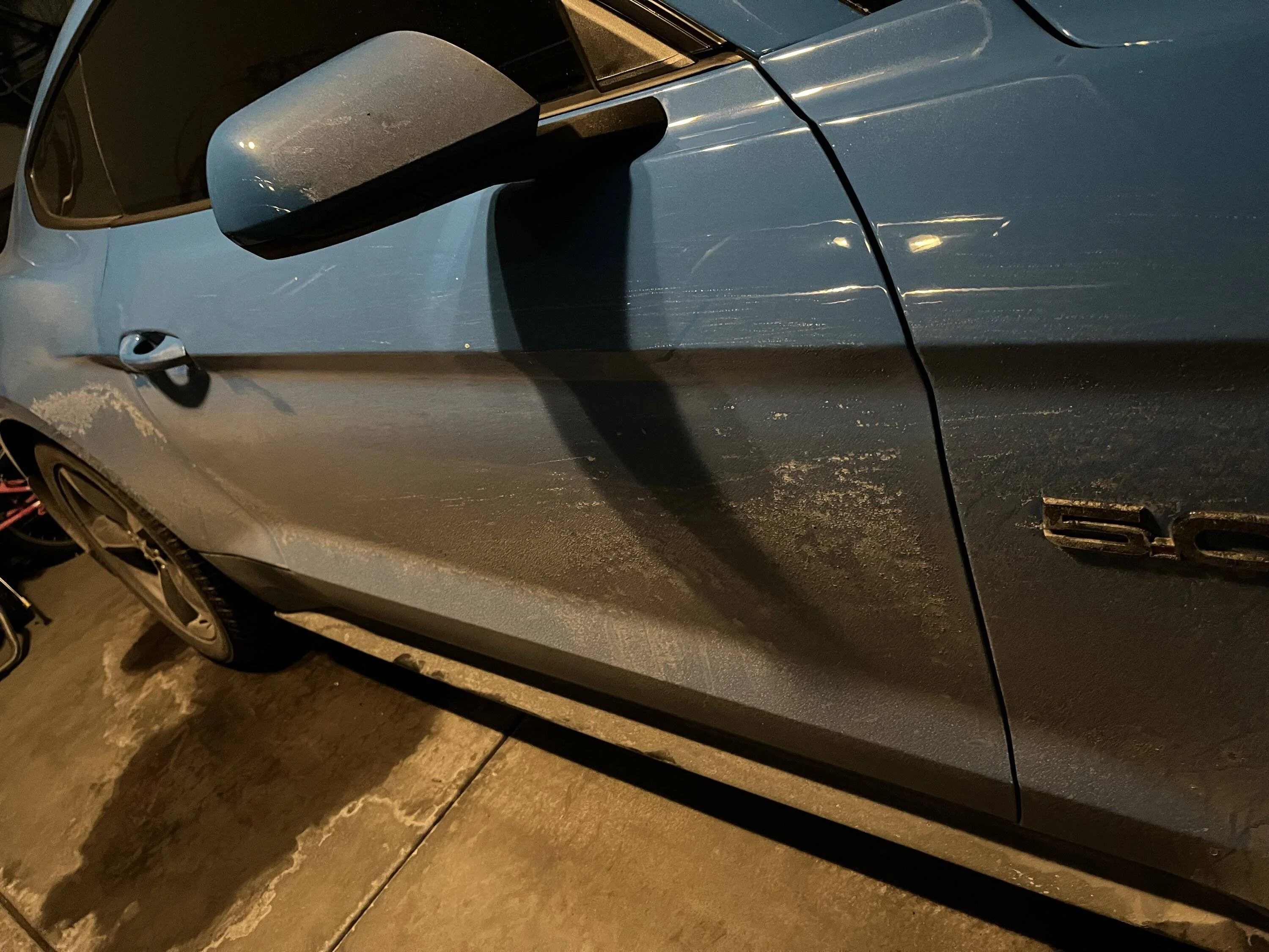

I’m almost embarrassed to post these pics but this is about 2 weeks of salt. Unfortunately we haven’t been above 20F since last Friday (01.12.2024). Finally going to be above freezing starting tomorrow and we have rain in the forecast most of the week. So that will wash off some of the salt on the roads and I’ll be getting to the touchless wash this week as well

Man that makes my heart hurt to see a beautiful Grabber blue stang look like that :( I am so thankful mine can stay inside for bad weather
Yean that is my plan too, rain forecast Wednesday thru Friday, temps above freezing all week starting tomorrow afternoon . Gonna take my smaller IK foamer with APC mix with me to work and stop at a spray wash if I can mid week to get some of the worst off then tackle full bore Saturday. After my full scale assault getting the salt off with APC and pressure wash, I think I am going to spray DIY detail Rinseless on the paint and drive home to keep more grime from sticking, then do a full rinseless at home and dry off rather than doing a full soap contact wash. My biggest problem is my garage is 1 bay and the Stang is asleep there. Planning on doing a carport eventually off the right side of my garage for my daily.
And yes, this was last Wednesday morning, a shock to the system for us here :(

Oh believe me I’m losing my mind that I haven’t been able to get that salt sprayed off LOL. We had a 3.5 day stretch starting last Saturday night where we never got above 0F and it was in the single digits the rest of the week. Finally got into the teens yesterday and today, felt like a heat wave LOL. But, at least for me, I’d much rather drive my car every day instead of walk past it just teasing me for 4-5 months every year. It’s a trade off for sure but one I’m happy to make right now. The cold starts when it’s really cold are so loud and glorious , it makes me forget about the salt for a few seconds 😎

IMO, there’s no point in trying to get that off until your roads are semi-clean… because as soon as you do get it off, your first drive with traffic will end up looking like it is now, full of salt and road debris.
We usually take the cars to the local car wash self serve bay at night. We go at night since there is less people that will be there (if any at all) and less traffic slinging up salt in front of and around us. It’s best to go with two people because if temps are still in the freezing range, by the time you get to do the bubbly, it will have froze on ya…. So one person does the wand, the other does the wash/bubbly. Bring a bucket and your sponge/microfiber/soap. Use the self serve car wash water wands to throughly soak the car, do the bubbly, then again use the wand to thoroughly rinse.
DO NOT EVER USE THE WAND BRUSH ON THE BODY OF YOUR VEHICLE!!! Those things are used by muddere/contractors/4x4 folks who use the brush to remove all sorts of road debris/mud/muck. You’ll scratch the shit out of your ride if you use that wand brush…. That is why we bring our buckets/sponge/microfibers.
Just rinse everywhere including shooting the underside of the vehicle - go home.
If temps are in the 30’s and below, you’re not going to be able to hand dry it, because the then thin level of moisture will instantly turn to ice. Maybe if you have a hand held battery powered blower, you can blow most of the water away before it freezes.
Wait until temps break where you can do a better wash/dry.
