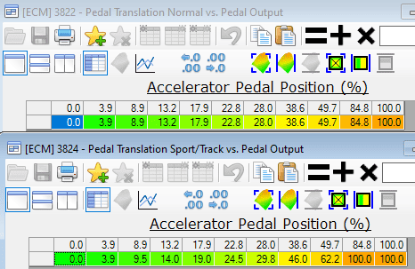

As mile has shown it's there. If remember correctly there is a way to test it. In neutral hold the gas a bit at a steady rpm then switch to sport and the rpms should rise a bit. This is exactly what the snake oil pedalboostercommandermax does. Look how in sport mode it reaches full throttle and 84.8 percent. With the snake oil box people are turning it up even higher reaching 100 percent even earlier in the press thinking their cars are faster or removing non existant lag. Why would anyone like that? Maybe I can just sell a button to replace the pedal so people can go from 0 to 100 with nothing in between. Who needs all that lag in between.
I dont have my mustang anymore but I have a 5 star tuned f150. The initial racing tune had the crappy feeling pedal so I got a revision to make it 1 to 1 and its ten times better I get much more precision. If you know anything about high end audio you will learn people throw away tens of thousands on products that either do nothing or actually measure worse on basically snake oil.
