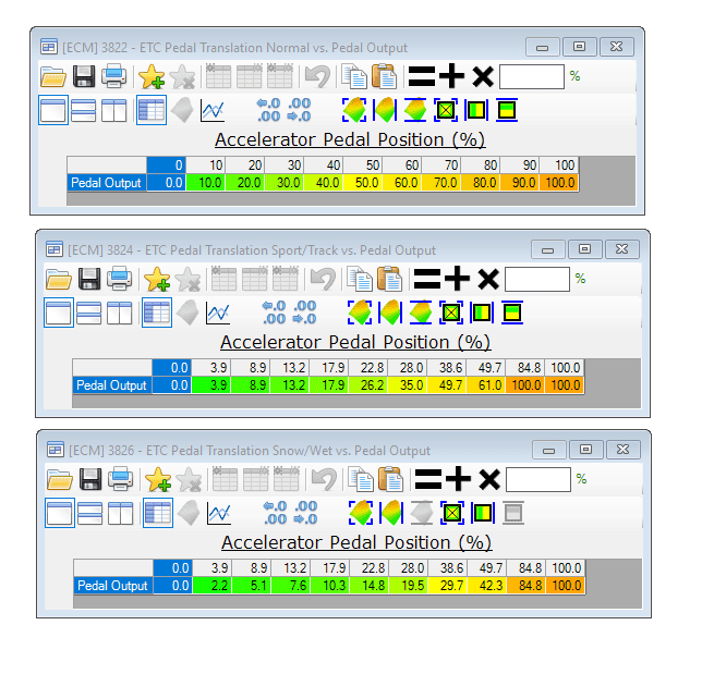

Bruh are you serious? Does sport mode add power?
NO. That was satire for the rest of the post on this forum.
You are correct when you described the pedal max as doing the same thing as sport mode. Just not exactly the same. Sport mode only effects pedal after 18% and snow/Wet mode stop effecting the pedal at 85%.
15% is pretty much where the pedal is at idle.
Pedal max effects the entire range from 0% up to 100% which could be 0% to 75% really.
My question is does the pedal max effect idle or cold start at all?
Oh yeah just coping the sport table to the normal table makes it worst than wet/snow mode unless you modify the axis when coping the table.
Attached picture to compare modes pedal vs output is the only thing the mode changes. Normal, sport, snow/wet. This effects the transmission shifts as well if you have an auto.
