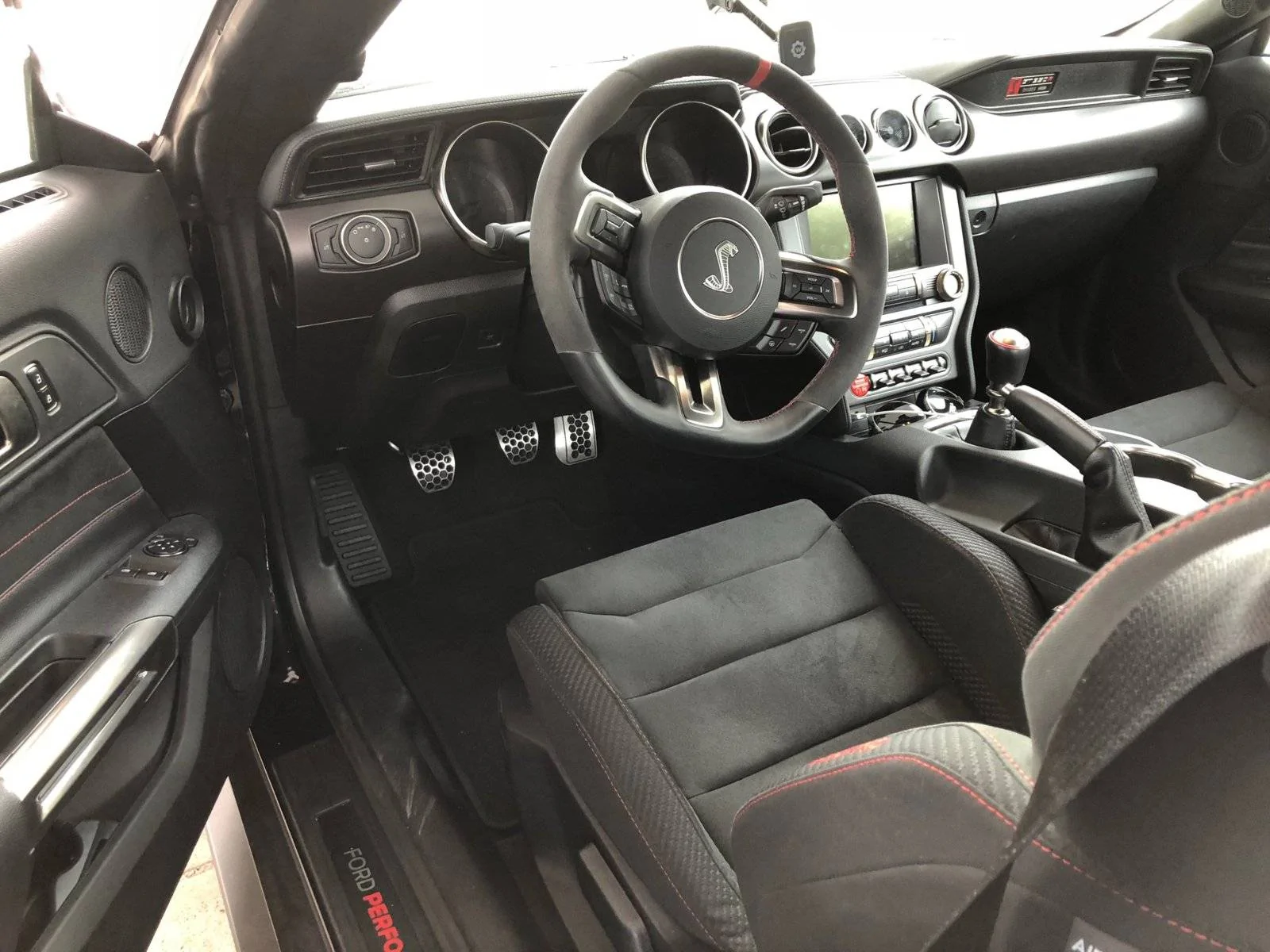

I had SRP's on my GT500 and they were the first company I went to with my GT350.
Ignore the scuff marks and dirt.

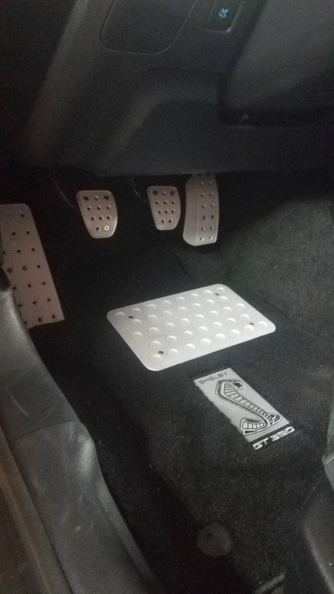

Has anyone put the SRP accelerator pedal mounted over the stock pedal? That would give it additional high as some have suggested they needed. I just ordered a set in the CS pattern in satin. I was planning to install the accelerator and dead pedal and leave the gas and clutch stock.

Didn't sound like a great idea to me either but thought I would ask. Might work for the dead pedal as I have read the hardware that it comes with doesn't work and there is a need for longer self tapping screws to attach it due to the backing under the carpet in that area. I haven't torn it up yet to look? ? The dead pedal is held in by they panel clips so attaching the new one by drilling and anchoring into the old one may be an option.....also maybe another bad idea? We will see when I go to do it?

My dead pedal overlay is drilled into my factory dead pedal. I'm not pulling these pedals back off down the line. I'll sell the car with them installed same as I did my GT500.
