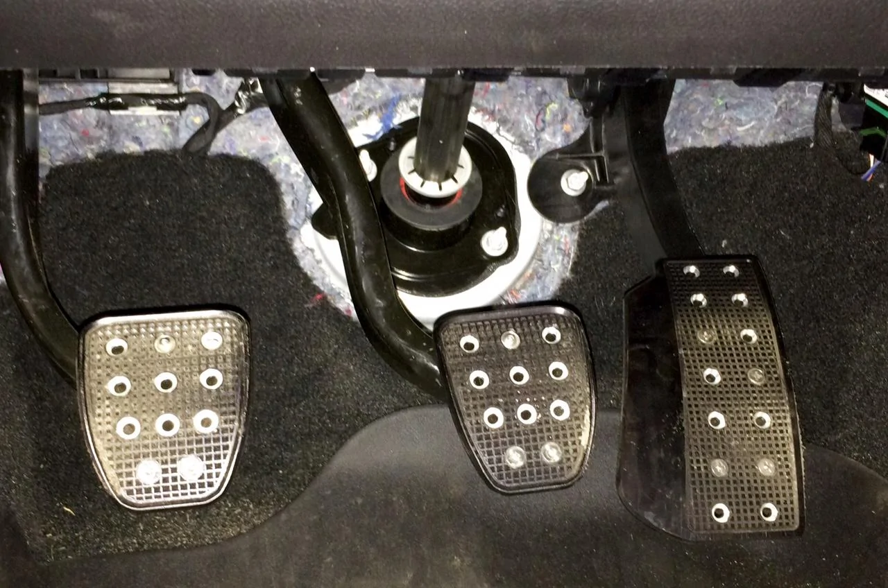

How is the installation of these and anyone got any pics they can post?
I installed the standard width set in the fall. This was my second set of these pedals, the first on a Porsche C4S and they are very wel made.
On the 350 they are a it tricky since you have to drill into brake/clutch pedaly that are not flat but flanged and you have to be careful on spacing because there is not an abundance of room.
While a bit tricky, anybody with modest DIY skills can do it and you get qualityhardware to bolt them on.
The satin natural aluminum, frankly looks like factory equipment.

Here is a shot of my dirty SRP pedal arrangement. Notice the extra width on the left side to make heel toe easier (my feet are not wide so on track and on street I found it very helpful). As another member said the clutch and brake will be drilled to install it.
