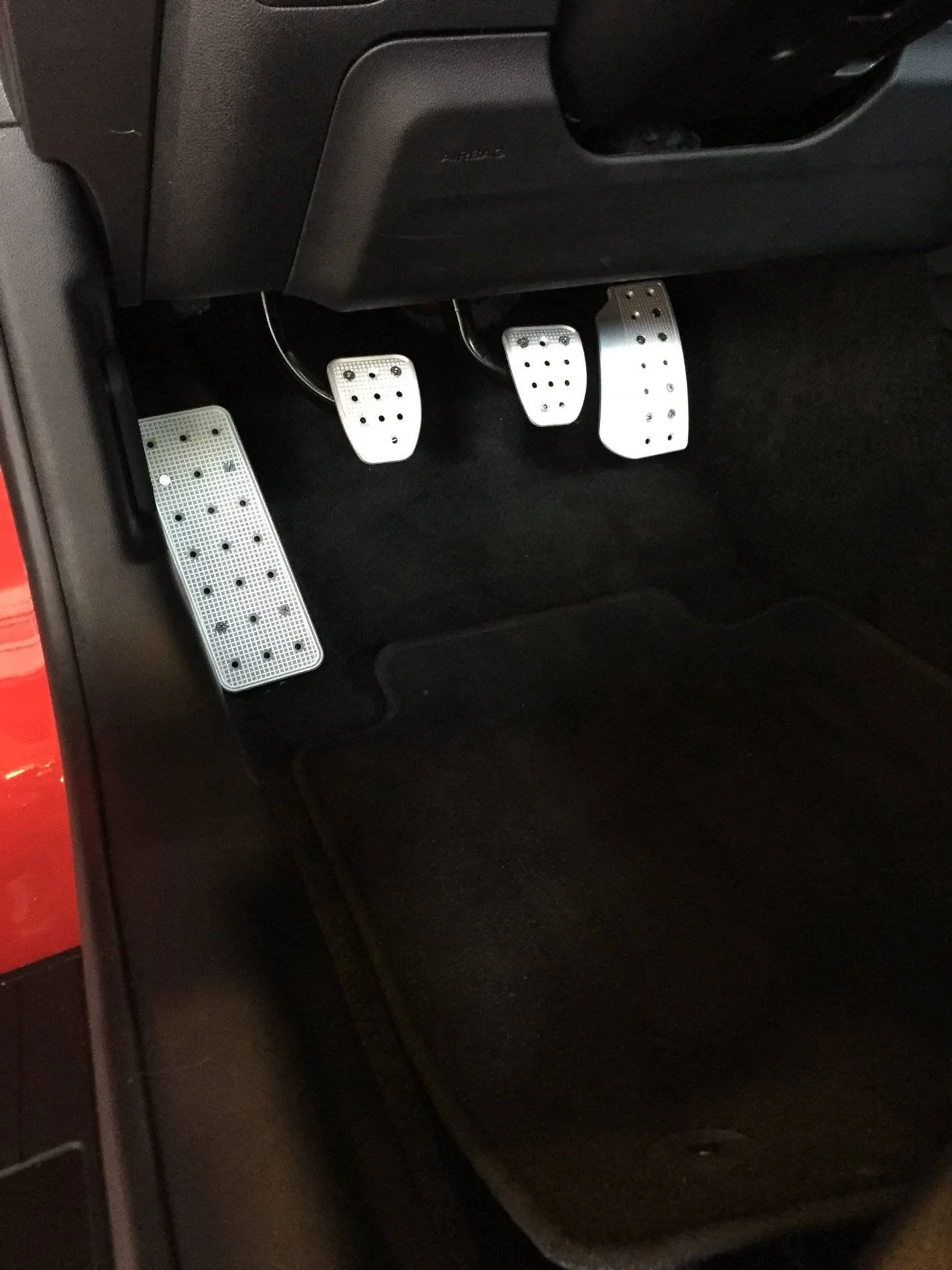

Does anyone know if there are wide gas pedals for easier heel/toe shifting?
The Steeda models say they don’t fit GT350, does it have a different pedal setup from standard mustang?
Really struggling with my down shift rev matching as it seems you have to really contort your foot to reach the brake and gas at the same time.

are you practicing it on the street or on the track? only reason i ask is because i all but gave up on the street...then at the track where you are smashing that pedal down further, it was much easier
either way those SRP pedals were on my list.

Yeah I know what you mean only 2 track days but it as a struggle the street is definitely harder. I'm hoping wider will allow me to at least practice some on the street, I have easy access to some isolated country roads.

I had the SRP medium width gas pedal on my GT350. I would almost always rev match when I was driving, unless I wanted more engine braking on the street, then I would not quite match depending on the situation. I liked those pedals and it was great being able to practice rev matching all the time. Of course in a track driving situation you have to really hammer the gas to get the engine RPM up high enough compared to street where it doesn't take as much, but I still think it was good practice being able to do it all the time.

After my first track day with the stock car I made this my first mod. I wear a size 12 and still went for the extra wide pedal. There are spacers to pull the pedal off of the floor more, but I did not want to do that. My shoe would also slip around on the stock clutch and brake pedal surface if my shoes were even slightly damp. At some tracks I was parked in the grass and was constantly wiping off my shoes from morning dew as I got in. The SRP pedals have fantastic grip.

Looks like the SRP pedals require some drilling? Is that correct?

I had the steeda gas pedal on my 15’ GT/PP and I just swapped it to my GT350

yeah i second the wide SRP pedals. Great mod, perfect for rev matching in addition better feel of the clutch pedal

Any insight about the installation of the pedals. I say one video where the installer removed the gas pedal to drill and install that pedal. I haven't really been able to find a good simple install video?
