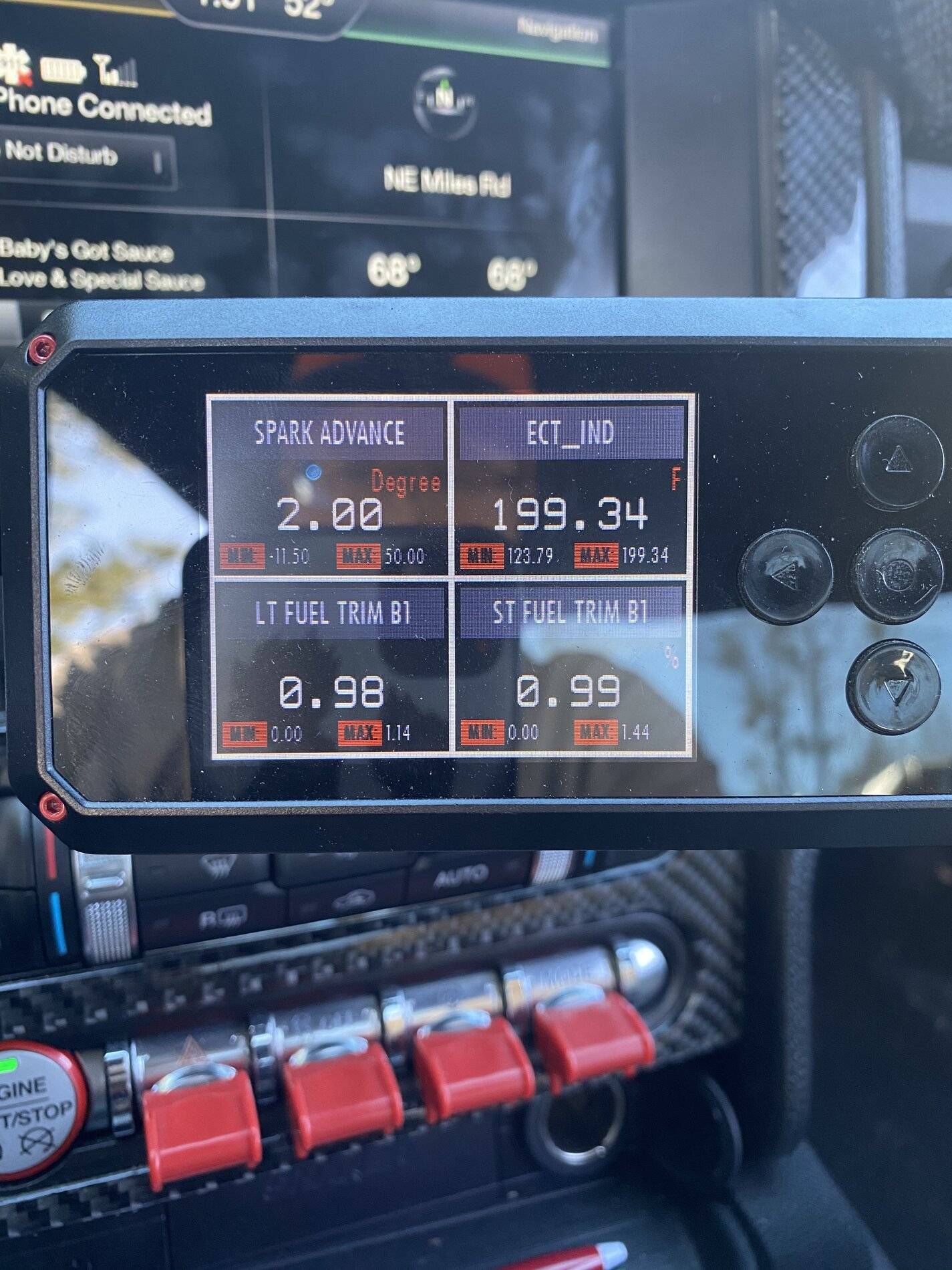

Been having an issue with the thermostat. While driving at cruise it will steadily increase until I don’t feel comfortable and will downshift and lift. During deceleration it will plummet 10-15 degrees, then as I resume it will slowly increase again. It’s the 160 thermostat, I’ve done probably 20 drive cycles to remove air over the last 2 weeks. Lower hose does not get as hot as the upper, warm though not hot. I can hold the lower and squeeze the upper and feel flow. I just replaced the thermostat now and it seems better, but still increases temperature in cruise. I think it should be way under where it is in the picture. I have pressure tested the system and it holds 21psi and didn’t drop over 30 minutes. I did test in a pan of boiling water and the new thermostat opens. Also if I’m idling and do a couple quick revs it will drop 10 degrees as well. Am I crazy?

I also have a Reisch 170 and I love it. With that said, do you think 199 ECT is hot? The default Whipple tune targets 212 ECT for the fan control, so anything under that is totally normal.

If I'm sitting at idle with the ac off no, I know it's going to warm up until the fans kick in. But with the ac on or cruising with flow through the radiator? It's hotter than the factory thermostat.

Yup, thanks guys. Without ac on or heat, ect went up to 185 then the thermostat opened, dropped to 175 and was rising which is normal. Turned on ac so the fans would come on, dropped to 175 and was very stable. Win! 😁
