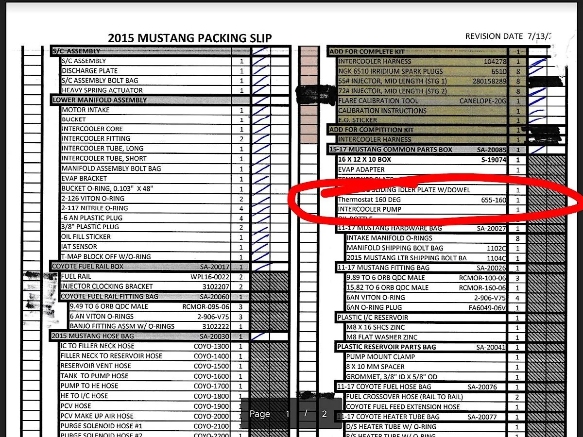

Erm...
I can’t speak for ALL kits that Whipple ship but I can absolutely assure you that my 15-17 TUNER kit came with a thermostat, DIRECTLY from Whipple. Not the vendor. It’s even on the picking slip from the Whipple factory.
It’s not a big deal, just an observation.

Erm...
It's an option on their website but NOT a part of the kit.
Nothing mentioned about a T-stat in on the whipple website for any of their kits. This would be a first. Saleen, VMP, Roush, Ford Racing, Magneson, DOB, Whipple of Yesteryear, Vortech, Paxton, Procharger....none of these MFGR's including Whipple in the past have included a T-stat. I've only had four FI setups and researched 99% of the options at one time or another and NEVER seen where the MFGR offered such an item in their kit. However that is not to say that the distributor didn't and many will. However assuming you are right and they do though their current website says nothing about it in any available kit (and that would be a value added item to mention as a marketing ploy) the T-stat would still be "THE RIGHT PART FOR THE JOB". It may not be the most efficient option available but it is still the right part for the job. Plenty of PD packages come with undersized H.E's. Doesn't make them the wrong part for the job, it only makes them less efficient than a larger volume H.E option.
Here’s a packing slip from Whipple, not the vendor.
I agree that it’s “functional”. But given that in this case it was a tuner kit, I’d say it wasn’t optimal.
Whatever.

On Whipple's website the item is listed as an accessory. It is not a standard part of any kit Whipple sells. They don't mention anything about a T-stat in the packages listed on the website, only in the accessories section under misc. Here is the link.
https://whipplesuperchargers.com/index.php?dispatch=categories.view&category_id=274
Show me on the Whipple website where the package you purchased mentions or lists anything about a T-stat being included.
I will admit I am wrong and have done so in the past. If Whipple is making this a standard part of their package they would be a first and they sure aren't mentioning it in any of their packages listed on their website........only as a misc. accessory not even considered a spare part.
Steeda, Lethal, Brenspeed, Teambeefcakeracing, and PalmBeachDyno all show nothing listed in their description on any standard package of Whipple's they sell (nor does whipple's official site) indicating that a T-stat is standard equipment. It is an optional device selectable at buyer choosing (like choosing navigation on your premium rather than simply ordering the GT premium package in it's standard form). Who you bought it from either asked you if you wanted it and you said yes, or selected it for you because they choose to add t he option on every kit they sell.
Once again in your reply you state and I quote, "That’s VERY interesting. I just assumed (like a fool) that they would supply the right part for the job." This is a far cry from optimal v functional. Whoever decided to add the part to the kit or for that matter even if I am wrong and the kit came standard with the T-stat (though there is more evidence to indicate it didn't than did) the part IS NOT THE WRONG PART AS YOU FALSELY INDICATE. That is a misreprentation of the truth. There may be better options as have been stated, but one part being better than another does not make either part the wrong part, it simply makes one a better choice over the other.
As for your question on the 170 Reische, yes it may be used in place of the 160, however the fan strategies may not be optimized for it.
