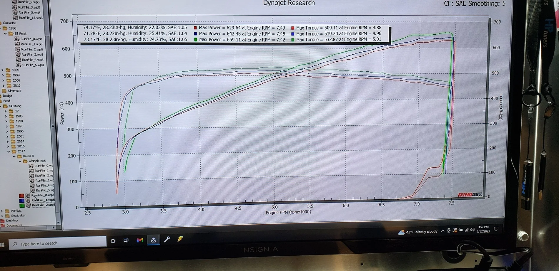

Morning all, was wondering if anyone knows if it's safe to run a 3.750 pulley with stock balancer size without doing any other mods besides a stage 2 Whipple kit? Having a problem with belt slippage and being out of adjustment with the belt that came with kit so going to upgrade to a grip tech so if I can get away with a little more boost why not right.
So on my conservative 93 octane (no additives) 16.5 timing tune and revving to less than 7,500 rpm car made this with a 3.75, 3.625, and 3.5 pulley.
This is with Kooks 1 7/8, GESI HO Green Cats, and AWE touring catback.
2.9 whipple 11:1 compression gen 2 aluminator.
