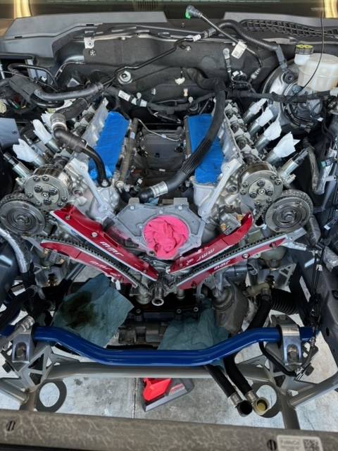

Really hoping it's not wrong as well, but unfortunately, there's only one way to know. I just did the same procedure after installing new OPGs, CS Timing Gear and a host of other parts. While not a terribly difficult procedure, it's not difficult to have the cam gears off just enough to be off by half a link and thanks to the awkward viewing angle, it would be hard to see.

Think i will go through coils and spark plugs and make sure it's not something stupid like that first. If that doesn't work, I will tear it down again i guess. Just sucks after getting everything done and putting whipple on. Besides coils and plugs there isn't really anything besides timing that would cause a misfire correct?

Lund got back to me and said my timing looks correct. Time to start chasing this thing down.. does anyone know what spark plugs came in the stage 2 whipple kit?
