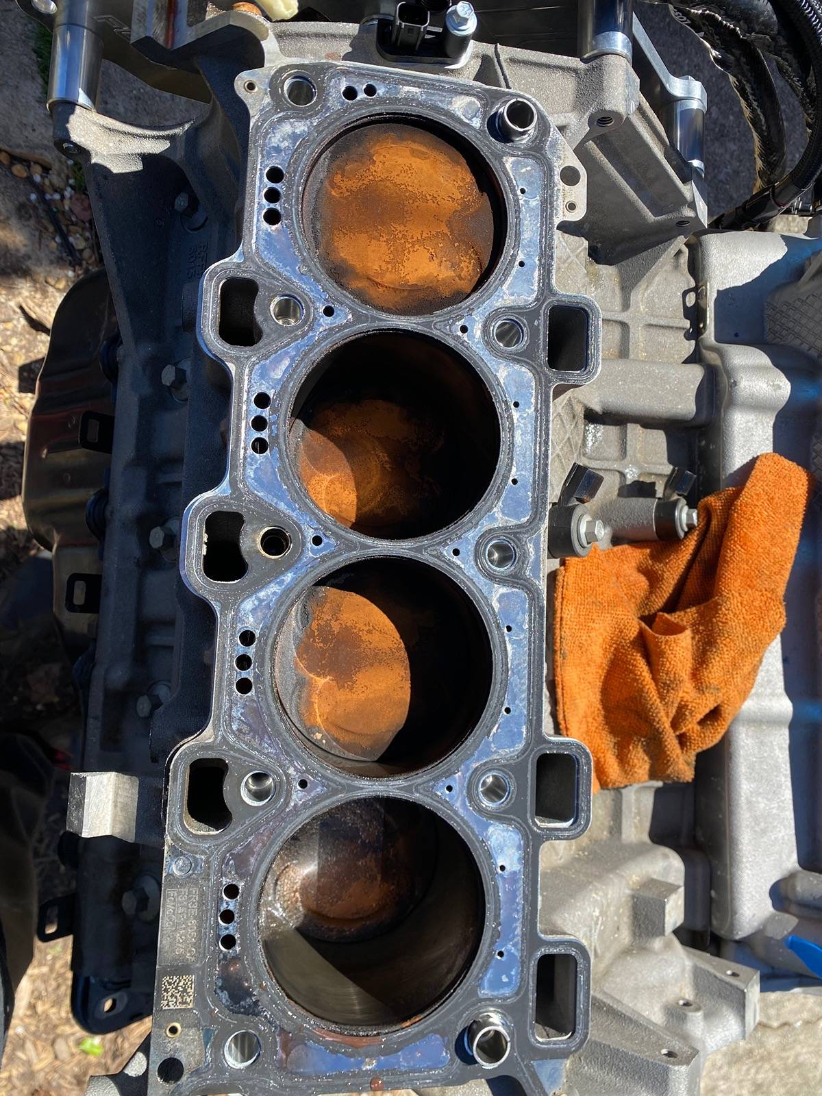

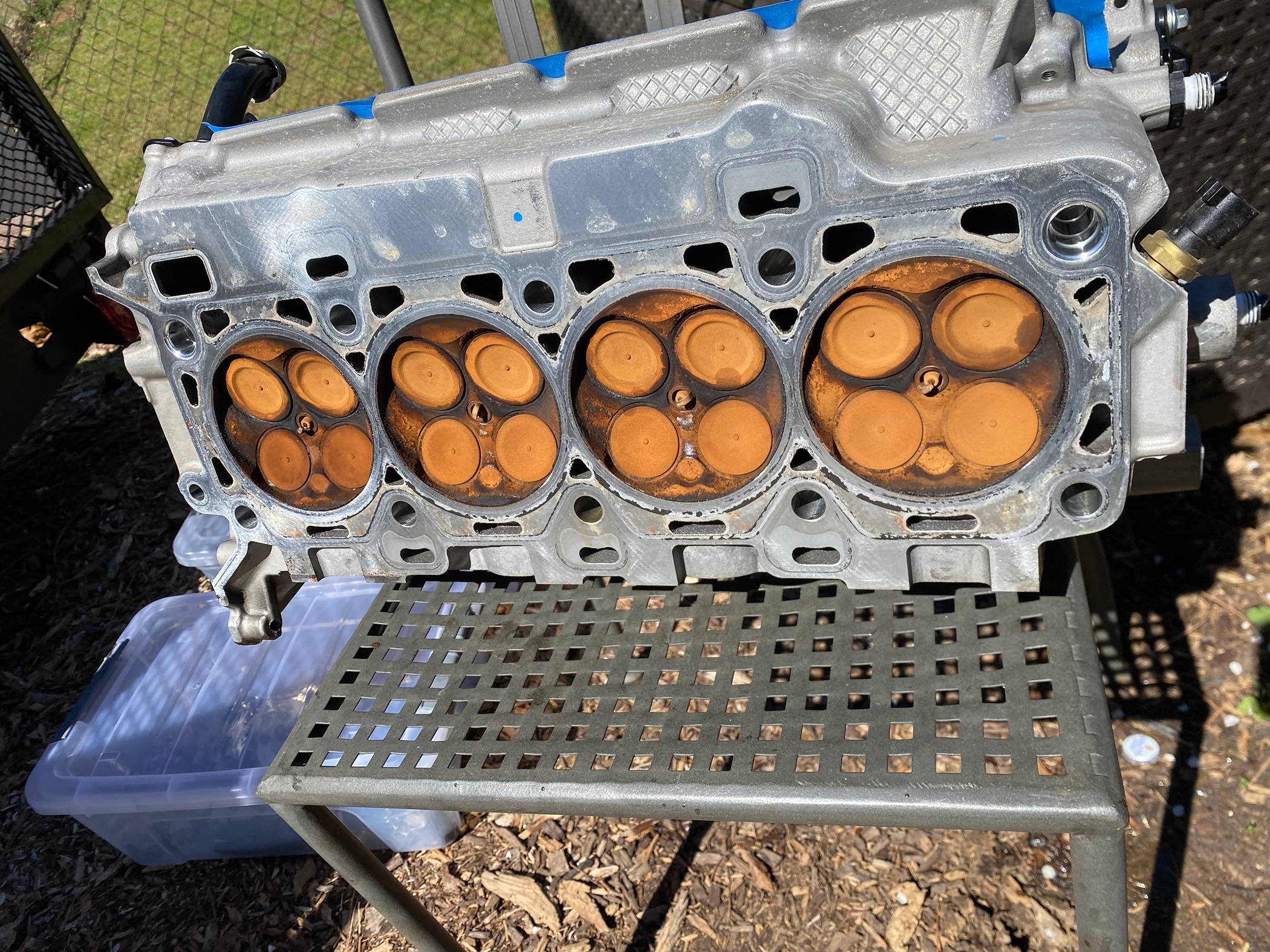

Here are some images after removing the head, car was over diluted with boostane over maybe 2 weeks
54k miles
54k miles
Boostane caused all that surface rust?!?
Was there any coolant residue in/near the cylinders? A “simple” answer here might be boost pissed off the headgasket. Minimal, minimal coolant got into the combustion chambers and wam bam misfire codes.
The head gasket seemed fine, the car was never overheated and never smoked from exhaust. Coolant levels never dropped either. The orange coat is the lead or whatever from the octane booster being burned, it all wiped off clean with fuel system cleaner. There was a lot of it though from it being over diluted in the tank
Awesome, glad it’s not/doesn’t seem to be that. I honestly can’t offer much more than that. A tuner that can pull/read live data might be able to help you out with the misfire. Hopefully it’s all ignition related.
