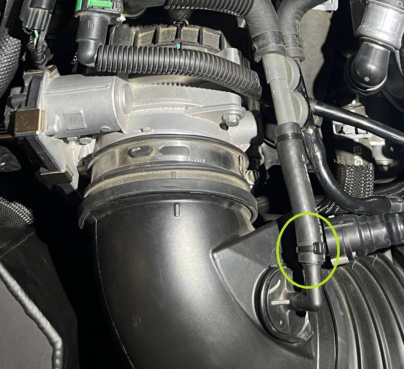

I was getting Misfire on Cylinder P0301 on E-85.
Sent a cold start data log to the tuner, he could see fuel trims moving around. Check for Vacuum leak. I had a loose-fitting vacuum line that could have been a potential leak. So far so good.
