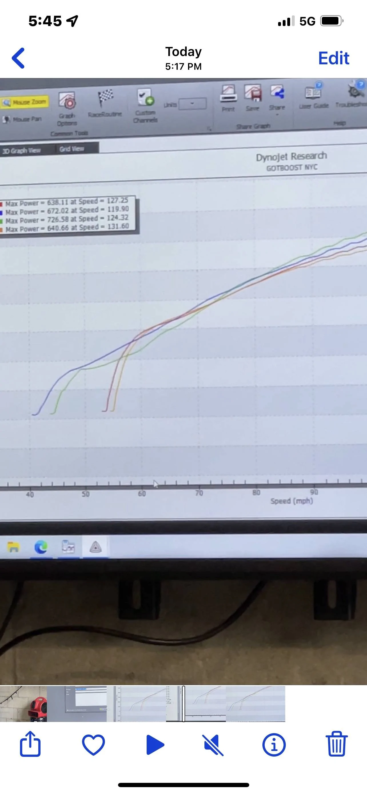

I have a 21 10R80 Mach 1. Whipple Stage 2 6 rib oversized heat exchanger. Only mod when originally dyno was a steeda h pipe everything else stock and we had a high of 670whp on whipple tune. 93 pump gas and the 3.875 pulley. Just installed kooks 1 7/8 green catted headers everything else the same and dyno was high of 726whp. This was 6th gear pull not sure the original gear pull same whipple tune
Thanks for the dyno and feedback
